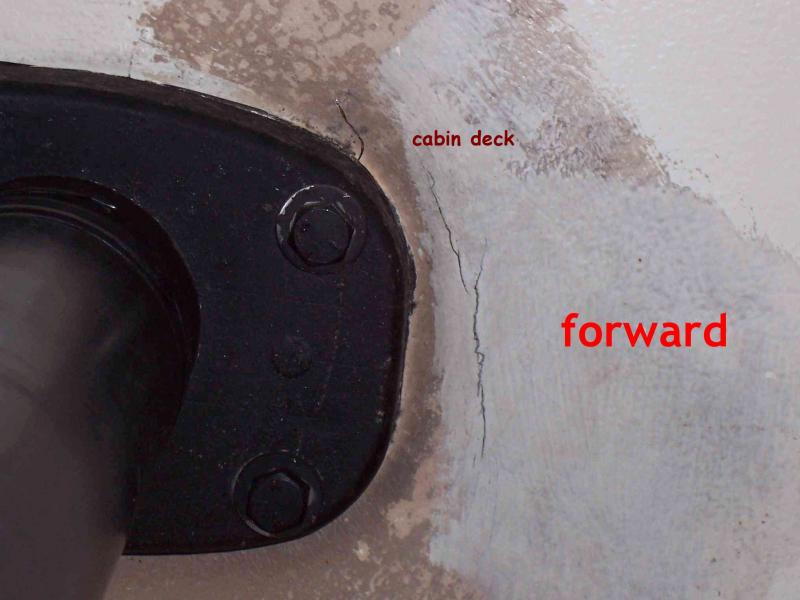

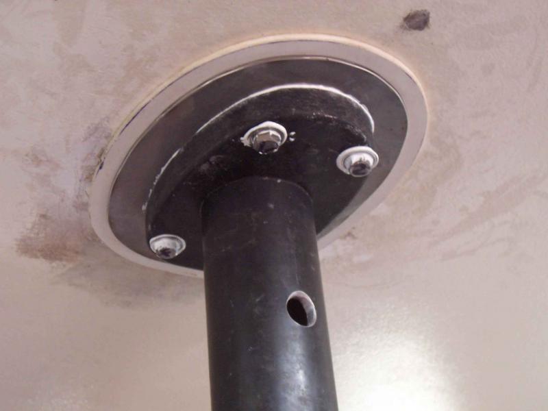

We had already comitted to taking the mast down, to inspect the deck around the cast aluminum "step"
We had noticed a crack in the headliner, just fwd of the comp. post (see pics)

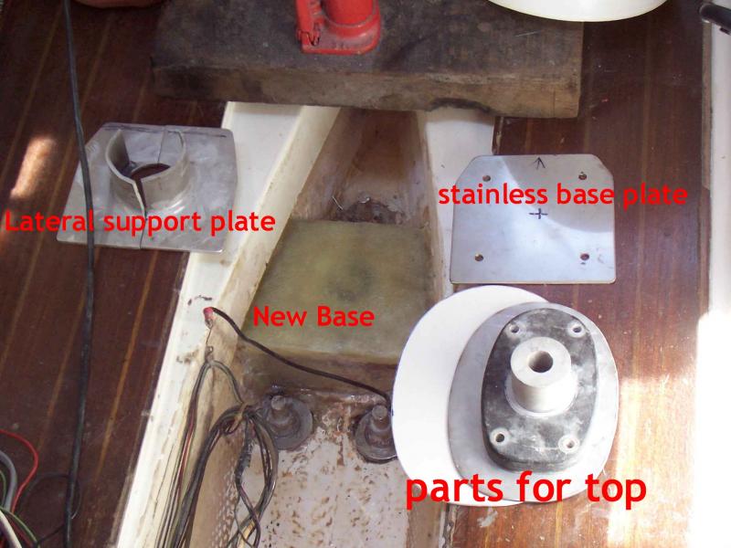

We also noticed the compression post had also corroded at the base in the bilge
took off mast to change shrouds & rewire mast, so we also cut off a large patch of the deck skin around the cast aluminum base, lifted and inspected, found no evidence of rot, closed and re-glassed.
Inside we rebuilt the bilge support with new parts - see pix
super strong again, no cracks and solid as a could be
new shrouds from Sailing Services outta miami are totally sweet, and new wiring, antenna, single connection vhf wiring from antenna, etc...nice improvements
