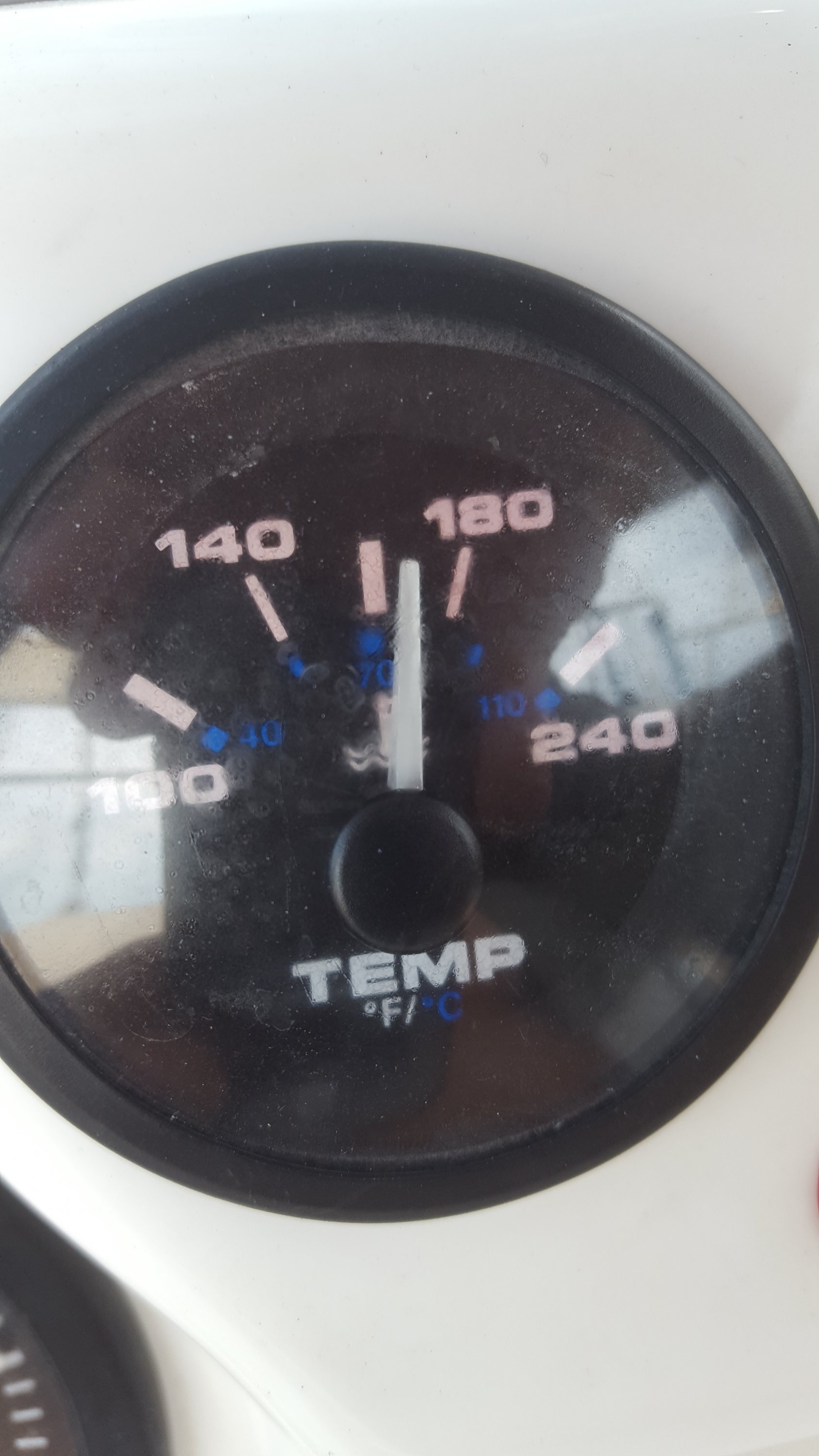

My 2004 C310 Universal M25XPB temp climbs to 200+, takes about 20 minutes. R&Rd thermostat, coolant level OK, raw water screen and HX seem ok, Sherwood impeller OK, raw water output starboard aft seems OK but not alot. The only thing left is engine water pump. Is there a way to check that? Thank you!

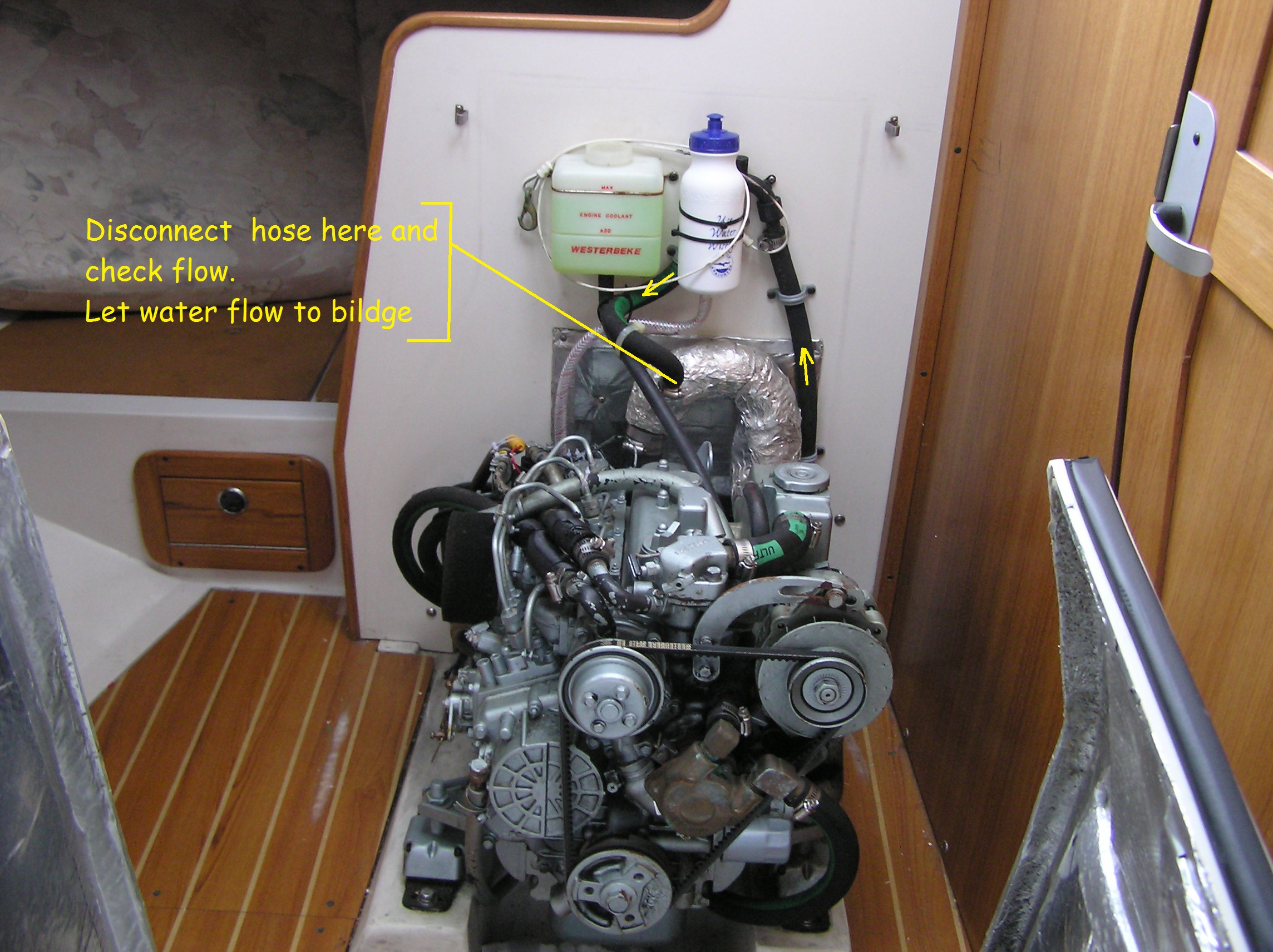

@paulj - is that the engine in your boat? I had no idea engine access was that easy in any boat around 31 feet.

Yes it is pretty well laid out. I will use that hose for flow check. I need to learn more about exactly how the raw water /manifold work together and how to remove the elbow. Just disconnect from manifold & exhaust hose output?
Yes....will not take long for an answer. The water will start flowing as soon as engine is running.

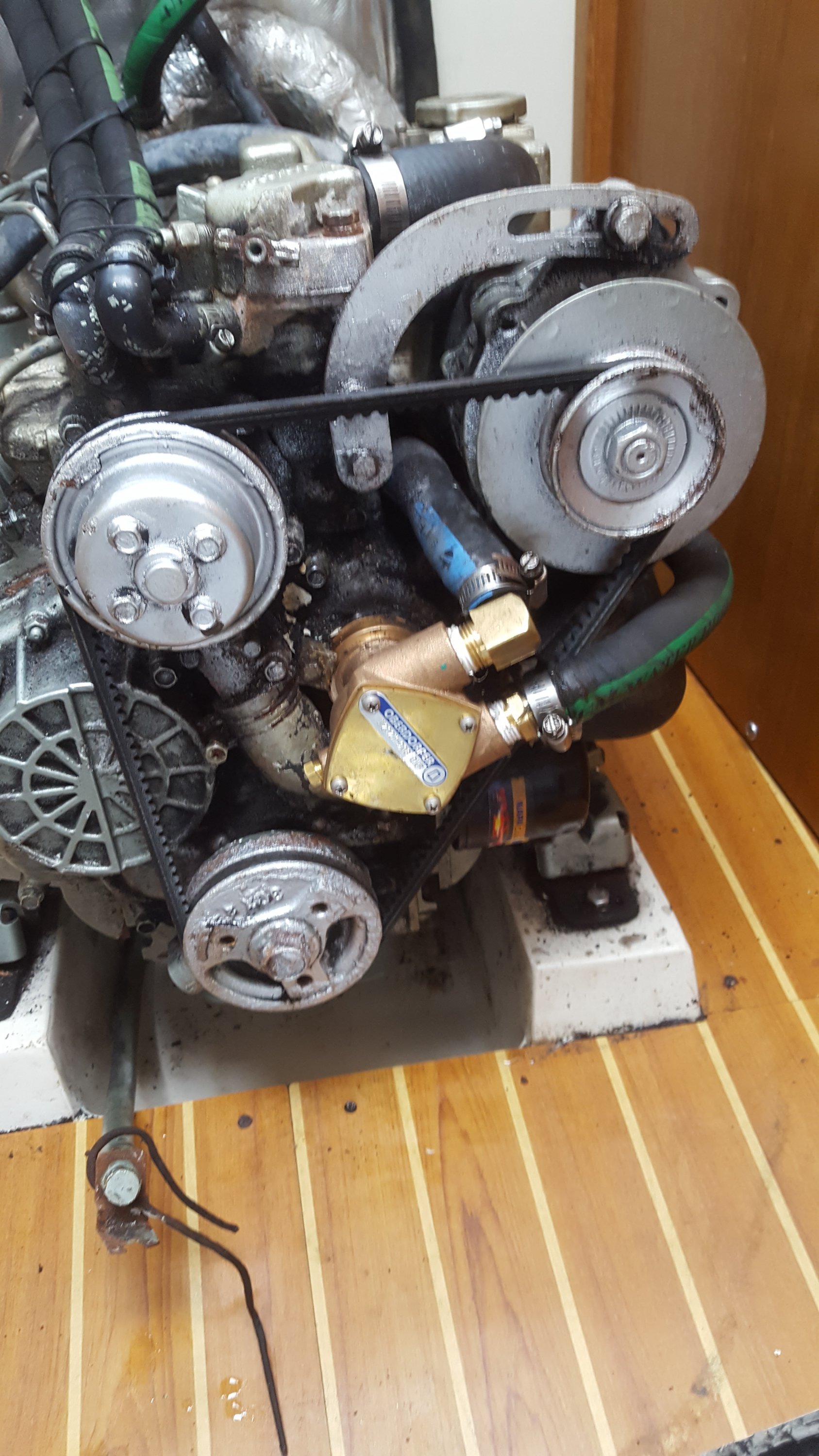

So I finally got some boat time & put everyone's thoughts to the test. Pulled the hose off the exhaust elbow... no raw water! Removed Sherwood pump...gears inop. Replaced with Oberdorfer...runs like a champ, 165 degrees, 15 degrees cooler than before she started overheating.
Many thanks to all for sharing your experiences & ideas!
