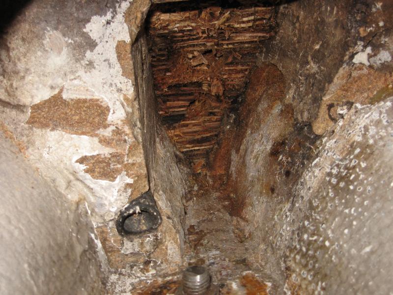

I am wondering about a really wacky idea for repair of the compression block in the bilge.
As a structural engineer I specify a 5000 psi non-metallic concrete grout to support steel and concrete columns in buildings. The stuff is mixed to a consistency just a bit thicker than water and poured into place. After a couple of days it has over 5000 psi compressions strength.
So I am wondering, couldn’t you just remove the rotted wood, create a template to damn off the area for the compression post and pour in the grout?

I don't see why not. I have heard of some of the old Endeavor boats having their mast steps replaced by concrete blocks.

The compression block that Catalina put in was not adjustable, no moving 1/8" in any direction. Also it was surrounded with a material that looked like it was poured in like concrete. Not sure what the stuff was but it took a cro-bar and hammer to break up and remove. I installed a screw jack similar to the design dj2210 put on this thread with some modifications. Very easy to install once the original compression block was removed, and I completed the work without taking the mast down.

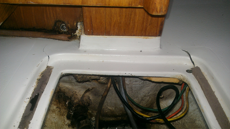

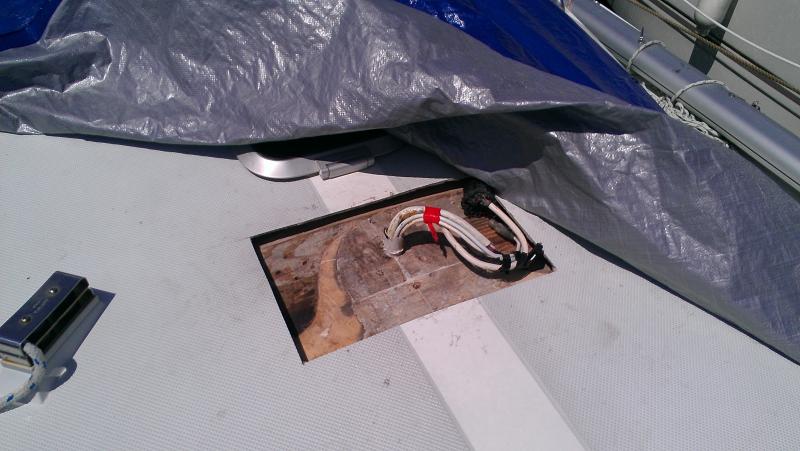

As anyone out there with a mark 3 had issues with the compression block? I have heard about it with older models but not so much with the mkiii. I noticed my head door not latching and later cracks in the cabin sole. Pulled the mast and everything went back. I have ordered a new wooden block from Catalina and about to start digging. Anyone else done this? Any advice?
We HAD a 2003 C30 MKiii that we bought from original owner in 2005. :cry: Got a leak around stbd port just aft of bulkhead. Thinking it needed re-bedding, I removed the port and found it wet. Left to dry "a couple days" and it was still wet after a week. Long story short, found cracks in cabin sole and it turns out a leak had developed where in-mast wiring penetrated deck, and had completely rotted the compression block and saturated much of the balsa. Had to cut away about half of cabin sole to replace. The guy who did the work said the original construction was incredibly shabby. Talked with Frank Butler (then president of Catalina Yachts) personally and he took ZERO responsibility even though the boat was within the 5-year hull warranty period (because I wasn't original owner). Frank ended up cussing me out and telling me he "felt sorry for my wife" before hanging up on me. After the repair work was completed (for +$5K) the compression block/leak were no longer problems. We sold the boat a couple years later and WILL NEVER BUY ANOTHER CATALINA. Boats tend to have issues sometimes, and that's understandable - especially when they live continuously in the saltwater in the Pacific Northwest. I understand and accept that. What I find unacceptable is the response I got when I contacted Frank Butler, and that is enough for me to say "enough" to Catalina Yachts. Good luck. Hope your repairs go well, but don't count on Catalina for help or to stand behind their product.

I replaced the compression block in my '86 C30 MKII with 3/4" sheets of phenolic laminated together in place with West Systems Six10 epoxy adhesive. I didn't remove the entire block, just took it a couple of inches past the compression post. The remainder of the wood block was still solid at that point. My bilge always has a little water in it and the new block is doing fine three years later.
