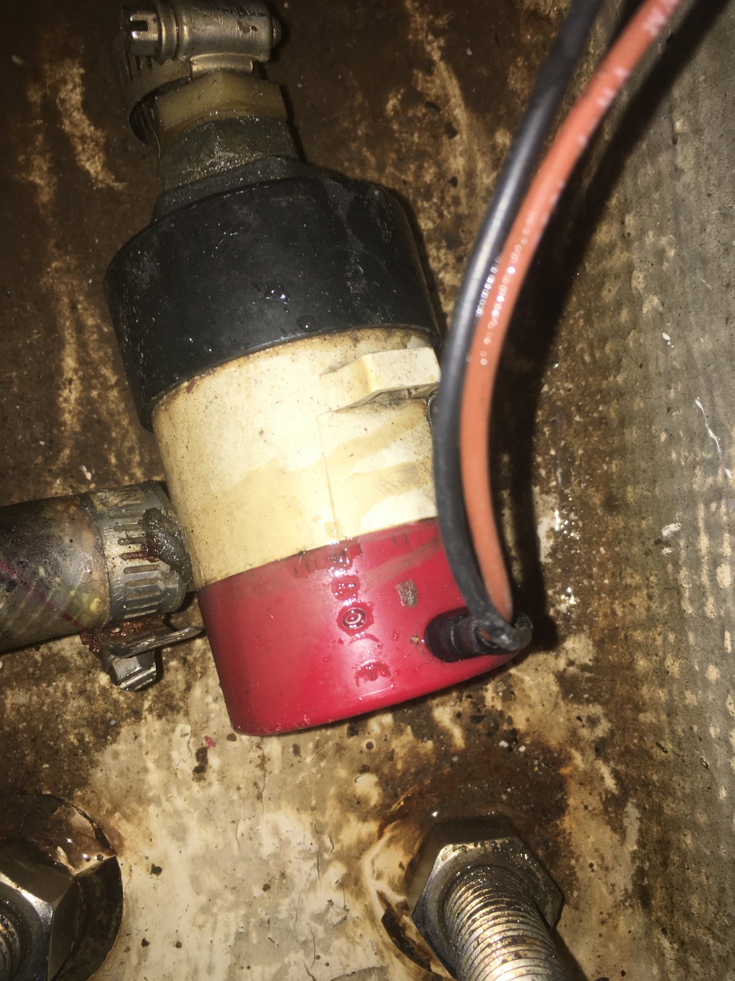

I just replaced my shower pump. No idea if this was a mod from the PO or something normal, but I have a closed loop bait type pump that sucks the shower water out back into a hose that dumps into to the head sink.

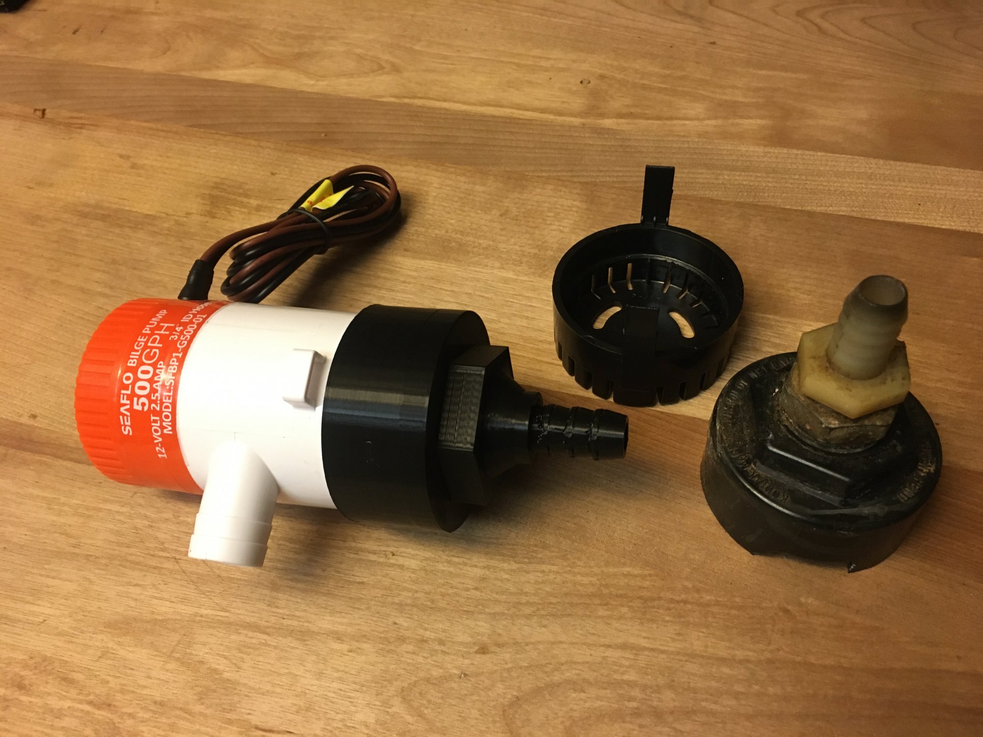

The original pump was a modified standard Rule binge pump with a cover glued over the intake with a barb fitting. The company that made it was Kodiak Marine. I couldn’t find a direct replacement, so i bought a standard $20 bilge pump and 3D printed my own intake adapter and glued it on.
here’s the original setup:
I have a switch in the head to turn it on and off. You just have to be careful not to leave it on.
If you go with a version of the shower box solution, you can use a float switch to make sure it doesn’t stay on by accident. That’s the only drawback I have. Been thinking of installing a light indicator to help but never got around to it.
