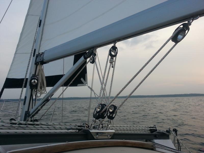

To the other question, here's a pic of the main sheeting system I ended up with after contemplating whether I should replicate the C309 sheeting on my C30.
