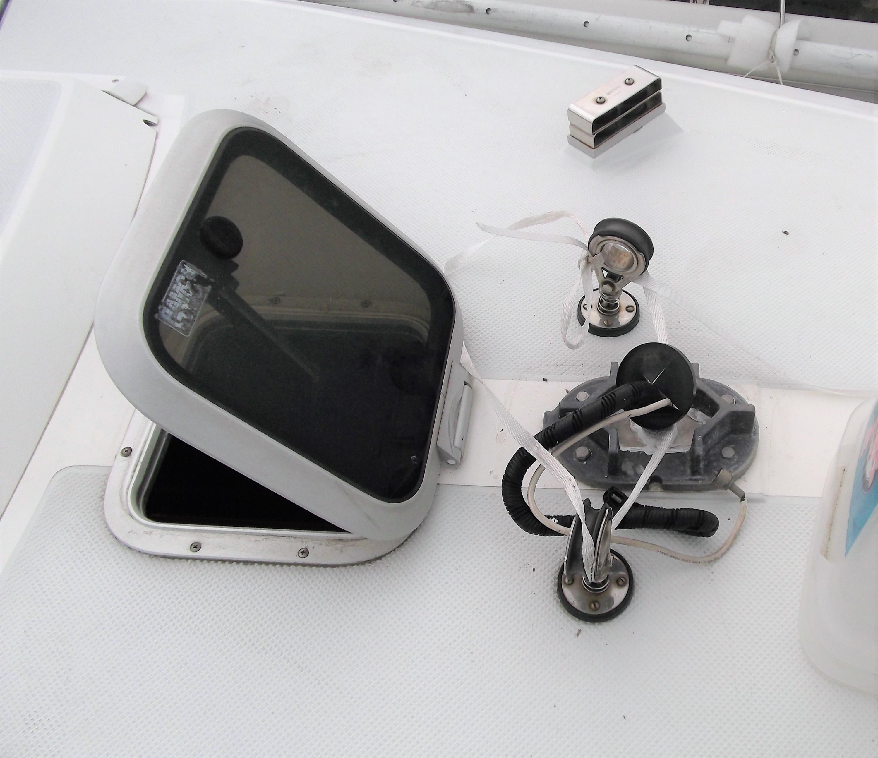

The MKIII has two sets of fixed multi blocks at each side of the mast but IMO should have been located a bit more aft. The line from the block at the base must make a very sharp (almost) backward) angle to go thru them and then run back to the winch.
Also can anyone tell me what are the two single (spring mounted) blocks at each side of the mast for?

After doing some more research I believe the two spring loaded blocks probably were added by the previous owner and used with the spinnaker which came with the boat. There are also two fixed multi blocks (only one showing in the photo). They work fine with the in-mast halyards but IMO make a very sharp angle for the mainsheet.
24,813
Axel, The blocks you imaged look more for halyards then mainsheet. Can you take a picture of the cockpit, the transom and of the coach roof?
