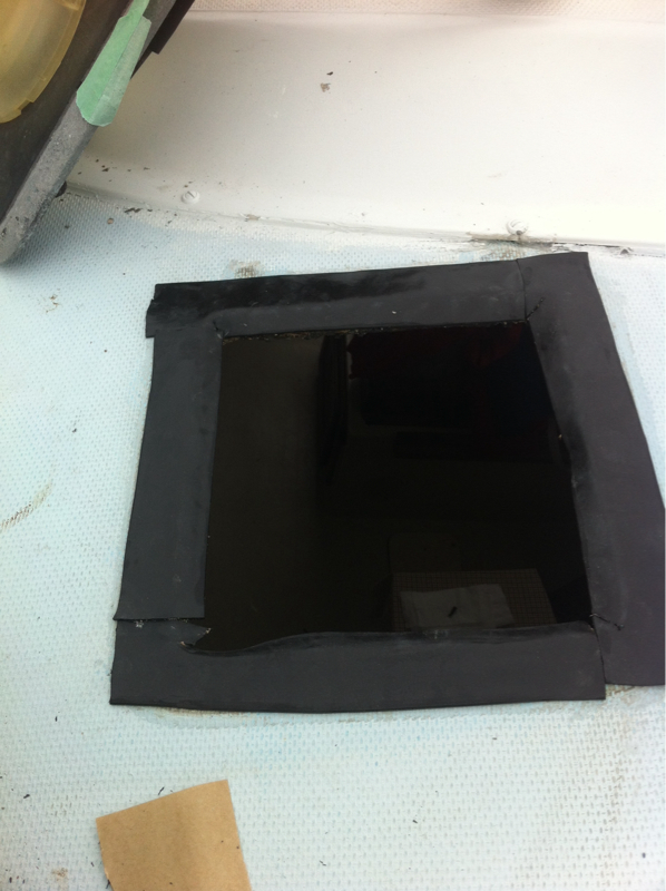

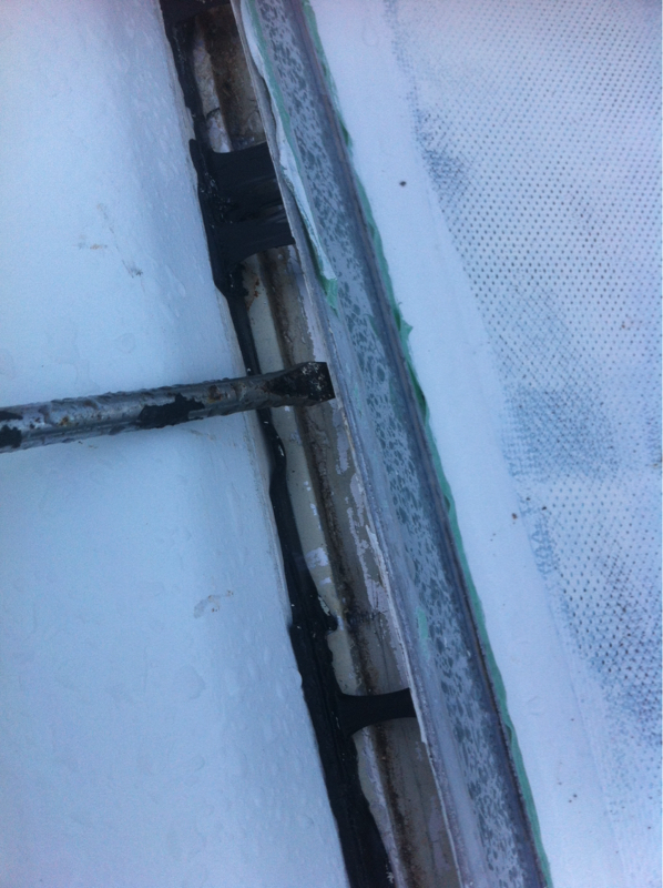

You have a lot more experience with these than I do but butyl tape is the answer for the frame to fiberglass joint.
Not all butyl tape is equal. Different makes have different levels of vulcanization/ tackiness. I myself am using and extremely sticky and elastic version of it. Very similar to tar in some ways. We use it to seal cable splice closures that are destine to be submerged for years at a time. It is labeled non reenterable.
In the second photo you can see it grabbing onto a frame I had yet to fasten down.
Hope this helps.

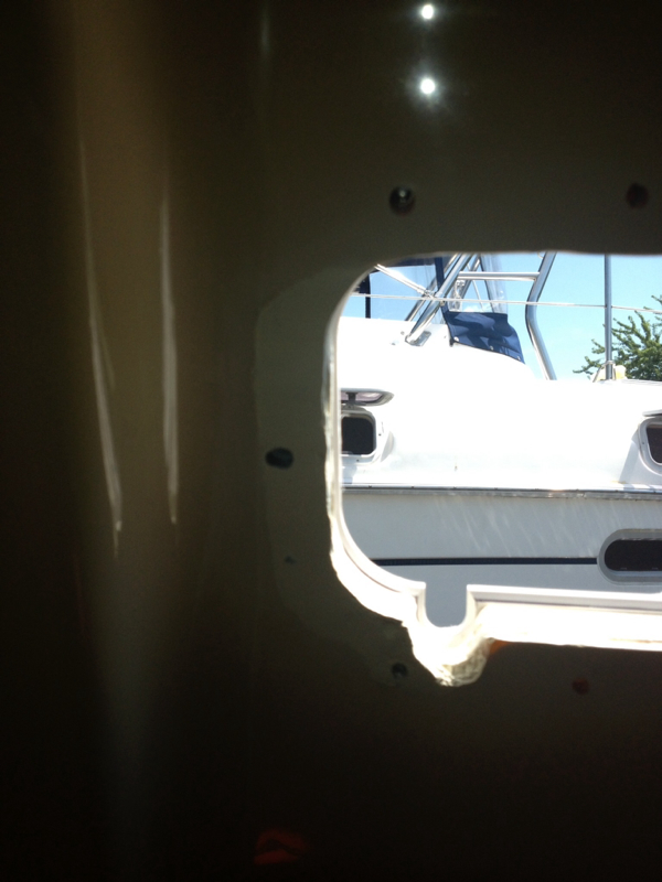

I too changed my 2 small portals to opening ones. On the STBD side, it was a caulking nightmare. The rear of the frame had a 1/4"+ gap when set in-place. I used butyl rubber to take up the space, and they are sealed, however the flange sticking out from the cabin side looks sh**ty.
But, the other portals, I have 4 out of 6 leaking, some very small, others not so much. I've cleaned, re-bedded etc. but after a year they are leaking. I cannot believe this "designed-to-fail" product was approved by an engineer(?). Another problem is the painting I did on the portal frames. I really don't want to pry them off & screw up my paint job.
Looking at the rubber seal between the glass & exterior frame, the gasket looks crystalized. So, I will use a utility blade and cut this away. I will recess down the old rubber to leave a pocket for caulking. I hope this will do the trick. The frames caulked to the fiberglass seem to be fine. 3M makes a great construction that I used when re-bedding all the thru-deck fittings when painting.
However, going back to my orig. complaint, the very bad cut openings were a problem too. One portal opening had only 1/8" of contact on both vertical sides. Also I was very disappointed there was NO coring at any openings. I redid my mast step 2 years ago. When I pulled the fiberglass off, I was shocked at the POOR coring job here also. 1980 was not a time of quality control in boat making.
