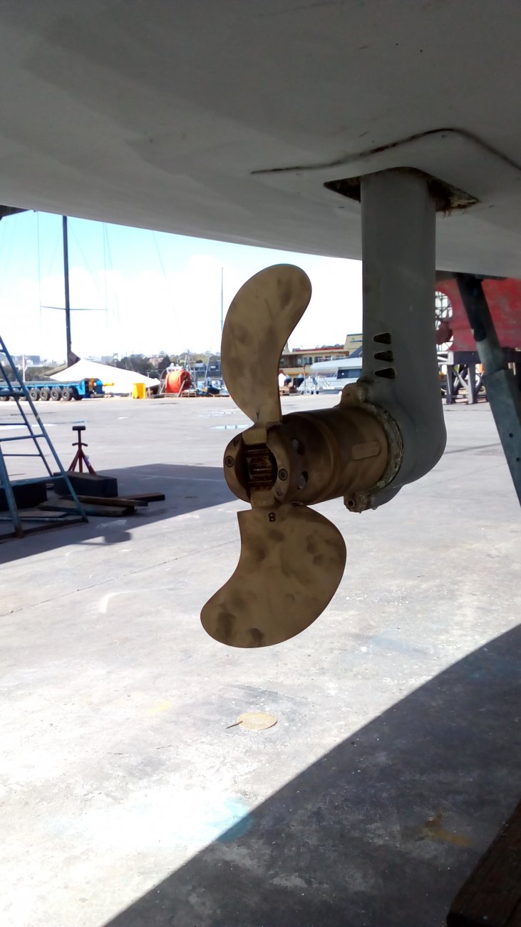

Sapphire went back in the water on Saturday (post annual haul out) with her Volvo Penta 2 blade folding blades bent from 15x10 to an increased 15x11 pitch. There was an immediate noticeable improvement, even at low revs reversing out of the wet birth. Previously getting 6.3-6.4 knots at 3800rpm/full throttle... she now does 6.5knots at 3400rpm and 7.2knots (wake just starting to separate) at 3700rpm/full throttle. She just feels lighter now under power in a lumpy sea-state.
So for $300AUD spent I'll get around a bit quicker, will have something in reserve if caught on a lee shore + will hopefully de-risk glazed bores to some extent longer term. No doubt the fresh hard coat of sprayed antifoul helped the cause on Saturday but truth be told I was diving the boat quite regularly to wipe and keep it relatively clean beforehand - so this was definitely the result I was after. Happy Days.
