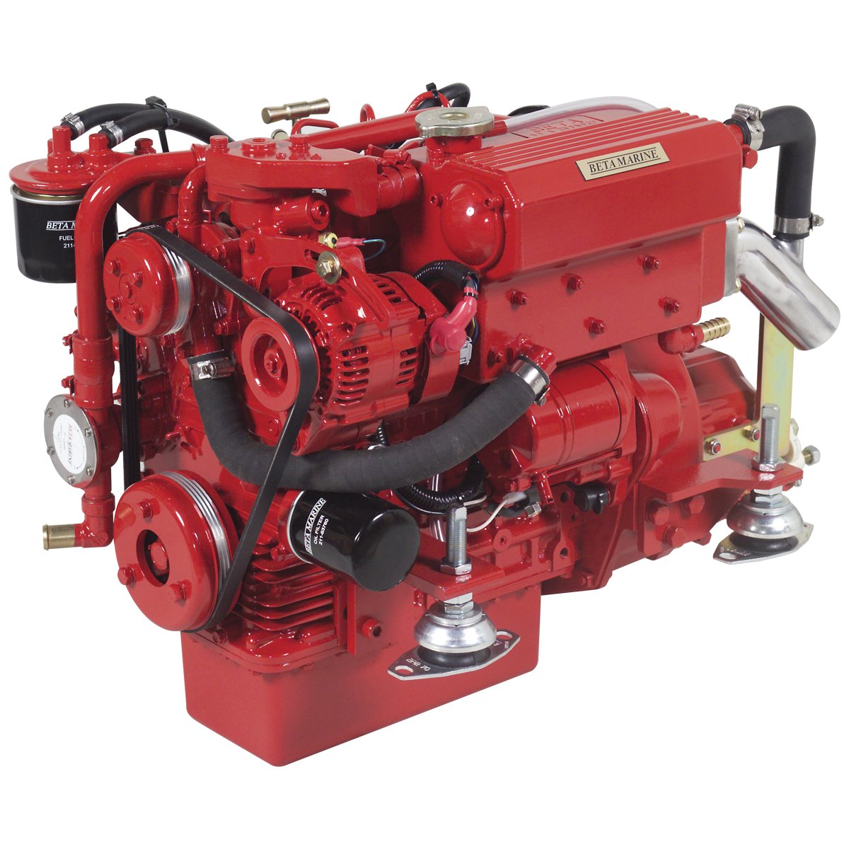

As for replacements, Nanni and Beta are based on the same Kubota block. Nanni is a nice blue and Beta is red. Nannis seem to be more available than Betas.

A BETA would work as a replacement for the Atomic 4 Gas engine often used in the C&C 39.
You do have 17,000 displacement. While a 40HP can work, you might find it a bit underpowered when it comes to a swift tidal current in the Pacific NW. I say that because you have identified Everett as your home port.
BETA is a good engine. The BETA 25 is listed as an Atomic 4 replacement.
When I was looking at them, I thought the BETA 50 (45Hp) would make a good match for my 35ft 16,000 displacement boat.
