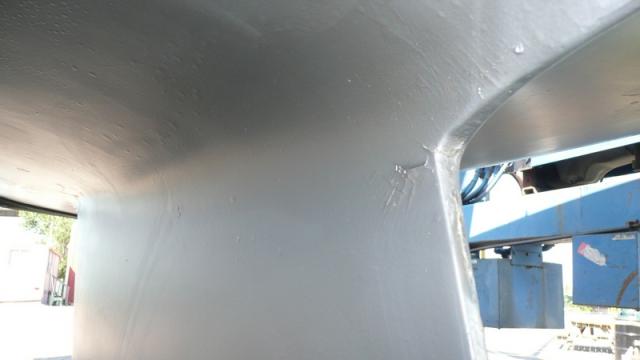

Hi, Im considering purchasing a 1981 34' C&C yacht. I hade a look at it out of the water and its got a joint running along the keel. Mostly one side of it. I know the owners liked to race it so that may be afactor.
The surveyor said its cosmetic.
Should i be worried about anything.
Is there a way to fix this so it lasts.
How serious is this is my main question.
From the inside the bolts look good, no cracking on the inside of hull around them.
I greatly appreciate your comments.
Alec

I had a 1971 C&C 27 for 26 years and every spring I would dig out loose caulking (usually marine tex) and refill the crack. Never leaked and never got any worse. I wouldn't be concerned unless I saw evidence of leakage.

Our 1991 P42 keel stub joint still has no sign of cracks, chips, smiles, loose joint compound, etc. Our previous 1989 H28 was the same way. Whether a boat is raced or not should not be a factor.

I wouldnt worry about it. just walk around the boatyard
in the spring and watch many of the boaters recaulk their joints

If this boat had been grounded with any serious forward motion then the keel stub could torque and force the rear of the stub upward fracturing the supporting fiberglass floors and hull. This situation can result in a catastrophic failure causing the keel to became detatched and putting the vessel in some serious jeopardy. It may well be only cosmetic, but be very sure.
I had this idenical scenario occur while merely piddling around in a mooring field looking for a mooring and the repairs were very expensive and took weeks.
Good luck, Dave

A couple of BIG IF's
If your surveyor is sure it is only cosmetic, and If your surveyor knows his business, then fill and fair the crack and go about sailing the boat. But I would make sure that the surveyor is familiar with these boats, and knows his stuff.

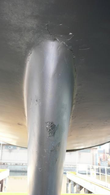

Having had a C&C, the condition in picture 1 is not the C&C smile. It looks to me that the keel sump is compromised. Causes could be anywhere from flexing to a upward force from a grounding. Potentially very expensive to fix. Drop keel, inspect underside of sump, grind interior of sump back, re glass and reinforce. Grind exterior of sump and hull back, re glass. Oh, did I mention that you might need to remove a bulkhead to get to the interior or just maybe a stringer or two.
I am not sure the surveyor is doing due diligence here. Remove floorboards and check for small cracks near mast step, condition my also show up in stringers. The picture shows a bulging area. Might just be camera distortion. If area is bulging then could be another sign of damage. Good way to tell is too grind back surface area in region of cracks. If fiberglass has white streaks in it, it is fractured. If that is the case, it could be more than you bargained for.

From the picture this looks like more than a standard 5200 seam job. I`d be worried about
the crack further foreward of the seam. Hard grounding might be the cause

I think you should get a second opinion to look at it in person.
Ask the seller to pay to have a second opinion of your choice or good bye.
Also make a lower offer if it proves to be a minor repair.

In his book "The Nature of Boats" Dave Gerr states that with modern keel design and attachment that this manner of damage has to be expected and treated with considerable diligence.
I wonder if ultra-sound inspections would show fractured laminate?

Hey thanks for all of your advice. I will have the boat looked at once more.
What i can say is where we see the cracks they had about 1/8"-3/16" of putty. I was all fired up with this boat and now this.

Well to be honest I got the owners to drop the price down a lot. Its a good price considering i wont have to transport it because it will only take 2-3 days tops to sail it to my location. The other factor is since the surveyor said its only cosmetic, I will see what the final survey says once i get it. But my thinking is if the problem were to get transform from the current cosmetic situation to structural, simply theoretically speaking worst case scenario i should be covered. When i talked with the insurance company their broker said the surveyor i used is accredited and has been on their recommended list for decades now. BTW the pictures look a bit bad because the cracks exposed a black sub layer, Im guessing this could be the VC Tarr protective layer the broker mentioned was put on there. basically so far it sounds to me like the putty job had been sloppy and made things look worse then what they really appears to be.

Get the keel bolts torqued up to reduce any looseness that may be contributing to the cracks.. Looks like some of the cracks are in faring compound.. sounds like your surveyor is a good one..
Ross, I tried to inspect a fiberglass pressure vessel using ultrasound as we would with a steel vessel (actually dierected an expert contractor to do it) and we were not successful.. The glass is quite dirty in the base case and the signal is very hard to interpret.. The vessel I was looking at was in great shape.. It may be that an actual fracture would show up pretty well..
