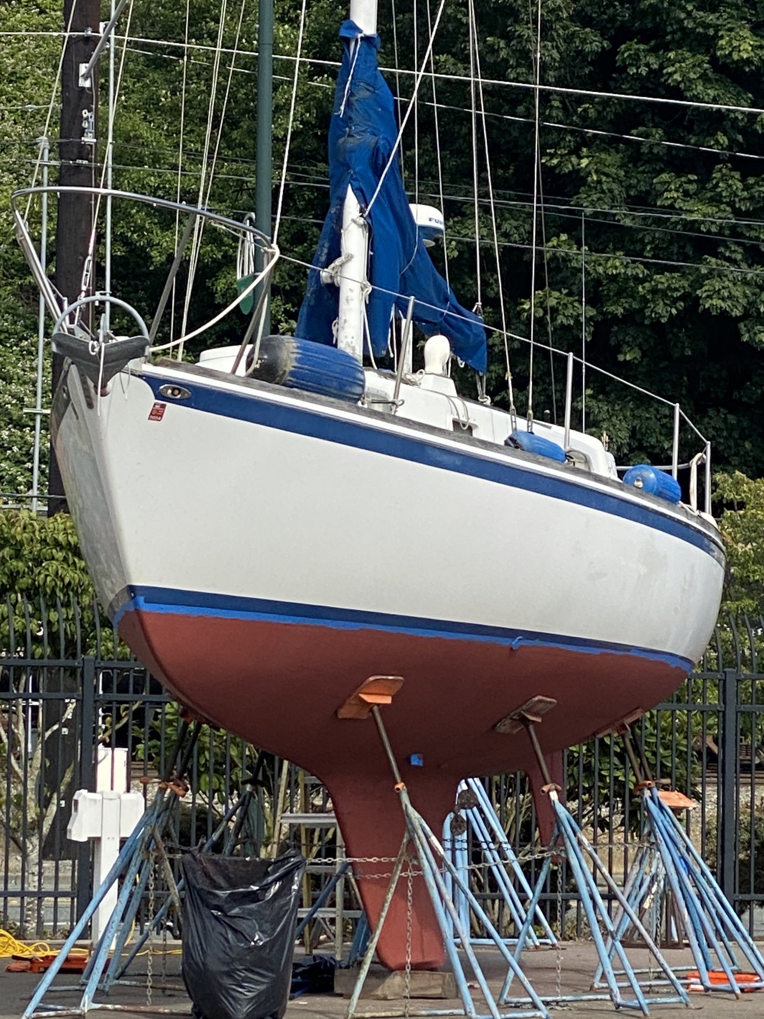

I’m guessing you will want something like the 33” to 50” size. Note your draft is the distance from your water line to the bottom of your keel. You’ll likely use a 4-6”wood block to set the keel on. Then you position you jack stand about 18-24 inches below your water line. The 50” stand could come close to ideal.
Here is an image of jack stand placement on a typical 30ft boat in our marina.
