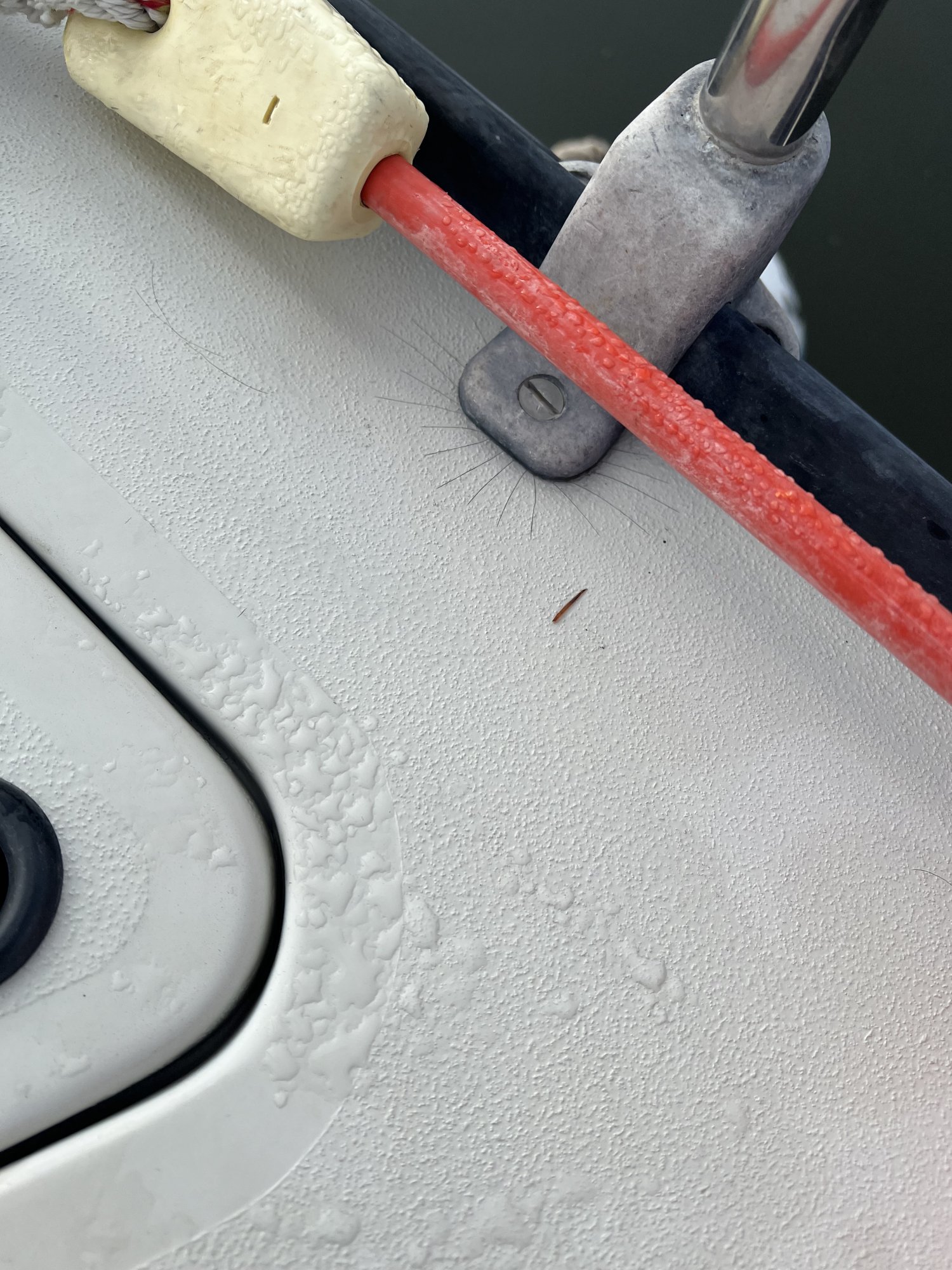

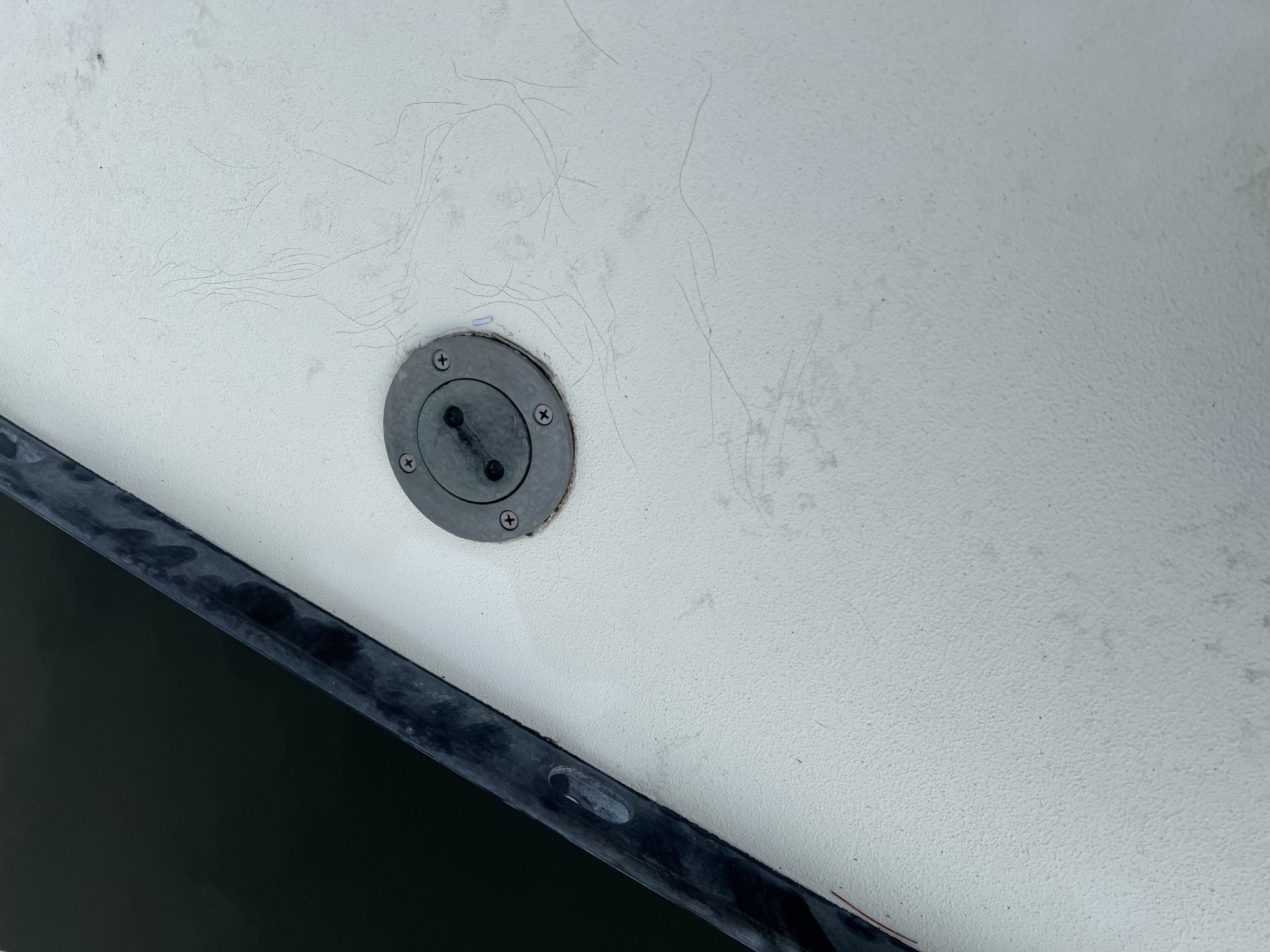

As long as the mast didn't leak I think I would prefer the boat without the crazing because most of the time it would look faster and I could always explain why I wasn't always racing.
14,278
Crazing is almost always cosmetic. It occurs because gelcoat is brittle and cracks easily under any kind of stress. The crazing by the stanchions is proabably caused by compression from the mounting bolts and people grabbing the stanchion to control the boat at the dock.
On a 40 year old boat, it would be unusual to not find some gelcoat crazing.
Both of the boats you are looking at have a good pedigree. The boat you want to buy is the one that you look back at as you walk away. It's the one that reminds of the feeling you got when you looked at your HS girlfriend. The boat will speak to you.

One of the reasons the S2 is heavier may be the fiberglass layup - which is why there is less crazing on the S2. Another aspect to consider is the Sail Area to Displacement ratio. This essentially is an indication of "horsepower" . Boats with higher ratios will do better in light-air situations because they simply have more sail area in relation to their weight than boats with lower ratios. Besides rating 18 seconds a mile faster than the S2, (which is considerable, actually), the C&C's SA/disp ratio is 17.88 compared to the S2's SA/disp ratio of 16.41. This means that the lighter C&C has more capacity to get it moving than the S2 does in both light and heavy air. For daysailing in a light-air venue the choice is obvious.

The crazing is pretty common in ~40 year old boats.
I would not let that impact my decision….layout, sailing characteristics, auxiliary condition to me would be more important decision points.

Layout, build condition, and the one your partner likes will influence your boat's joy over the years by much more than 0.37knts in boat hull speed.
The observed gel coat cracks may be associated with a thinner gel coating in that area and the way previous owners tried to stop the boat while docking (grabbing and pushing on the stanchions).

I think that you will not find any perceptible benefit performance-wise with the C&C. The crazing will forever bother you and possibly affect a re-sale. By far, use condition and aesthetic appeal as your guidance. Maybe you just like the C&C better - nothing wrong with that. Condition makes a huge difference when you consider the cost of boat maintenance. If you are new to sailing or boating in general, you probably have no idea how much it costs to maintain an aged boat. Let's just say that just about all of us significantly under-estimate this cost. If we went into boating with real knowledge, we would probably run away at the start. ;) The cheapest boat is always the most expensive as time goes on.
