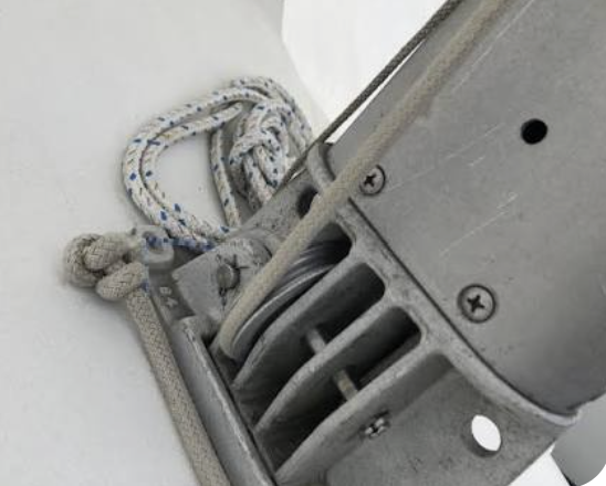

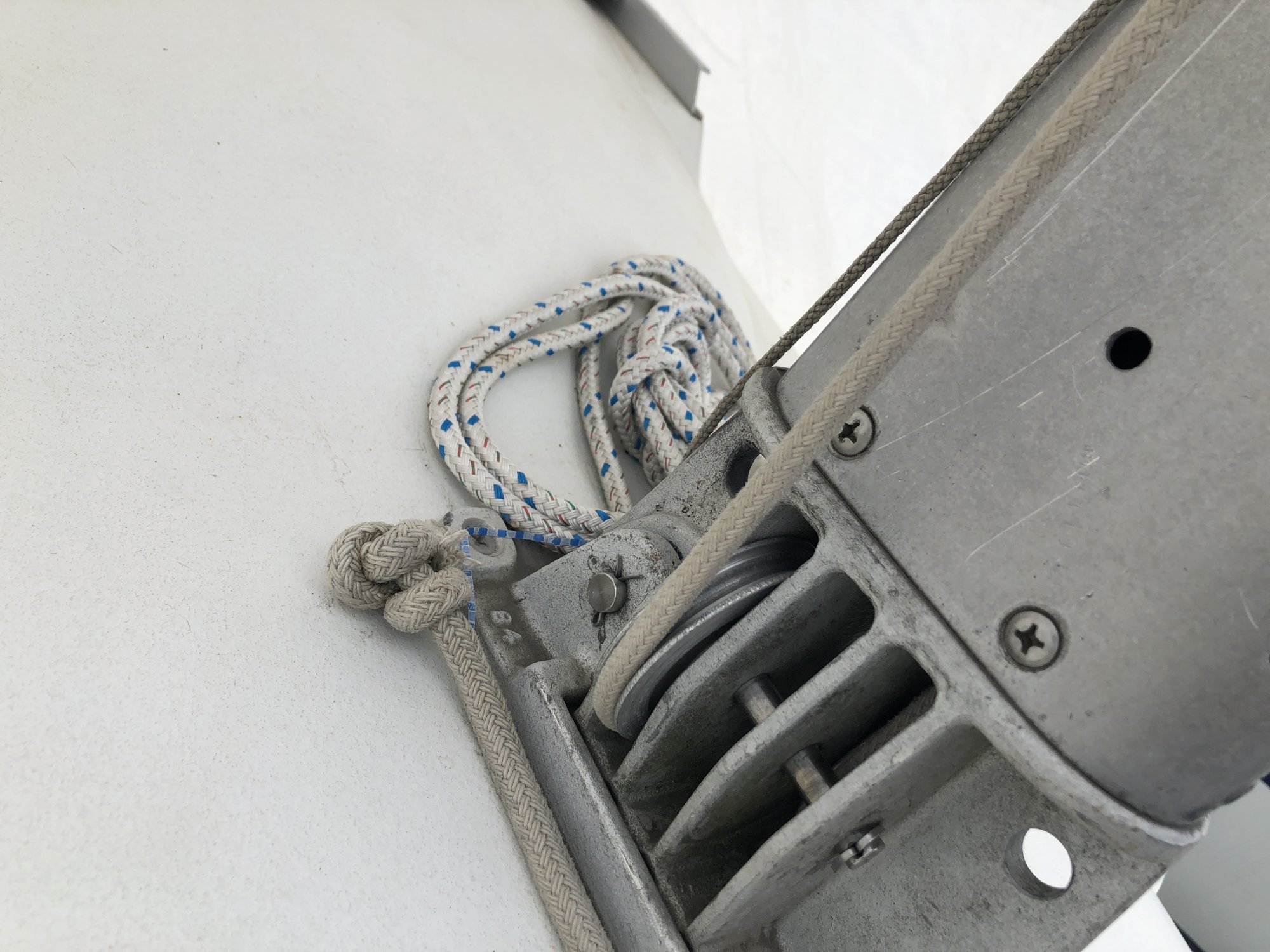

Here is a picture of my mast base, wondering if there are mast bases that can be attached/aligned to get the lines out on an angle....

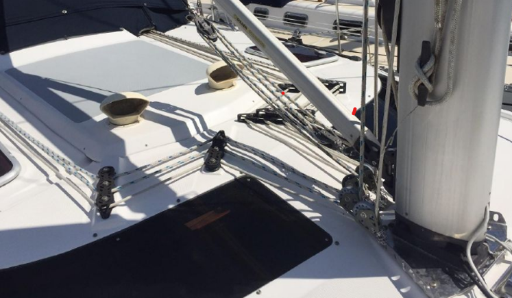

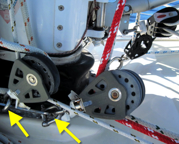

Great idea!! All my control lines and halyards are run to the cockpit. Below is a photo of how my lines are run from the base of mast through individual single block then through turning blocks then to the cockpit through clutches and then to winches.

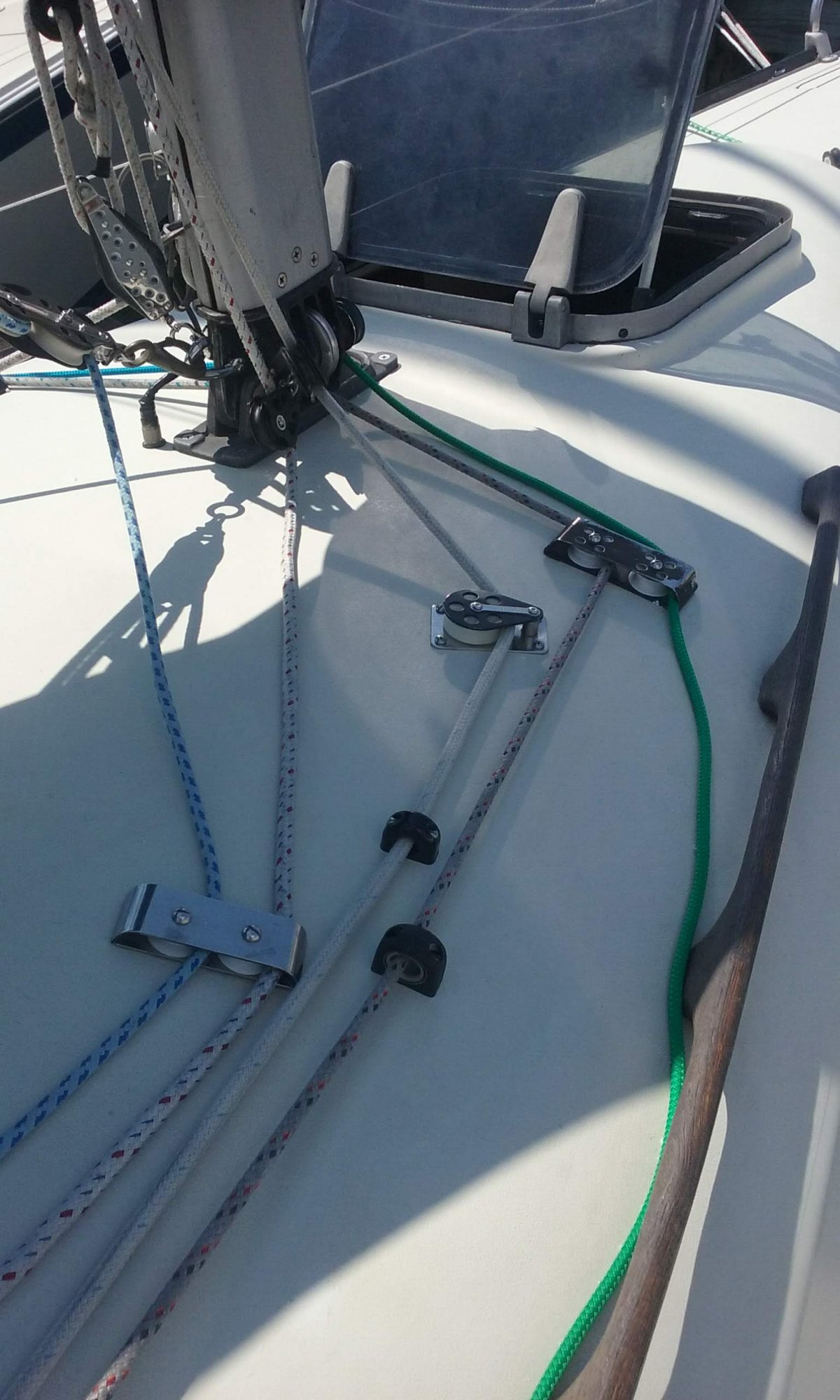

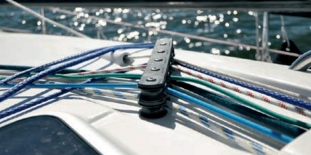

On my C&C 25 I have run everything to the cockpit. I have a couple photos to share.
On starboard (top to bottom): Vang, M. Halyard, Reef 1, Reef 2 and Spin pole topping lift (green). On port side (top to bottom): cunningham, jib/spin halyards. Be sure to over-drill, fill and re-drill when bedding hardware and be sure to use butyl tape (Bed-it by Mainesail). Good luck and fair winds.

@sailsfbay - one of my questions was to check if the lines could go straight from the current mast sheaves to a deck organizer and then turning ~90 degrees aft to a clutch. I see you have a couple of extra blocks connected to the mast base.
Thx - will see if I can get more pictures of other 25's and see similar arrangements.

I am sorry if I am asking a different question. I have the same stepping mast system as the first picture. I lost the step pin. Does anyone know the pin specifications or if I can use a different pin. Thank you

..............one of my questions was to check if the lines could go straight from the current mast sheaves to a deck organizer and then turning ~90 degrees aft to a clutch............
You will need a mast base block to run the line from the mast to a turning block to turn 90 degrees.

My organizers are abeam of my mast just slightly aft and although I am not sure of the angles, I think the 110-115 degree estimate is about right. Regardless, when the organizer (SB forward) was installed (by PO) it should have been skewed differently. As it is, a slightly thicker line will chafe on the organizer body and for that reason I suggest checking your line angles entering and exiting the organizer before drilling. Thankfully there is about a mm or two between the current line and the body of the organizer... another degree or two of angle would be a problem. I think that as long as the lines are not chafing, there should be a decent range of entry/exit angles for most organizers. Cheers.

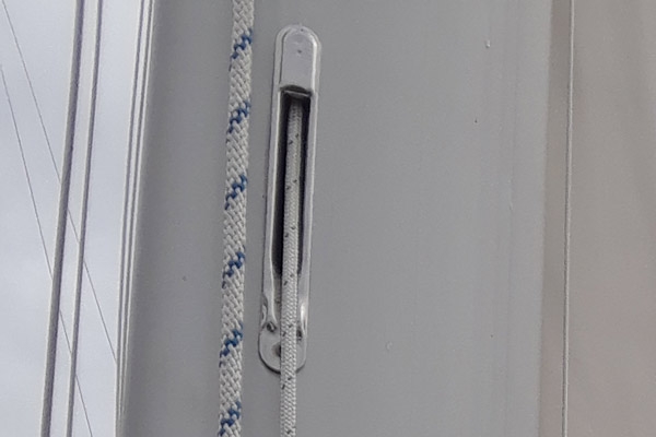

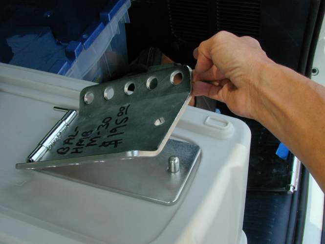

JS There are 2 scenarios.
ONE you insert an exit box in the mast about 2-3 meters above the base.
This gives you the option to jump the halyard manually if you have a problem with a hoist. The line comes down to the deck and you fit an organizer at the mast step with block to make the 90º turn away from the mast.
Here is a hinged plate as used on a Catalina 27.
With blocks that attach to the deck level plate holes.

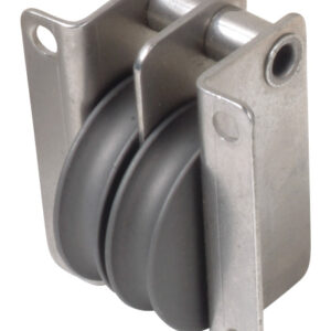

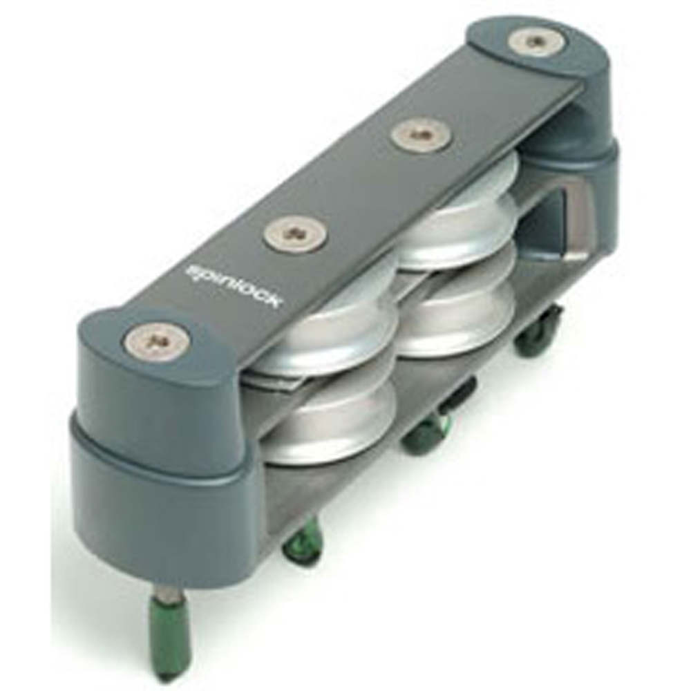

Or TWO you install Mast Exit sheaves at the base of the mast.
This requires cutting a hole in the mast. They come in pairs like the image or singles.
You then need to install a deck organizer near by to direct the halyard towards the cockpit.
