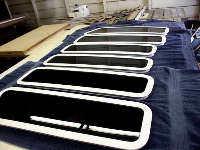

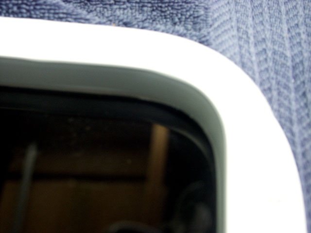

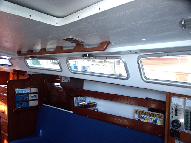

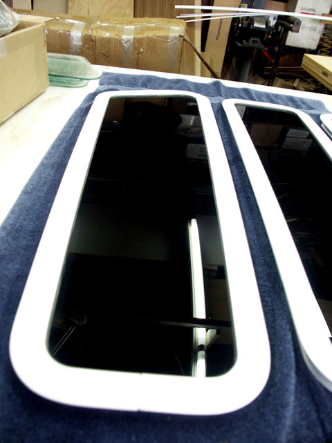

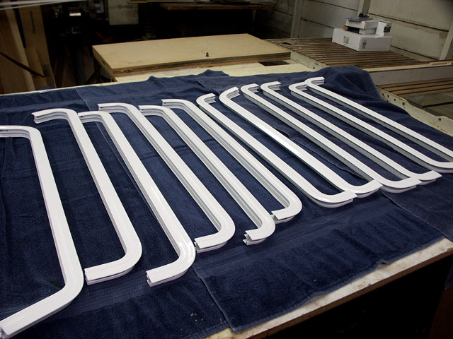

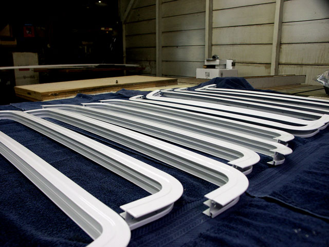

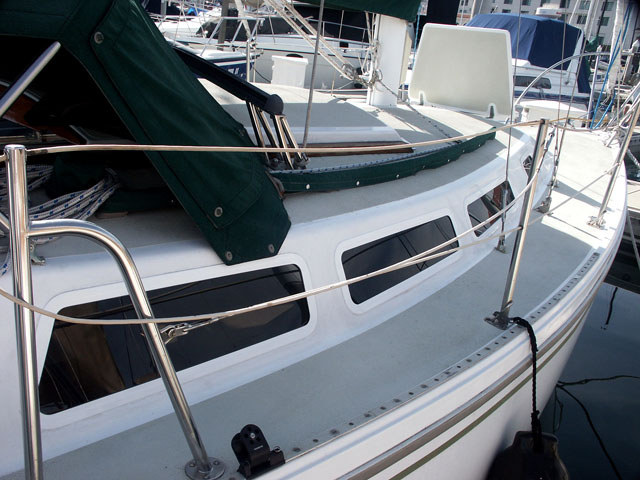

I did it with the Catalina Direct kit and a couple of additional wrinkles. With careful planning, one or two dry fits before assembly and decent shop technique this can be a good project with the original aluminum frames that seem to be universally hated.
The additional wrinkles were new tinted plexiglass panes in place of the old glass ones, powder coating on the aluminum frames and a spare set of windows found on ebay to fill the cabin holes during the project. It took me two weeks start to finish, one of those weeks in the middle for the powder coating. Total expense was about $350 (CD kit + new plexi + powder coat). The spare windows were traded after the project for a spinnaker sock so I did not include their cost.
Here are the pictures

Thanks Guys. Nice job Neil. I was planning the exact same solution since I don't mind the original frames. Did you cut your own plexiglass? I suppose Cruising Concepts makes precut plexiglass and will inquiire. How was your exterior seal with the CD kit? Any problems?
880
Fed up w/ personal attacks I'm done with SBO
No problems with the CD kit whatsoever. The windows are now better than new and not a single leak anywhere.
Yes, I made my own plexi panes. It's very easy if you have the right tools available. I adhered the original panes to rough cut plexi blanks with double-back tape and pattern routed them with a router in a table and a flush trim bit. You can see it in the picture background. All six panes took less than an hour. Note that the pane size is unique to the frame and are not interchangeable from boat to boat or port to starboard on the same boat. I noticed this comparing my temporary set to my original set. Whoever makes the plexi panes will need the original glass to get them right. Keep everything marked or you risk getting a jumble.
If you are unfamiliar or unskilled with a router it's best to have it done by your plastics source. A router is a violent tool in the wrong hands.
The plexi panes are prone to scratching and crazing over time but an advantage is they flex and conform to the cabinside curvature. With the old glass windows you're trying to seal a flat window to a curved surface. One other little trick is to orient the vinyl seal butt joints at the top of the window.
As I disassembled the frames I marked them for location and orientation with an electric engraving pen inside the flange, made things much easier on reassembly. Keep the frame joint plates in separate baggies too. Everything has to go back where it came from. All this is the workshop technique I mentioned before. Keep the work area clean and organized and it should go well.
With apologies to those who like them, I am not a fan of the oversize Cruising Concepts retrofit windows both in appearance and the whopping price they get for them. As I said in the earlier post, I have $350 invested in my fully re-paned, resealed and powdercoated window set. Compare at $1200 for the retro's. They'll scratch and craze over time too.
Powdercoating can be had in a variety of colors. I chose white because my previously replaced Lewmar opening ports forward were already white. If you prefer the original aluminum look you can get them powdercoated gray.

Good luck to you. One last tip: DO NOT pry on the frames from the outside under any circumstances. You may slide a flat blade in there to cut the caulk adhesion but any prying at all will deform the flange significantly. Once the flat blade cutting is done the window must be pushed out from the inside.
Patience is a virtue.
BTW, plastic is easier to rout than wood. Pane stock is 3/16" thick.

I suggest you and everyone else with the original aluminum ports keep an eye on them for leaks and associated aluminum rot. They can corrode to a point where there isn't enough good metal left to restore them. Powder coating does not fare well on filler.
My policy is to stay ahead of the problems rather than chasing them.

Frames are in the shop being sand blasted and powder coated. Pretty excited about seeing the finished product. Just curious about the extrusions that came in the CD Window Reseal Kit. Does the kit include the larger interior frame extrusion that matches the original with a large center channel or does the kit include something different? There are many low cost alternatives with the exact specifications for the window extrusion and curious about the frame.
Thanks!
Dave
880
Good luck to you with the project. Sounds like you're well on your way. Are you replacing the glass panes with Plexiglass or Lexan? What color powdercoat?
The vinyl extrusion you're asking about I refer to (perhaps inaccurately) as mullion. It's included in the CD kit and is a perfect fit. I don't recall if I mentioned it but I placed the butt joints in both the mullion and glazing vinyl at the top of the window , staggered from each other.
880
Dave,
Are you powdercoating the clamping rings? If yes, consider adding flat washers under the screws so there's no gouging of the finish during installation.
My clamping rings were not powdercoated. Instead I left them bare, carefully straightened them from previous installation deformation and acid washed them. I used Alumiprep 33 available at Aircraft Spruce but any welding supplier will carry a similar aluminum preparation product.
