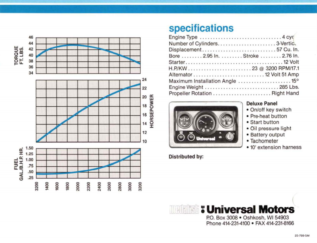

Based on this attachment, 2400-2500 RPM is fine for that engine.
M25XPB.pdf (torresen.com)

I always heard that you can comfortably cruise at 80% of the maximum RPM of a diesel. According to the information sheet, I found on the Internet, the maximum is 3200 RPM. So, 80% of 3200 is 2560 RPM. Also, how fast is the river current? That will slow you down for sure.

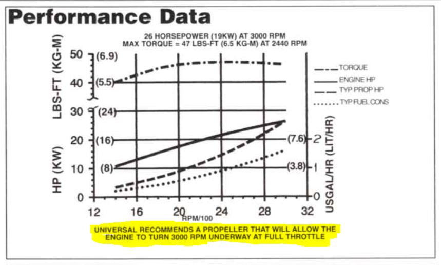

Let examine the data sheet provided by @kloudie1 (always a helper).
WOT - Wide open throttle is identified as 3000. That is what the wizard @Stu Jackson stated and he has years of experience.
Jumping back to the questions - Prop - 3 blade?
That is a personal choice. I would base the selection on the type of cruising you are considering. If you are constantly in conditions that the wind is fickle then you might want to emphasize the auxiliary power and maximize your prop performance. The 3 blade prop is identified as a smoother prop in action.
If you are focusing your sailing on racing or maximizing your sail performance perhaps you want a 2 blade either fixed or folder. The fixed can be set to hide behind the keel reducing the prop drag while sailing.
Your boat your choice. Ain't America Great....
FYI, the OP's engine is an M25XP not M25XPB and they have a different block and more horsepower. They both do have the same WOT so other than a bit less power, the advise for one applies to the other. Mostly this becomes an issue when you get parts because they ain't the same thing. FYI to get parts that are not a part of the marine conversion, the M25XP is a Kubota D950 engine and you can get part cheaper at the Kubota dealer ship and much cheaper on line. A full overhaul kit is only $450 or so.
