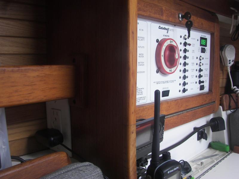

I have a 1995 Catalina MK III and I have one GFI receptacle mounted to the left of the Electrical panel. This receptacle feeds (protects) the 3 other non-GFI receptacles. I checked the non GFI receptacles with my GFI circuit tester and each receptacle trips the main GFI receptacle.

Mystery solved. My C30 MkIII does indeed have a GFCI outlet, in the same location as Captn Dean's.
Problem was, unlike Capn's, mine has a brown outlet and faceplate, which blends in nicely with the woodwork. Plus, there was a lot of 'stuff' stored on the shelf, blocking the outlet from view. Surveyor missed it...I did, too.
