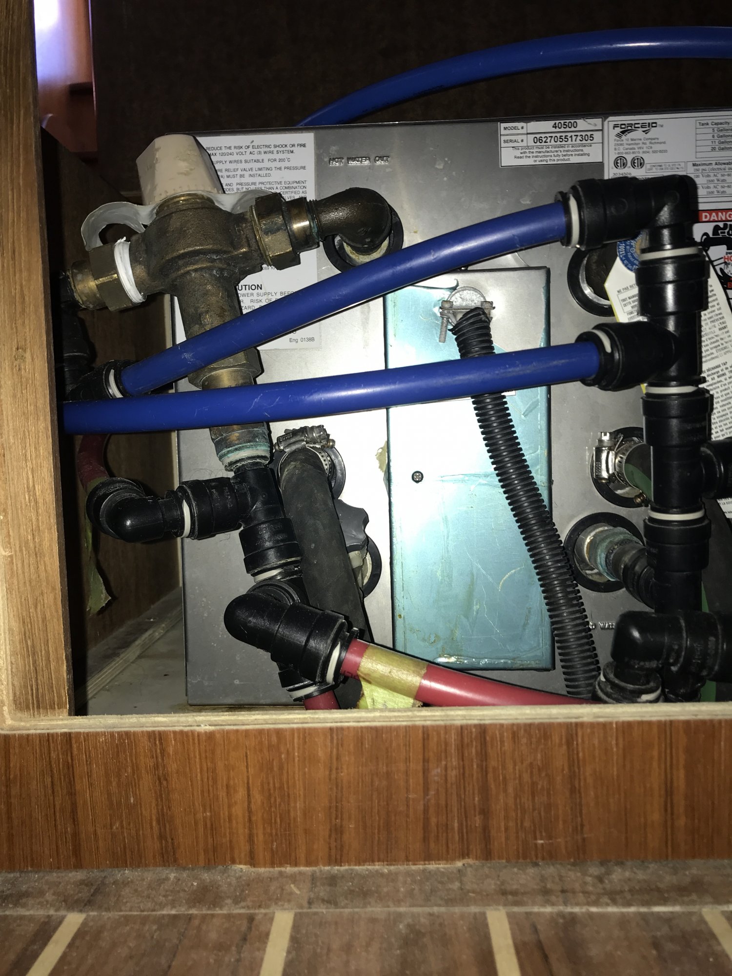

That's quite the Rube Goldberg. You may have to trace the tubing and diagram it to get the whole picture.

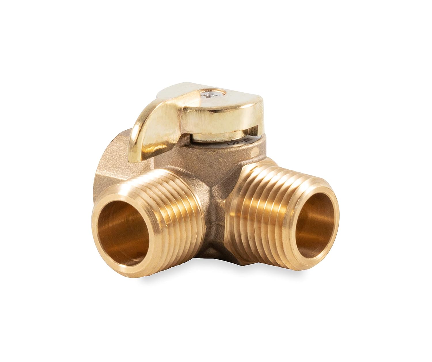

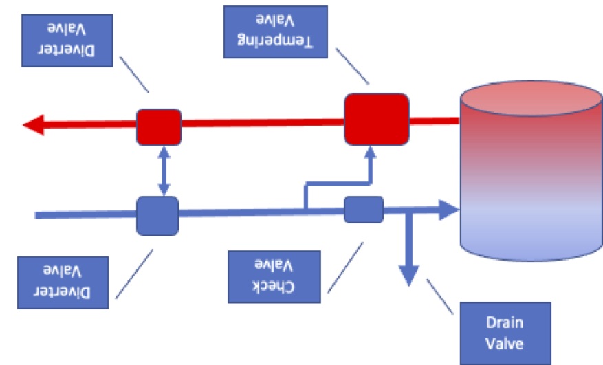

One of my off season projects is to redo the lines to my heater so I can bypass it with a flick of some valves instead of disconnecting and reconnecting.
Woohoo! found a 3-way valve that should be perfect for my bypass setup. With this I'll just need one each valve on the in and out nipples and a bypass hose connecting the two. Fewer connections and only 2 valves to turn. I'm doing this in PEX. I have the crimp toolkit
