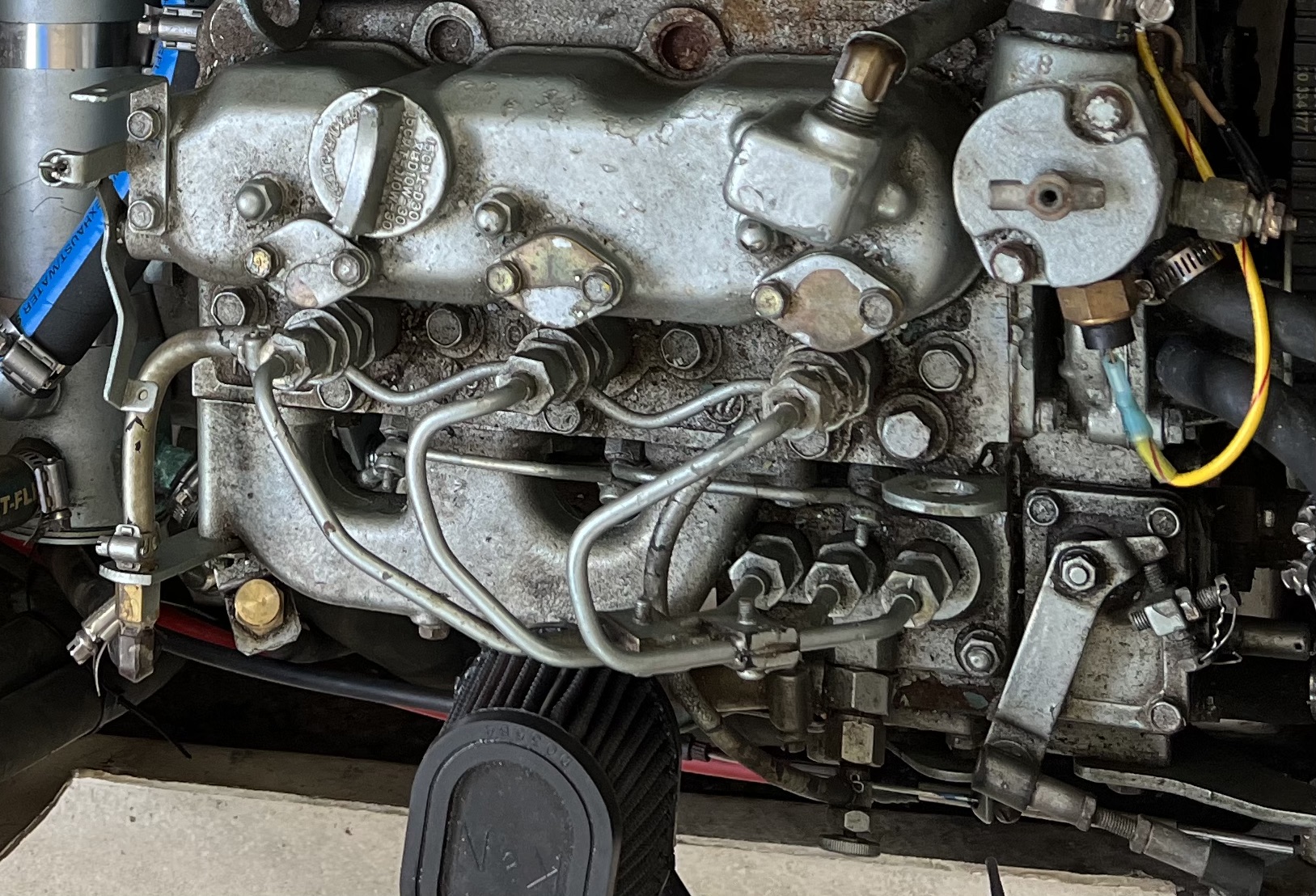

Here's a photo of the location of the temp switch on the thermostat housing. The yellow w/strip wire runs to it.

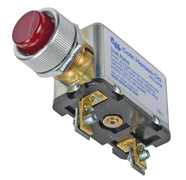

Use @dmax 's Dual Alarm Combo and you 've got a Cadillac alarm system.

@dmax Is the Cole Hersee Dual Alarm a two tone alarm or alarm and LED? From the description it sounds to like they are using "Dual Alarm" to describe the buzzer and LED, not a two tone buzzer?
@Ralph Johnstone That's what I saw. Looks like one contact for ground and one for positive. You'd need two to cover both oil pressure and high temp.
It says it is dual alarm but I only use it for the oil pressure, my temperature alarm is completely separate. There're just two connections, positive and negative like you say. I think some marketer wrote up that description.
