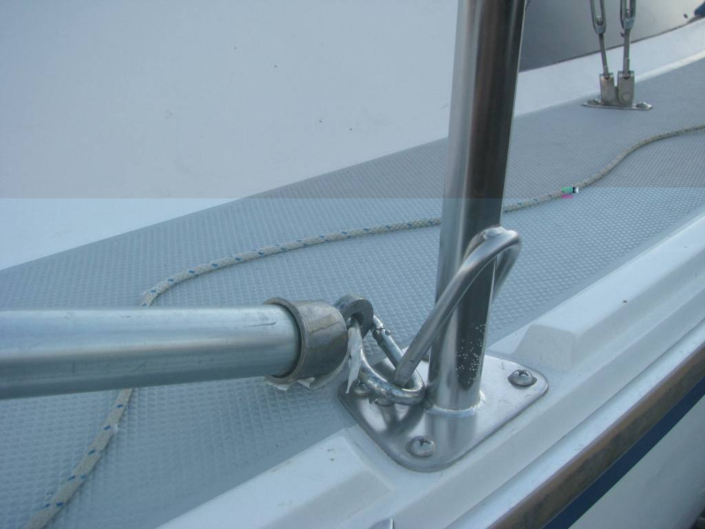

Wing keel boats launch very easily if your trailer has an extending tongue and your ramp is long enough to use it. Otherwise, you can use a fixed dolly wheel and a strap to back it down the ramp. Getting it back on is a little trickier because the boat wants to settle on the bunks a bout 4-6 inches too far aft, especially if the ramp is steep.
There are several systems for raising the mast involving A-frames. They work easily with two people and reasonably well single-handed. I've done both.
The system I use has the mast fastened to the apex of the A-frame with a fixed-length line (spinnaker pole topping lift). The A-frame moves with the mast at a constant angle. That puts the tackle lower where you can get to it easily. Others use a system where the A-frame is fixed in the vertical position and the mast is hauled up to it. I think that might minimize sideways swaying of the mast while it's being raised. I like mine and they like theirs, so I'll leave it to you. I use a 4-part tackle to raise a TR mast and it's plenty of power. I have done it on the trailer and while afloat on a calm day. Both work.
It's the first couple of feet that are the toughest. You can eliminate the strain by making a very long fork out of a 12' 2x4 to prop up the mast to partially raise it. Just lean it against the transom of the boat.

I agree, the Mast-up is a huge help.
There are many options to help raise the mast - A-frames and ginpoles being the most popular. I built an A-frame this year which I modeled after an old post on this site before it went down :( . The attachment includes the description and photos from the old post along with a few changes I incorporated, shown in red. I think the whole thing cost about $40. You still need a second had to stabilize the mast (side-to-side) when raising and lowering, but it works like a charm.
If I ever get around to it, I'll take some photos and write a clear description of it. In the meantime, maybe we can encourage some other owners to start a new "Mast Raising" thread with descriptiosn of their systems. I know Aviator James had a nice video at one point.

I pirated the Aviator James version of an A frame and it works better with less effort than any other contraption I had used over the years. I added rubber covered feet th the bottom of the frame to protect the deck. It is simple in design, as in easy to build and easy to use single handed. Hopefully he can repost the video.

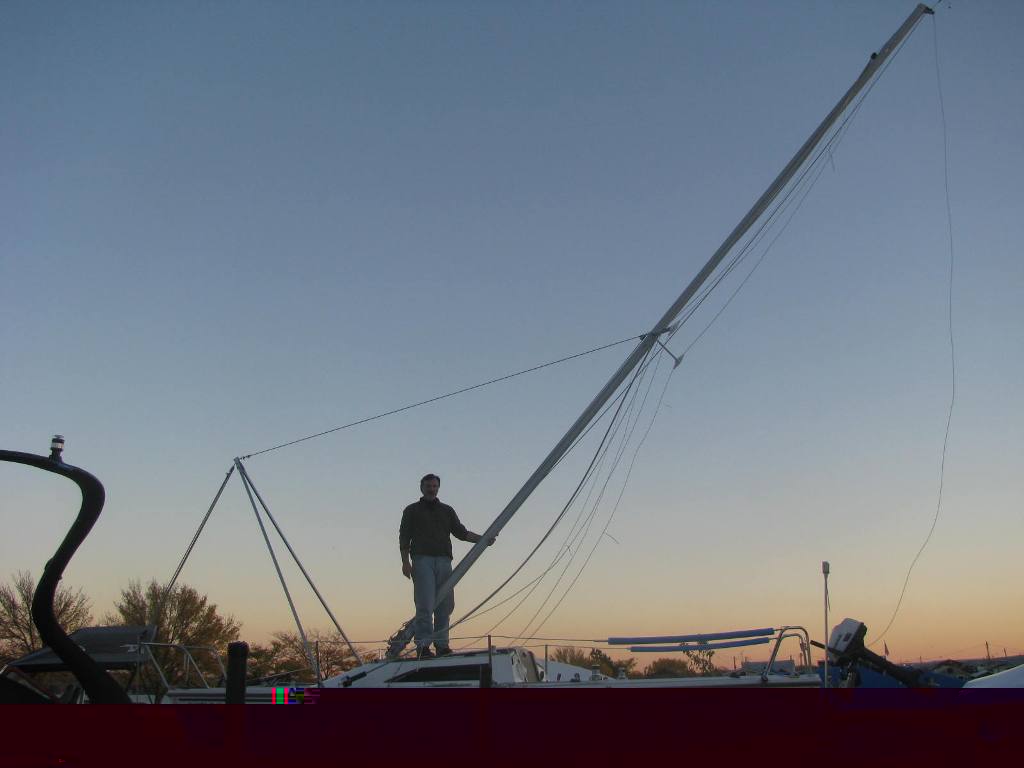

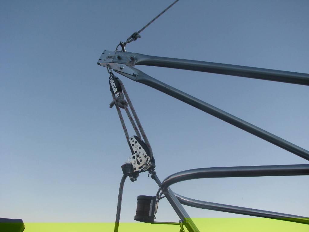

How are you guys connected at the mast? I have a similar setup, but with a gin pole instead. I'm connected to the mast by the jib halyard which makes the lift more difficult at that angle. It looks like you're tied in near the spreader bars. Do you have something mounted there and keep a line attached permanently?

In the 3rd still photo before the video starts you'll see the block attached to the "bale" at the spreader.
It is permanently attached at that point since you can't get to it once the mast is raised.
The other end is a quick disconnect from the pulley at the top of the A-frame in the 2nd photo.
After raising the mast...
The A-frame gets dropped and I disconnect the turn at the top A-frame pulley.
(about the 3:30 point in the video)
I loop that turn around the cunningham-cleat and then cleat the working end there as well.
(about the 4:00 point in the video)
Hope this helps!

Have you considered using the pole topping lift to attach the block (instead of on the bale at the spreader)? Then just pull it all the way in and cleat it off. Then - when up and forestay is connected - you can lower the topping lift and unhook your block.
Just a thought...

...yep, you could certainly skin the Cat (alina) that way!
