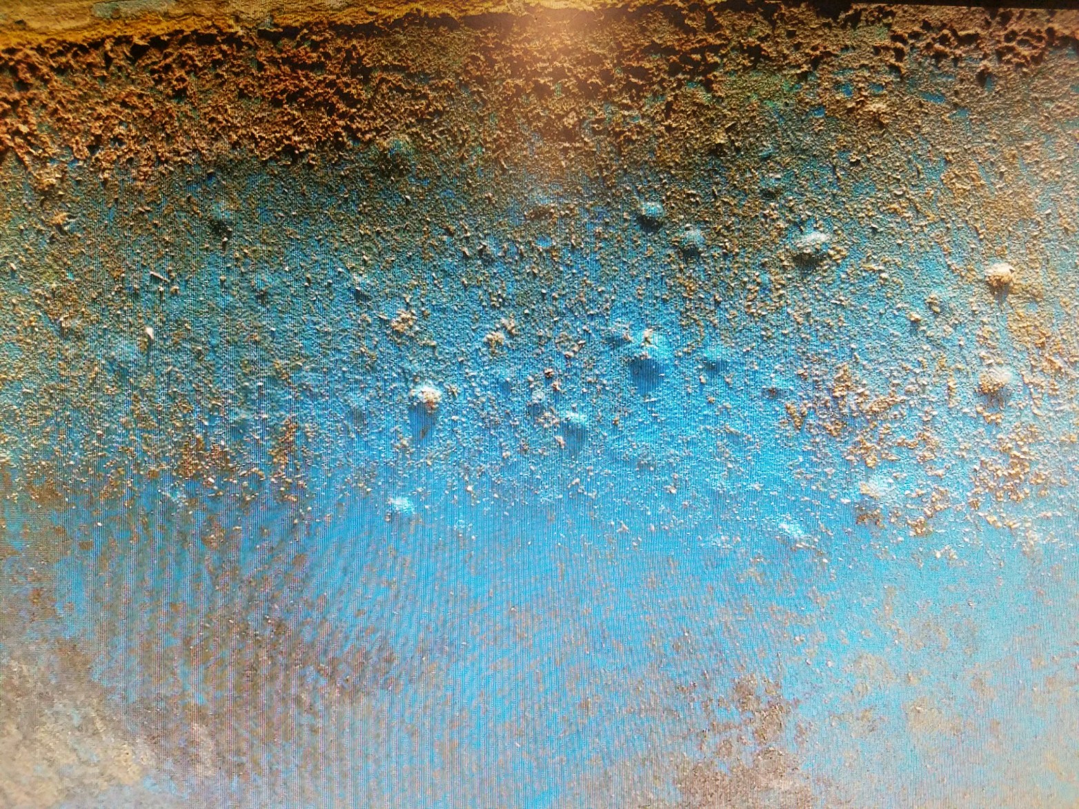

I've found a hunter that's been very well maintained; however, it has small "pimple" sized blisters along the waterline on one side of the boat. I'm guessing these are fiberglass blisters, and not gelcoat/paint because they're hard as a rock. The boat is priced at NADA value. Would you continue with a survey, or run like hell until you find something else?
Also, I don't mind fixing the issue myself, but I would be worried about the resale aspect.
Picture below.

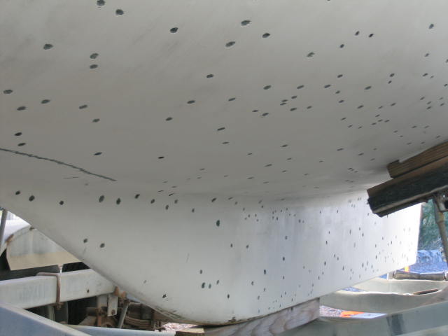

When we purchased the boat we are currently rebuilding we thought it had a couple of blisters....
We are lucky because the boat has been out of the water sitting in the desert for 17 years. Not a drop of fluid in any of the blisters we ground out. A pressure washing several times, a little filling, $500 of barrier coat, a little paint, and better than new. :laugh:

If you like the boat otherwise, go thru with the survey. Maybe you can negotiate the price some to account for the repairs. The NADA valued price assumes what condition?

Drying out blisters is the key if boat just came out water some will disappear on there own

Have you gotten a professional's opinion of what they would charge you to do the job?
If these are wet blisters you may be looking at some serious time out of the water to dry them out, before you can begin to repair them. I would ask a pro for a quote before I made an offer, even if I intended to do the work myself.

I would see about getting a quote to repair. Most yards will give a free quote this time of year. Use it as a negotiating tool as others have commented there is no perfect old boat. Old boats don't sell like cars today here today gone tomorrow. Time is most likely on your side to make offers.

Everyone's suggestion for this post is "spot" on. Pun intended. It's not very hard to rectify this very common issue. Some of your decision comes down to what your time is worth. Other than some fairing material, you'll have to consider the cost of barrier coat as well as the top coat. If you're buying close to a NADA price you should get a survey. You may even need it for insurance purposes anyway once you buy the boat.
