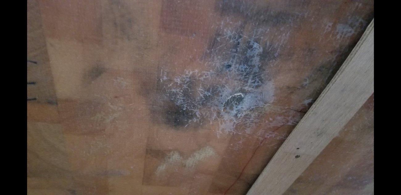

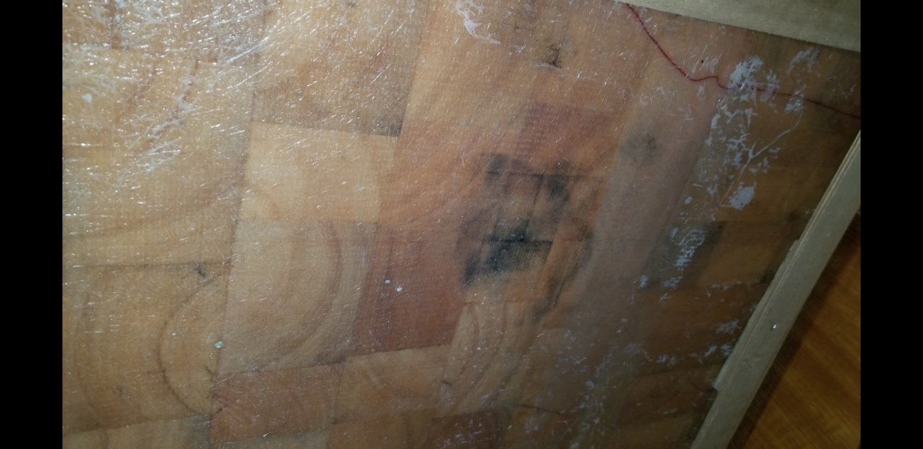

When I look up at fiberglass in the ceiling I see some black spots. Is that rot or something to be worried about? Or is it nothing?

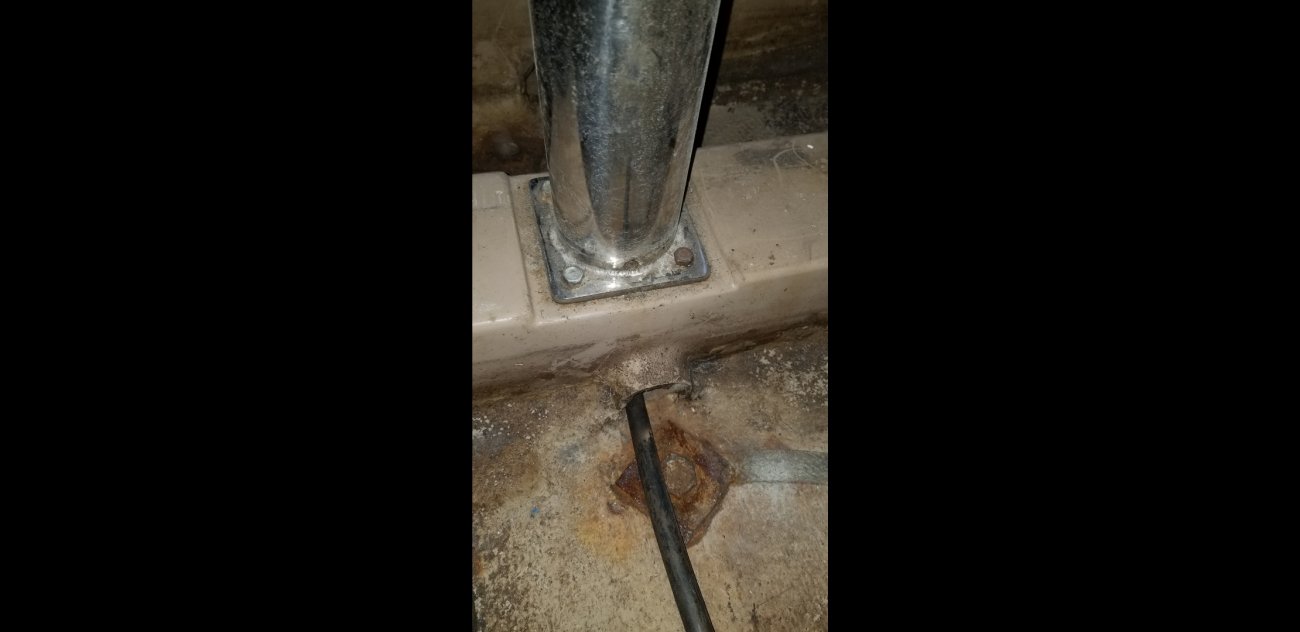

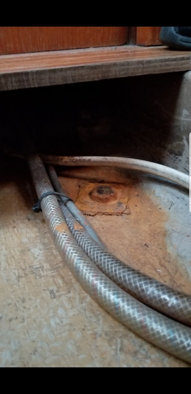

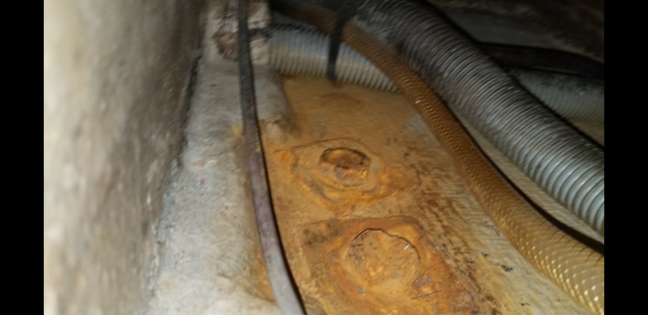

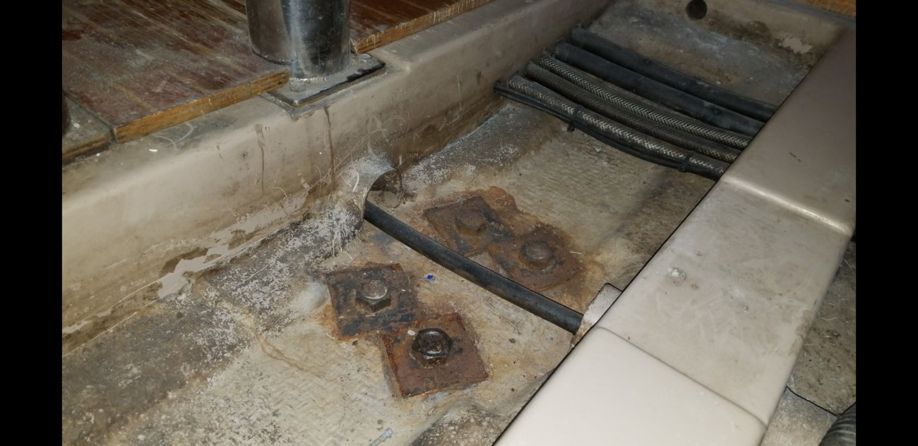

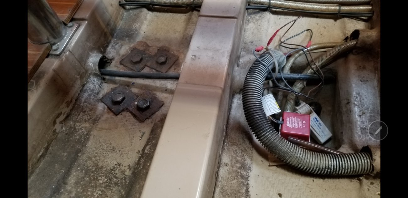

The keel bolts/nuts/hardware looks pretty rusty. Is this something to be worried about or not a big deal?

The keel bolts certainly look bad to me, but again, not sure what sort of boat this is. A few of the bolts don’t have any threads showing above the nuts and the nuts look very bad. I would have to assume the bolts are also in bad shape.
The black spots on the ceiling could be from mold, but the interior doesn’t actually look too bad. You can see the square filler (balsa, I assume) material between the laminate. I would very carefully inspect the top deck above the dark spot to check for mushy decks, or other signs of delamination. But it really doesn’t look to bad from the inside. Why is it bare fiberglass? Normally there is some sort of interior liner to cover up the laminate. Is there signs of leaking?

Black areas are almost certainly areas of water intrusion from the deck. As Tally Ho said find out what is leaking on the deck. Make sure you step on the deck in these areas. The deck should not deform at all. You may get away with re-sealing at this stage. And, I agree, what happened to the liner? As for the bolts I think they look worse than they are. I think the nuts and backing plates could be cleaned up maybe except for the two (I can't tell where they are.) But you really don't know the condition of the studs. When the boat is in the sling push on the keel to see if it moves independently of the hull. That would suggest dropping the keel or moving on to another boat. Is that a crack under the table or compression post?
It is a big deal if the keel falls off the boat under sail.
I think what we're seeing in the picture are the bolt heads, with the rest of the bolt tapped into the (presumably iron) keel. In a lead keel I'd expect to see studs with nuts, and yes there should be threads showing above the nuts, but not for bolts in iron. The two worst bolt heads do look pretty poor. If they aren't seized it may be possible to just replace them; the others don't look so bad except maybe some surface rust. Without knowing the make and model it is a little hard to say where else to look, other than the usual suspects like chainplates, mast step, through hulls, etc.

I agree with Tally Ho about the bolts and the discoloration is a flag to look for soft spots in the deck, but really, it looks like blue stain fungus, to me. It is a discoloration of the wood from an insect infestation of the tree and can turn the wood blue to blue green in radial patterns through the sap pores. Mostly it just looks bad. I'm not able to reassure you that is what you are looking at. You need to check more thoroughly by tapping with a plastic handled screwdriver or plastic mallet and listen for those dead spots. Definitely walk around on the deck feeling for softness. The cabin top and decks should be solid and inflexible.

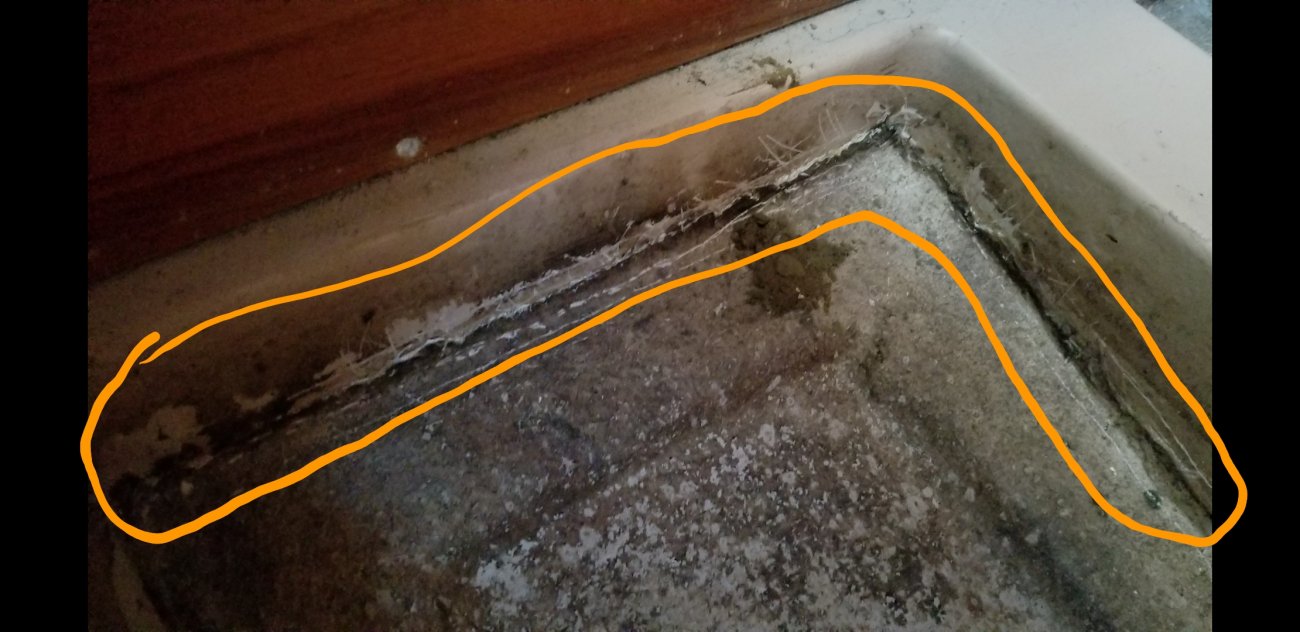

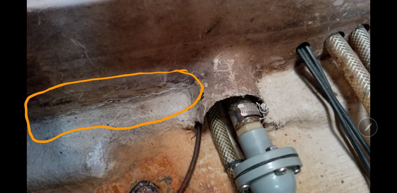

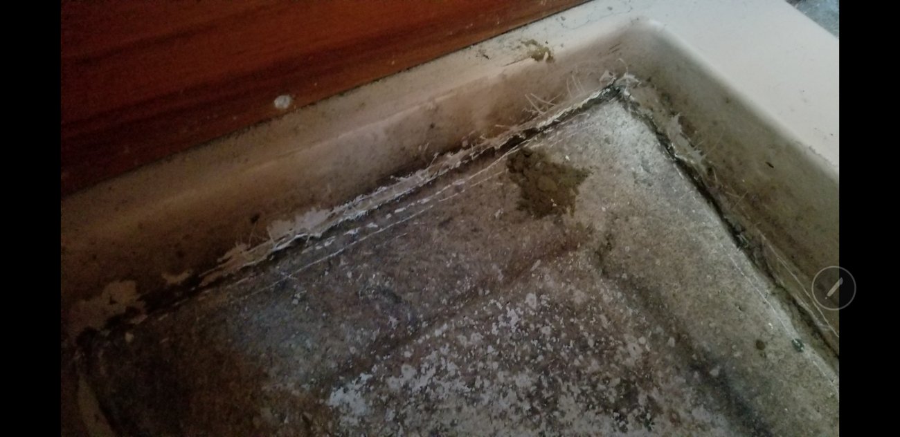

One more item has been on my mind... I lifted all the floor panels I could get to and inspected everything. Nearly the entire bilge looks pretty good with one exception. I can't really tell if this is from manufacturing, damage, or a previous repair... it's a rough edge against the wall. Could this be liner/grid and hull separation?
Ah that sure likes like cracks from something happening to the keel at one point. I'm far from an expert but I'd walk away if I saw that and could get no info from owner. @Jackdaw is a Beneteau resource, maybe he will take a look at that issue. I find it hard to believe that left the factory in the 80s like that.
8,127
Maybe the tabbing of the pan to the hull separated. Usually this is caused by a hard grounding. So you have to inspect the areas in front of and behind the keel for hull damage and the keel for damage or signs of repair. On the good side is that if the keel bolts held up the grounding they are probably good to go. The bilge is dry - right?

The pan, grid, or liner... seems like these are interchangeable terms for the same thing... is a structural component, right?
If that's come disjointed from the hull... it's a serious problem. Dangerous even?
