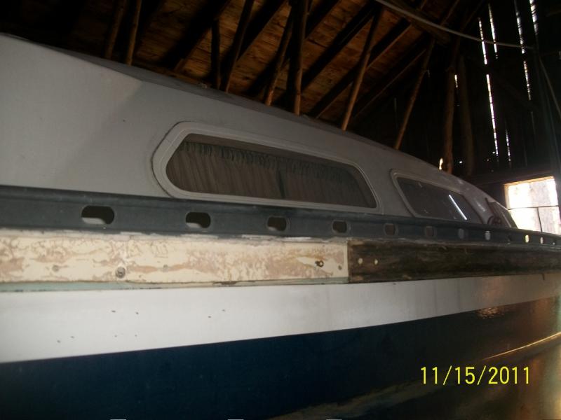

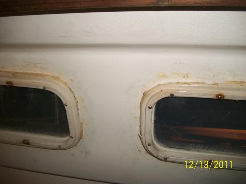

What Kind of Windows are These..?
I don't have a Hunter, but now I'm getting confused on different bedding for different windows...?
I have plastic non opening windows that leak, should I use butyl or silicone or some other sealant on these...??
I plan on pulling the interior screws, splitting the window, sealing on outside (butyl?) and squeezing them back....Am I on the right track?
I had asked this in another section and didn't get an answer, so I'll tag it in here... as I see we're talking about different kinds of windows and sealants...
Feb 6, 1998
11,723
For plastic framed ports I'd use Dow 795
For bronze, stainless or aluminum framed ports it is okay to use butyl..
