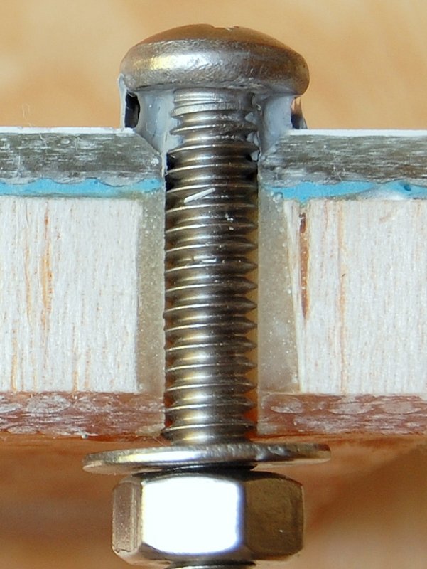

In this photo I used butyl tape as the bedding compound. I loosened the nut and pushed the bolt up to show how much allowable movement can be had with a countersunk hole. Proper procedure & installation is as critical as anything!
If you look close you'll see that the outer edges, where the bolt head meets
flat deck, the sealant has begun to fail or failed entirely yet the butyl in the countersunk recess is still stretching and still there.
If your deck hardware is moving this much you have MUCH bigger problems and this is why this is for illustrative purposes only..

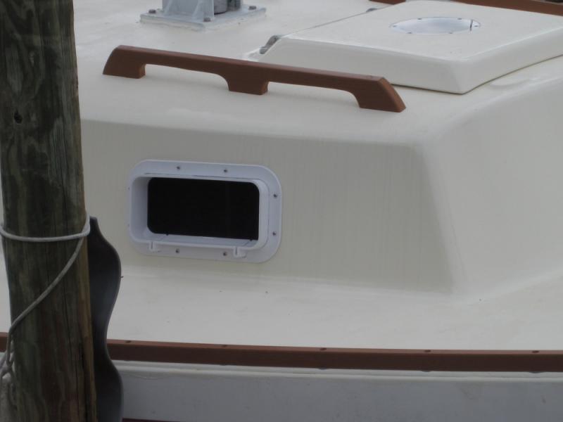

I get mine at the local Camper/RV shop. The roll is about an inch wide. I stretch as needed for narrower width.

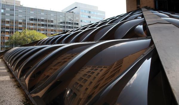

I am a designer for a nationally known skylight company. (I don't do rectangles.) Our company supplies a number of different products, some of which are supplied with plastic glazing (acrylic, polycarbonate, copolyester). The gasket of choices is butyl, hands down. Real butyl has lasted 20 years in the field. When a dome has to be replaced, the butyl is usually still soft, sticky and pliable. AS MS says, this is REAL butyl, not plumbers putty of some nonsense like that. Buy it for MS or go to a glazing supplier.

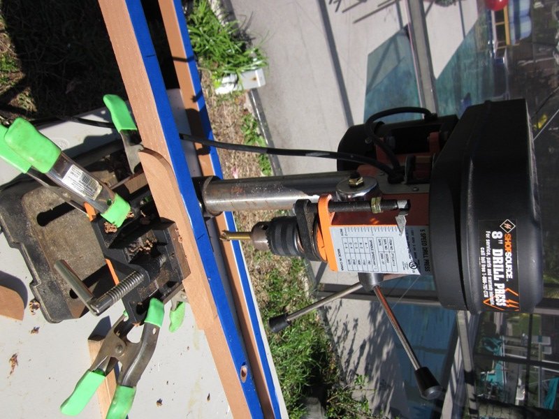

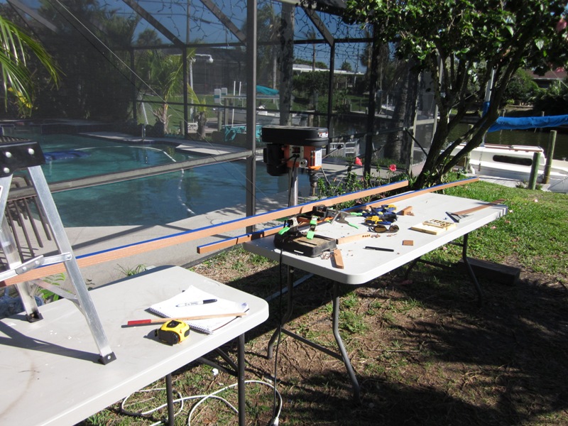

I used a double row of MS butyl with a little ring around each machine screw and it worked great. The thing I liked about using this product most was not having the mess I usually get into when using a caulk.
It took 3 of us to install the toe rail sections on my boat because of the length and I can't imagine having to do that with slimey, gooey, sticky caulking! I stuck the new machine screws in the toerail (8" spacing) then applied the butyl which helped hold the screws in place. Because I used PVC lumber, we were able to bend the section as it was mounted, the rear section was tougher with the new genny t-track on top. I'd pre-bent the track so this wasn't too bad. I made mine in 3 sections; bow to chainplates (mine are mounted to the hull), chainplate to cockpit and from there to the end of the boat. The gaps between the sections help with drainage.
It was hot out and we were moving as fast as possible and I forgot to take pics with everything together, but here are a couple of the rail when I was drilling for the screws and plugs. Also one of the side deck/house where you can see the butyl squeezing out slightly and like the other poster said, easy to trim off.
