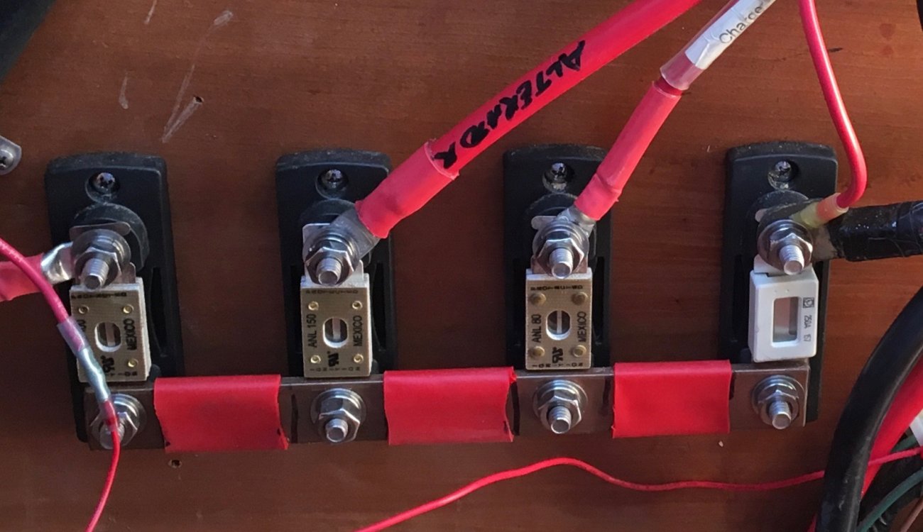

Another alternative is to use a piece of 5/16" copper bar to connect the two busbars. (https://www.mcmaster.com/copper-bars) I used this to make a bus bar between a series of ANL fuses. Insulate the bar with heat shrink. Here's a photo of my positive bus bar.

Go to BlueSea.com , page 15 in the catalog, piece number 9159, it is a "M series Battery Switch Link Buss". 2 for 17.49 in the 2012 catalog I have. Rated 250 amps. When I was trying to wire in my Victrom 600, I could not find anything manufactured. I found 2 copper bars I think at Bacon's (McMaster has it) 1/4 x maybe 1.5 inches. Then later I saw this Blueseas link.
By the way, that upper right stud, it look like the yellow wire piece is sandwiched between the washers?
Interfernce with HS terminal insulation can usually be mitigated by using an M8 flat washer as opposed to a 5/16" flat washer. Also most M8 flat wahsers are thicker than a 5/16" washer but they have a slightly smaller OD.....
I did something like that based on Main's article when I replaced my charger. I used similar buss bar and fuses to distribute the charger outputs to my two battery banks and system "A/B/All switch. Last weekend I used the last piece of bar material to create a common battery ground buss. I no longer have to stack or daisy chain cables on the batteries.
