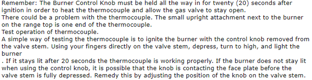

What stove do you have? If it is s Force 10 below is an excerpt from the manual on testing operation of thermocouple:

The only markings on the stove are the Beneteau logo. But looking online at pictures of a Force 10 stove, they look similar. So perhaps Beneteau white-labeled Force 10 stoves.
Regardless, your trick worked! When I remove the knob and light by turning the stem, it stays lit. What do you suppose it means to "adjust the position of the knob on the valve stem"? I don't see how I can not seat the knob fully on the stem - I need to push it in to ignite the burner.
Put a small washer in the hole of the knob. It will seat on the washer and allow the stem to fully deploy. The knob is probably contacting the stove face and holding the stem from being displaced to the point where the thermocouple can hold it in place.

"it is possible the the knob is contacting the faceplate"
That is what happens on one of the burners on the Force 10 in my 36.7. I've found a workaround. I set the burner to "light" and remove the knob. Depress the stem and igniter. Leave the stem depressed for 20 seconds and release. Then replace the knob and adjust the flame.

I ended up packing a little bit of Aluminum foil in the back of the knob (where the valve shaft slides in) so that when fully depressed the knob does not hit the control panel. It’s now working! Thanks for the help everyone. (Didn’t need to replace the thermocouple).
