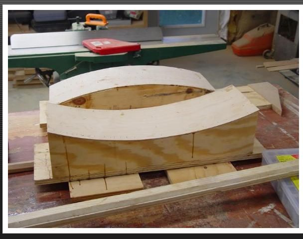

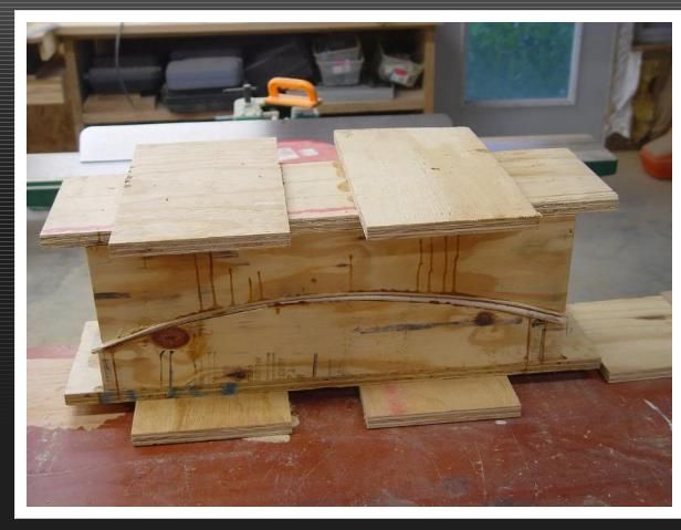

Simplest way to to bend wood is to laminate thin vaneers 1/8" or so around a form and glue up with wood glue or epoxy. I made some spoon blades for oars that were 5" wide and 3/8" thick (3 layers of 1/8" each) bent around a corresponding plywood mound that had a male curve and a female curve and the vaneers were pulled into shape using clamps and make sure that you use

pardon the computer burp. use...wax paper to keep the molded parts from sticking to the molds.
Male/Female Blade Mold Ready for Clamping
