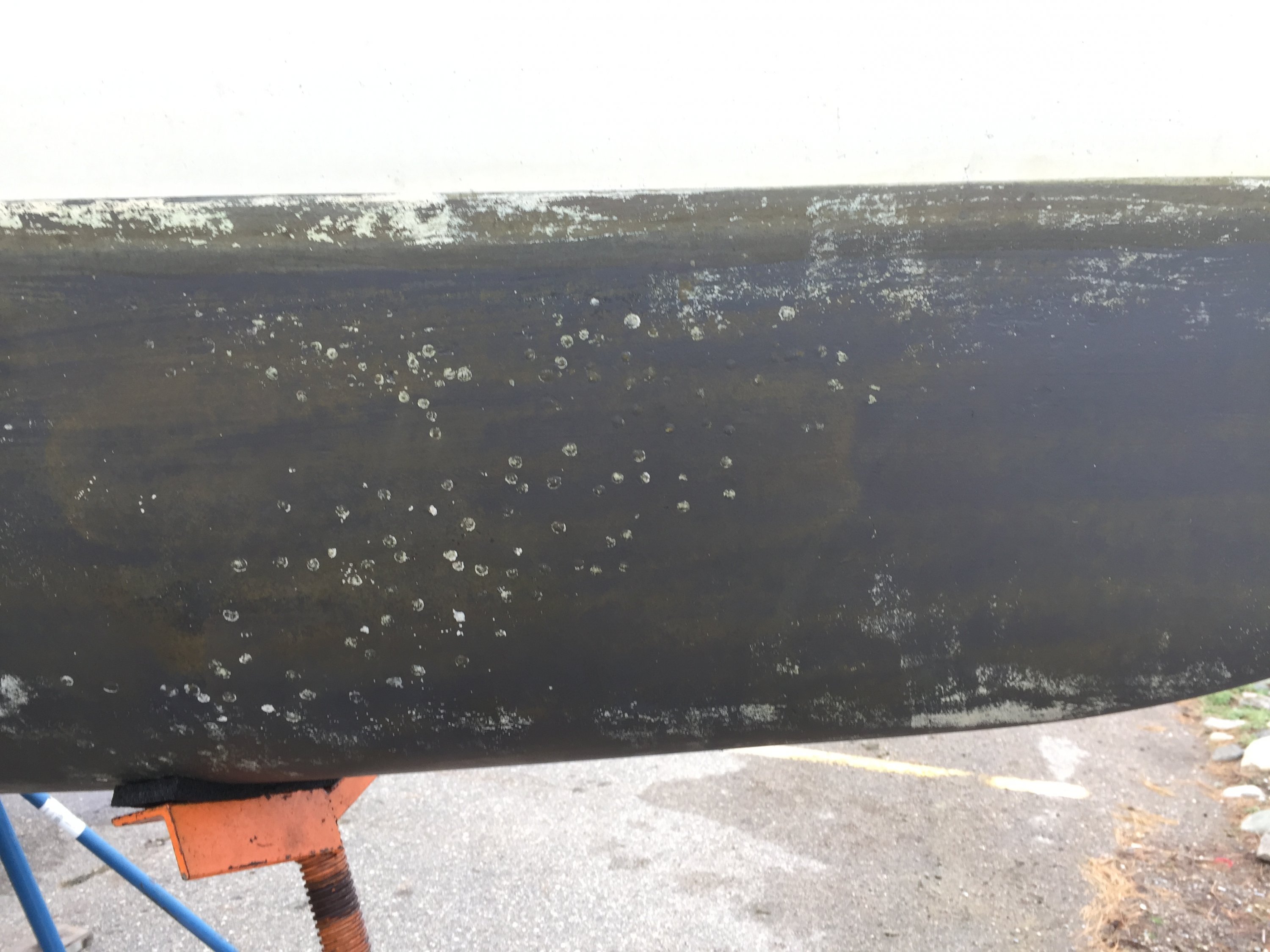

finding these bumps on hull of my 332. About the size of a pencil eraser, hard, and not fluid filled. They seem to be more this year than last but not getting bigger.
Thoughts?

Looks like ring worm... :yikes:
Could it be from barnacles attached to the hull then washed off?
May 30, 2006
370
Oday 34 Chesapeake Bay
Yes, I'm suspecting barnacle residue as well. If blisters, I suspect that they are cosmetic and not causing any delamination.

I have not seen a 322 with osmotic blisters. It was one of the points that gave me confidence in the pre-leveraged buyout boats.
Pat
Jun 7, 2004
1,250
Oday 272LE Ninnescah Yacht Club, Wichita, Ks.
We had what looked the same on our 272 LE...we opened them, and yes, they were blisters....then we had the hull
sandblasted then we opened each blister and filled them according to the epoxy instructions and we have never had another blister....that was maybe 5 years ago...I really believe the blisters were caused by the boat remaining in the water for 8-10 years (at least)....we used a bubbler system to keep the water from freezing in the winter; which it did.....but it of course, did not protect the boat from blisters......this could be a long story, but we no longer use our bubbler, but I am thinking about using it this coming winter ....long story short though....we have never had another blister...this was all about 4 - 5 years ago....keep in mind, we bought the bubbler maybe in late 1987 to avoid buying a trailer..the boat spent a lot of time in the water maybe 7-10 years straight, but we'll see what good ideas we have this fall...if reason prevails will probably take the boat out in a few weeks....we've never had another blister....so why press our luck..?...there is a heck of a story here, but I've bored you enough......Patrick

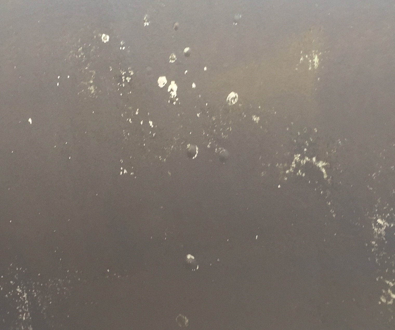

A final photo, close up of the bumps, again these are smaller than a pencil eraser.

Looks like the same thing that I dealt with after I had the bottom stripped. All the ones I opened up just went through the gel coat and not into the laminate so I simply faired them out the best that I could then applied 5 coats of Interlux 2000e barrier coat to be sure.

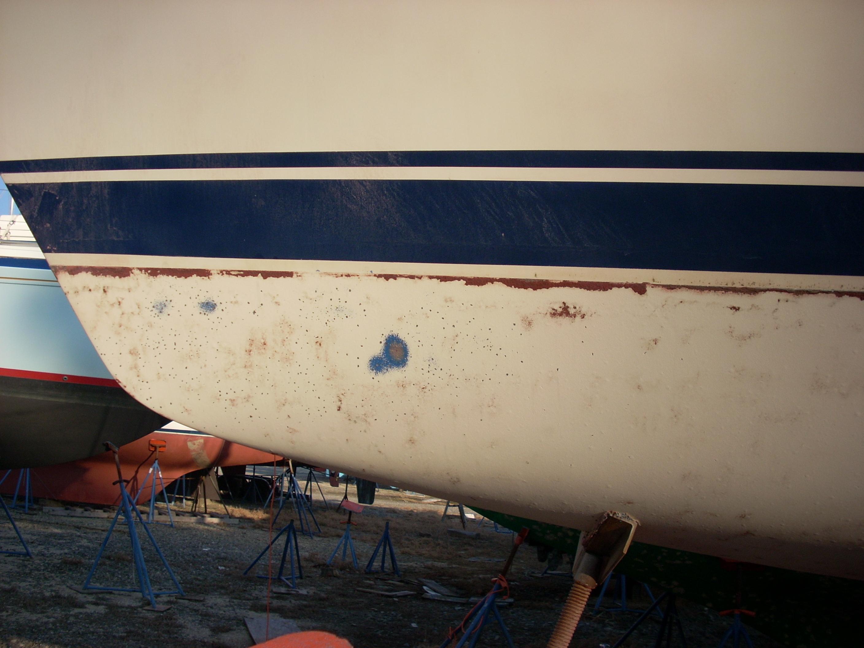

Definitely a case of the 'pox'. I must have had a thousand like this on my '34 this spring. Had the bottom blasted, sanded everything, used the West System for prepping & filling the blisters, sanded forever, 4-5 coats of epoxy barrier coat & the like. Took forever. biggest problem is that no matter how stiff you mix the filler, it sags & you have to sand. Worst job I ever did. My boatyard uses the 3M system to fill rather than West System, perhaps its easier to sand....
Sep 8, 2014
2,551
Catalina 22 Swing Keel San Diego
@SailingCal21 hit the nail on the head... It looks like a case of shallow blistering where it is only as deep as the gelcoat and not into the laminate. Do you HAVE to fix it? Not really, but since you are on the hard and need new bottom paint, now is the best time to address it.
- You only need to lightly grind them, not deep at all... a dremel tool is fine. Do this with all the paint still there so they are easier to see.
- After that, sand off or have sand blasted the bottom to get off all bottom paint and any barrier coat that may be present. No need to take the gel coat off completely, that is over-kill. Now let it sit for the rest of the winter to 'dry out'. Check moisture levels in the spring. Running a dehumidifier or small heater inside the boat could help speed things up, but don't bother with this in freezing temps.
- When you get a good 8 weeks of above freezing temps in the spring start checking moisture levels. Heat from the inside if necessary. Don't worry about rain, if fresh water goes on the hull it actually helps the process, the boat won't 'soak it up'.
- When its warm enough for epoxy and moisture levels are clear, Interlux Water-tite epoxy filler is great for filling these small ones. Its a 1 to 1 mix that is pre-thickened and a couple tablespoons at a time will fill many of divots.
- You can follow up with a fairing compound and torture board (long board sanding) if you like, but with those tiny blisters it shouldn't need it.
- Like LouisMK said, 4-5 coats of Interlux Interprotect 2000E and you will never have blister issues again. Photo document the whole process and it will increase the re-sale value of your boat. For your size hull you should use a full 3 gallons on the hull, keel, and rudder below the boot stripe. Use 1/4" nap rollers, don't use foam rollers (way too fine, will fall apart from the epoxy) and don't use 3/8" nap (way too much orange peel).
