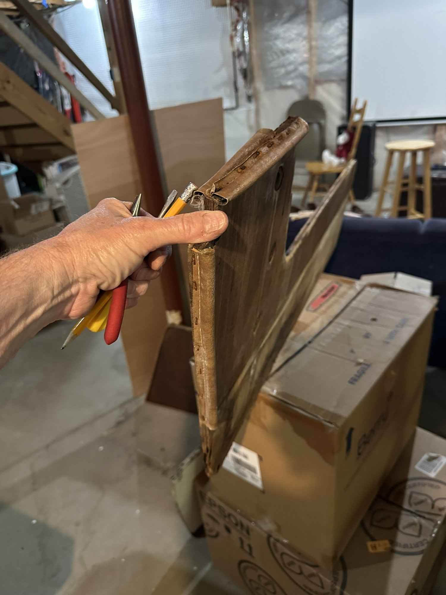

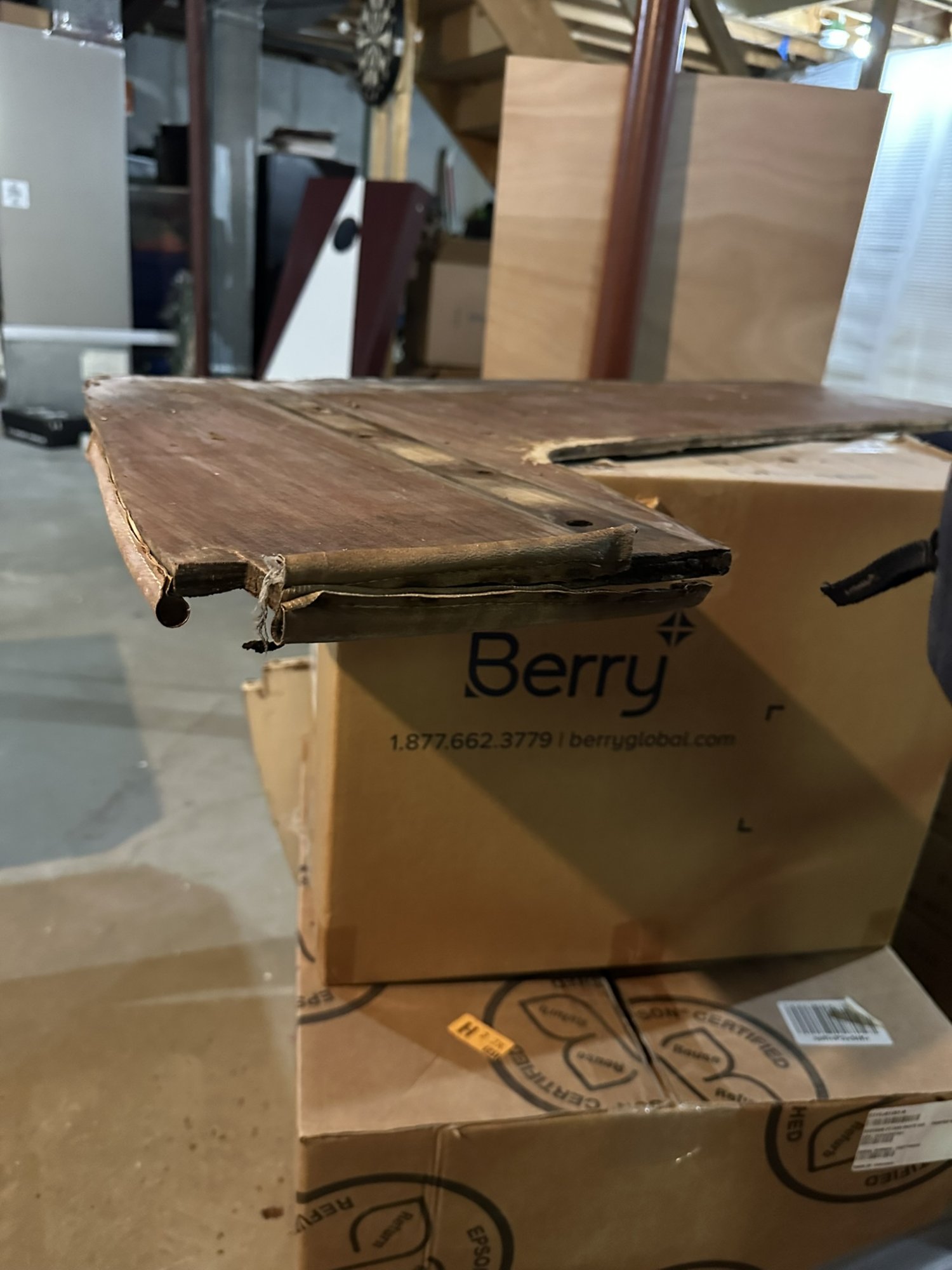

I'm replacing my bulkheads and my vinyl trim is shot. Any recommendations on a good replacement vinyl bead trim? I don't even know if what I removed was original and what it should look like. Also, don't know if it is better for the trim to match the white cabin/hull or the brown teak'ish bulkheads.
Any recommendation from those who have done this is appreciated.
