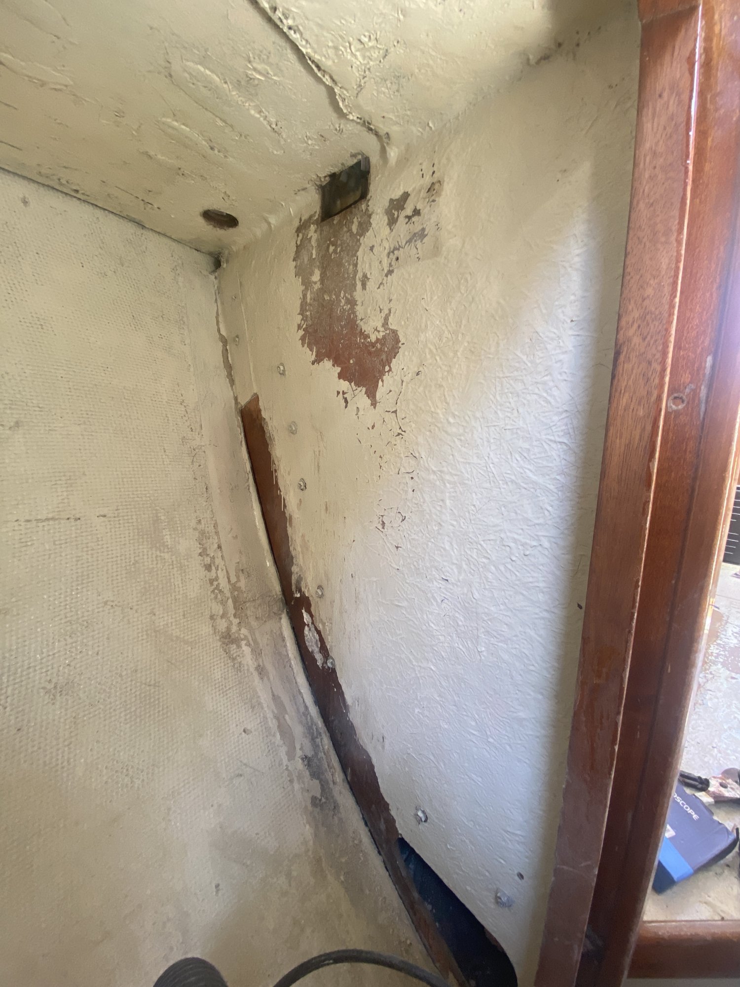

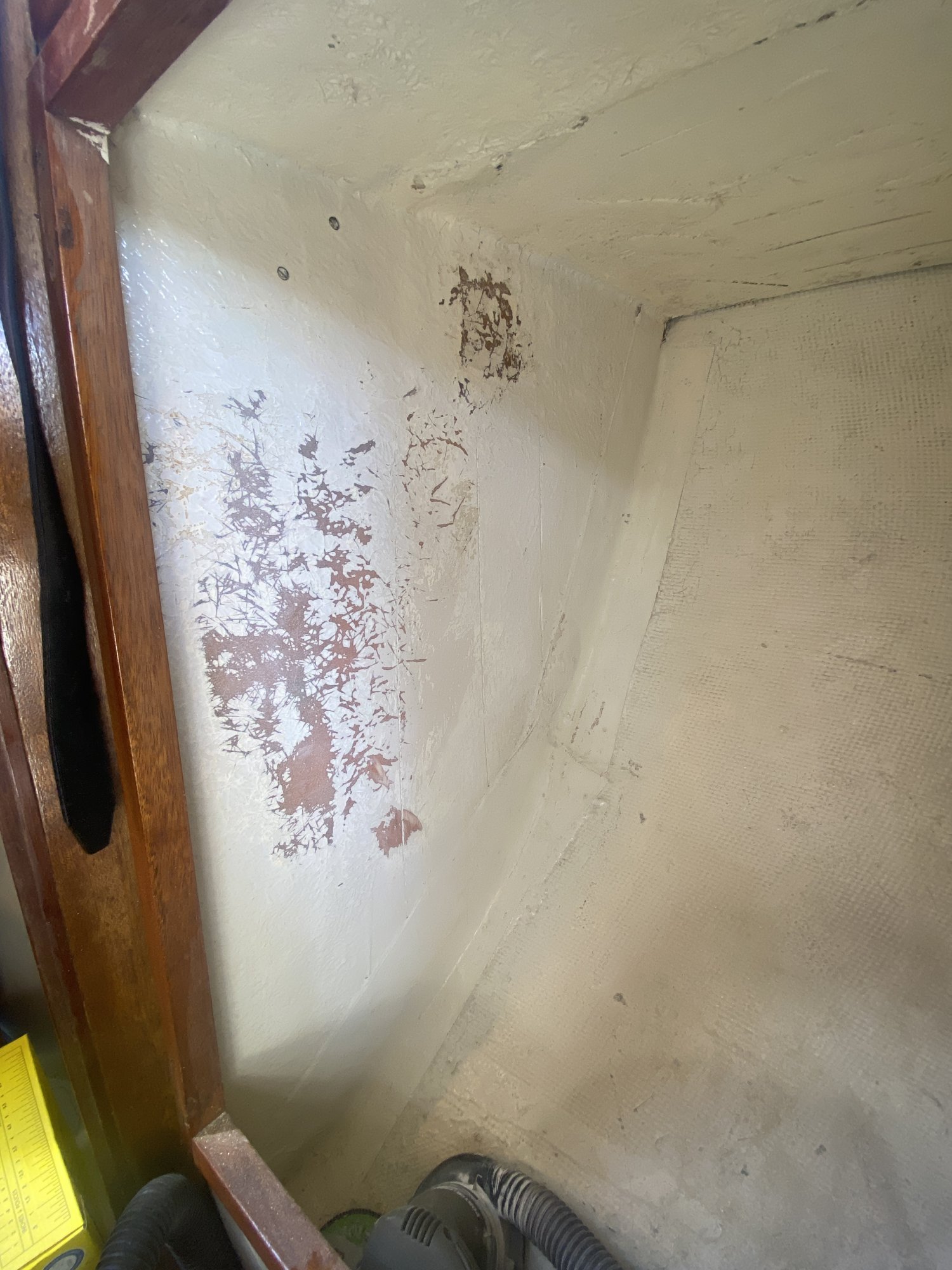

Hey All,
I have a 1972 Islander 36, and they’re known to have issues with the bulkhead tabbing. I’m thinking that the bulkheads that hold in the chainplates are too weak and I’d like to strengthen them by adding another layer of wood, then reattaching the chainplates.
I’ve seen plenty of discussions on replacing the bulkheads, but no real luck adding thickness to them. One of the bulkheads tabbing has let go, but the other one it is intact and fine.
I like working with my hands but wood and fiberglass aren’t my strong suit. To do this can I simply use epoxy and some bolts to attach another piece of wood (likely epoxied or encased in glass)? I’ll tab the new face into the hull and prep that area real well, but I am hoping to get away with just a quick sand instead of getting all the old paint off.

The first question is the shape of the bolt holes? Are they still round? Is the wood solid or are there areas of rot or evidence of water damage?
If the plywood is in good shape, I wouldn't replace the bulkhead.
The tabbing looks pretty flimsy, maybe one layer of glass. Adding a couple of layers of glass on top of the existing tabbing might be a good idea. Sand it well and use epoxy.
Adding a backing plate for the chainplates will help distribute the load better than nuts and washers. This will also reduce any movement by the bolts in their holes, reducing the possibility of the holes becoming oval.

What about a tang as a backing plate and to spread the load further down?
14,278
The idea behind the backing plate is to spread the compression load from the bolts. This in turn helps to spread the tension load from the rigging. The larger surface area will increase friction put a little less tension on the bolts as they pass through the bulkhead.
A tang with holes matching the chainplates could serve as a backing plate. Using the tang to add an additional bolt would help a little, I don't think it would be as effective a proper backing plate.
