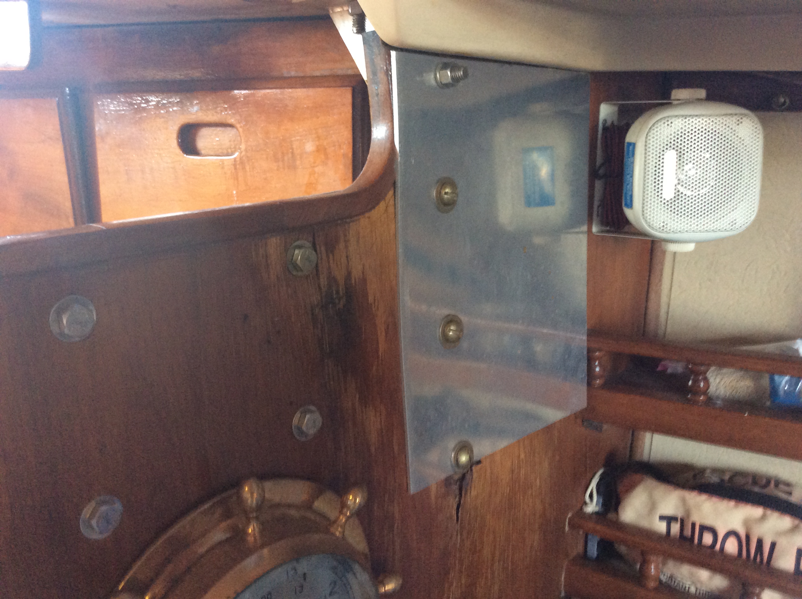

So I know this looks rough and in a attempt to beef it up before I replace it I bolted on a 1/4 in plate from both side. Only temporary. We bought this boat and had water damage coming through stay as you can see. I believe this is 5/8in material. How difficult is it to replace this bulkhead. When I get the shroud out I’ll check what shapes it in. Now we are in South west Mexico and accessing material is a bit a chore as many of you know. What kind of material should I be looking for here. They don’t carry the teak ply I know for sure. Apparently it can be brought in from US. Is a good marine ply okay for this. As Cat owners you know this is the upper shroud mount.
