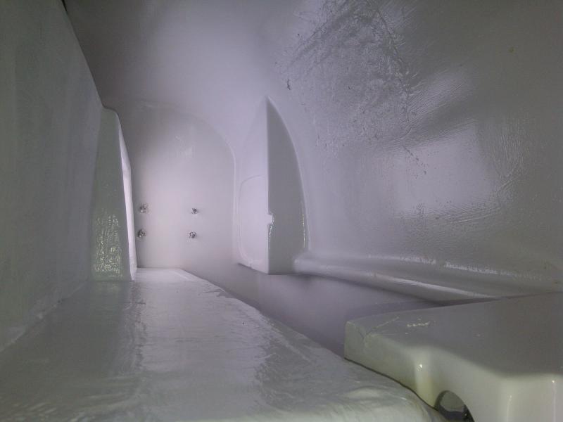

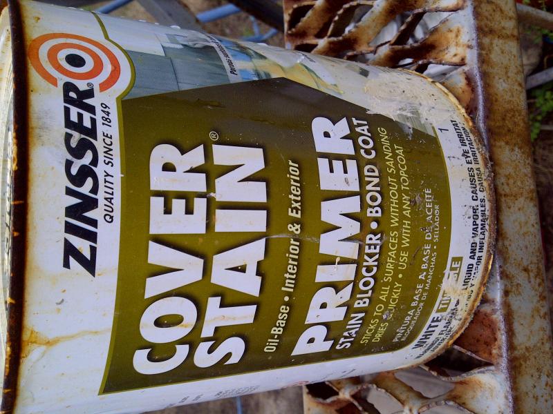

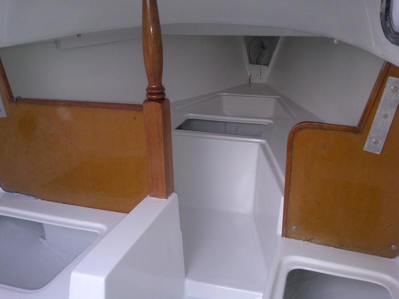

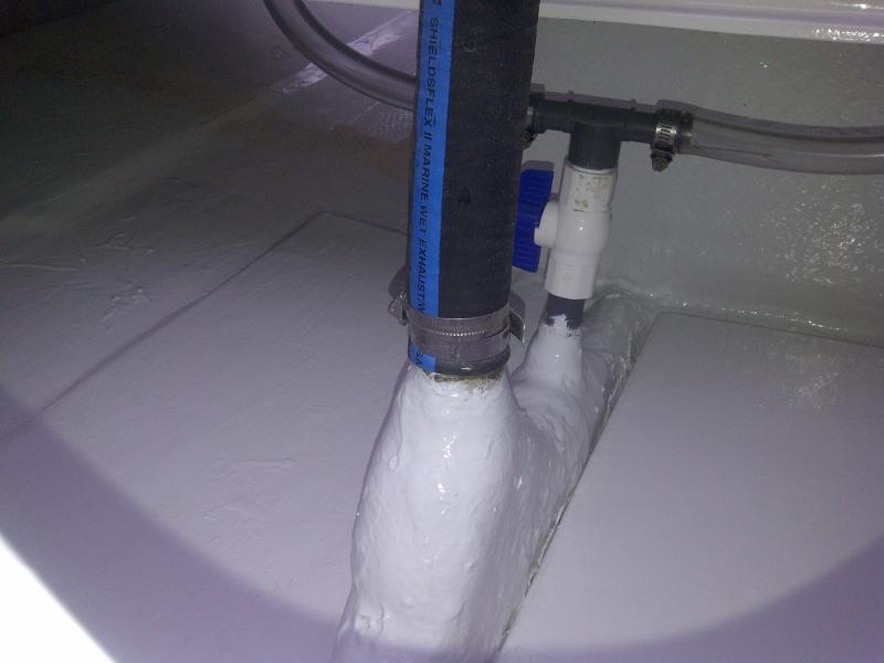

I seem to get a lot of poo-pooing about this, but after a lot of time hanging out with these old timer paint guru's, I've hit a combination that works marvelously well. I can get you the specifics if you want, but the primer is from Zinsser, Stain Blocker, oil base that dries very fast. And the paint is Valspar white floor paint. yes, Home Depot sells it, at about 22 bucks a gallon. It flows well, looks good, and you can not scratch it with a nail. I started using it in bilges, and after the results have been more than acceptable, started using it on interiors. Any paint that is designed to be walked on, has got to be tough. And it is.

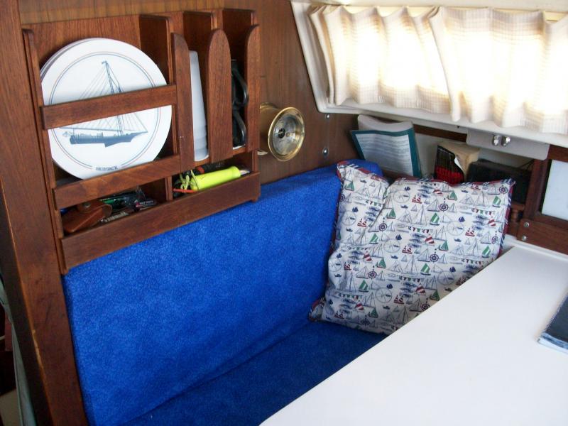

On a previous boat (41 Gulfstar) I had tons of faded woodgrain formica and we settled on coating it with Minwax stain urethane and I thought it looks really good. Paint it on with the "grain" in the formica and make sure the brush is wet enough to cover in one stroke. Small runs are better left than dabbed at as this makes it look bad. I did the lower parts of the "furniture" and the anchor locker bulkhead this way and painted the upper parts with a latex based enamel.
Looks great! How exactly does the formica take the stain? It would seem to me that it would just sit on top of the surface as formica tends to be non-porous...no? Did you put a poly on it afterward to seal it?

The Minwax product is "stain polyurethane", I'd left off the "poly" in my previous post. http://www.minwax.com/wood-products/onestep-stain-finishes/minwax-polyshades
I scrubbed the heck out of the formica with a scotchbright pad and 409, then sanded it with 100 grit. Cleaned it again after that then wiped down with alcohol and paper towells followed by a tack cloth.
It seemed to be holding up fine when I sold the boat, about a year after I applied it.

I just got sold on the floor paint because it is tough. And after using it as much as I have, it would take some very real convincing for me to do otherwise..

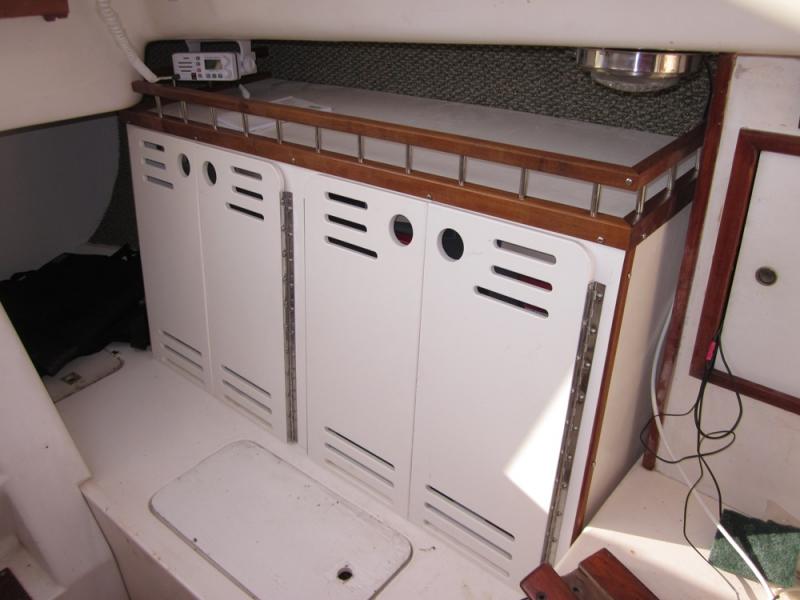

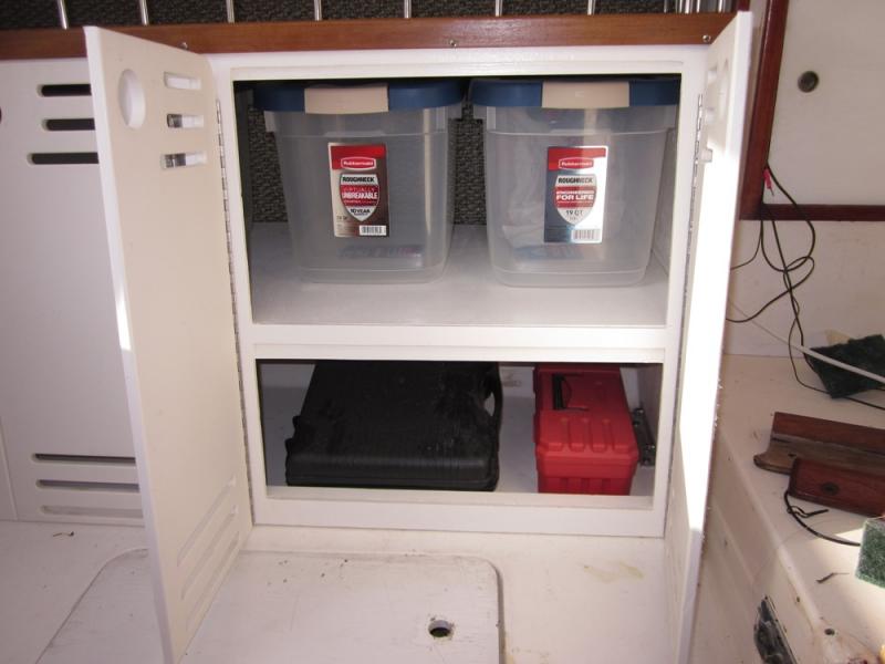

Just built and installed a seatback cabinet for the port quarter berth. This gives me a place to lean back and 12 cu ft of storage. And a shelf on top for clutter.

Very nice work!!

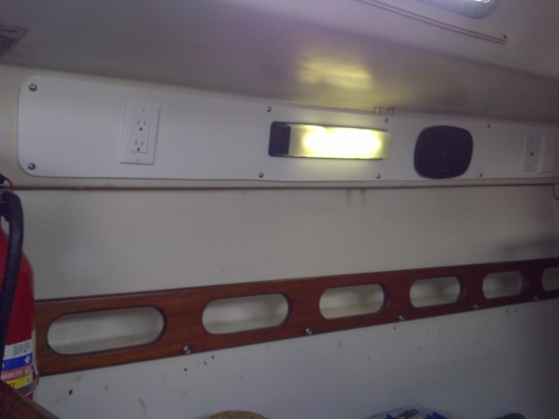

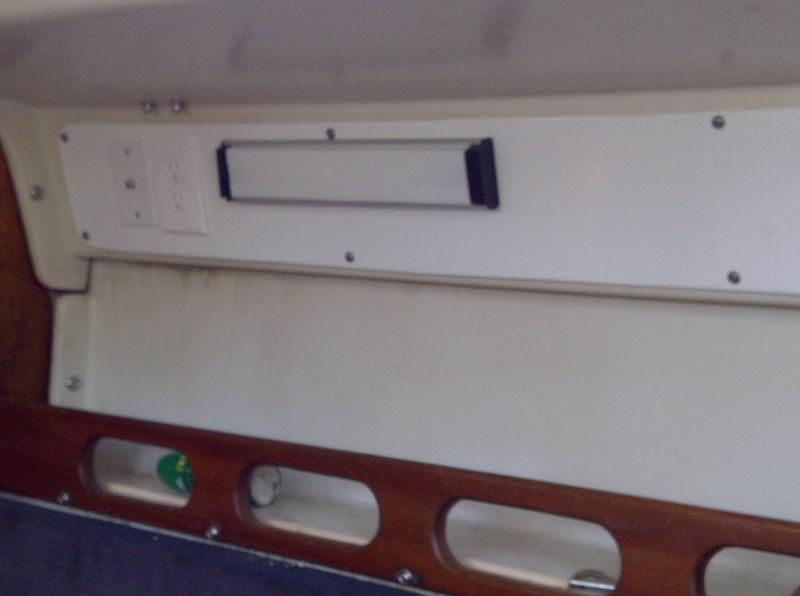

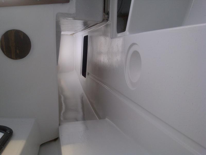

That is a groovy looking boat man. I like the white. My Ericson had all that dark mahagony inside, that reminded me of a coffin, or a New Orleans cat house or something. Depressing. I know a lot of people like all that dark wood, and that is great. Just not me. So, I took down and replaced all those raceway panels, and did the white. And I did the entire interior of my Catalina with it, except the bulkheads. It looked like a new boat inside. With a foam roller, I swear, it looks sprayed it flows so well. Now, it dries a little slow, so don't get alarmed. The guru's said to add a little Japan Dry to it, and it'll speed up the process, but I've always been under the opinion that the slower it dries, the harder it gets. I guess. But I do know that after a year in the floors, bilges, headliner, you name it, there is virtually no sign of it wearing. And it ain't like I'm gentle with it either.

That looks sweet Chris! I think I am sold!!

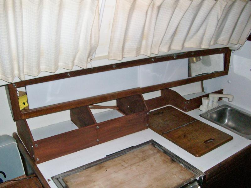

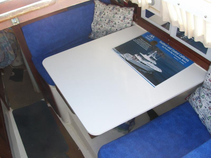

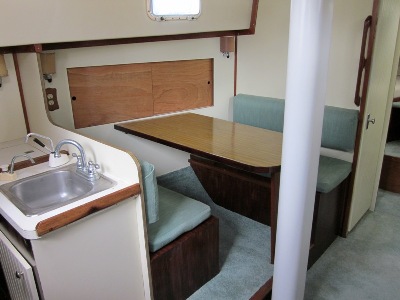

I had a lot of ugly wood formica laminate.. the countertop and the dinnette table. Rather than replace with teak or granite (heh, heh) I chose to paint over it with a high quality, hard enamel. My boat neighbor, a professional finish painter, directed me to an excellent primer made by Enduro that worked really, really well. It's a water based product that you can find in high end professional paint supply houses. Three or four coats over the dark laminate was needed before the oil based enamel top coat goes on... you could use any high quality enamel...then cover with a polyurethane clear coat for a hard shell finish.
The secret is using a primer that is designed for application over laminate finishes.. it leaves the proper texture for the paint to adhere.
After the table, I painted the counter top... then was inspired to build the cherrywood bins you see in the picture. Totally changed the atmosphere in the cabin... after these pics I refinished the butcher block stove top and ice box lid for an even cleaner look.
Looks fantastic Joe. Now..where to find this paint in NH
