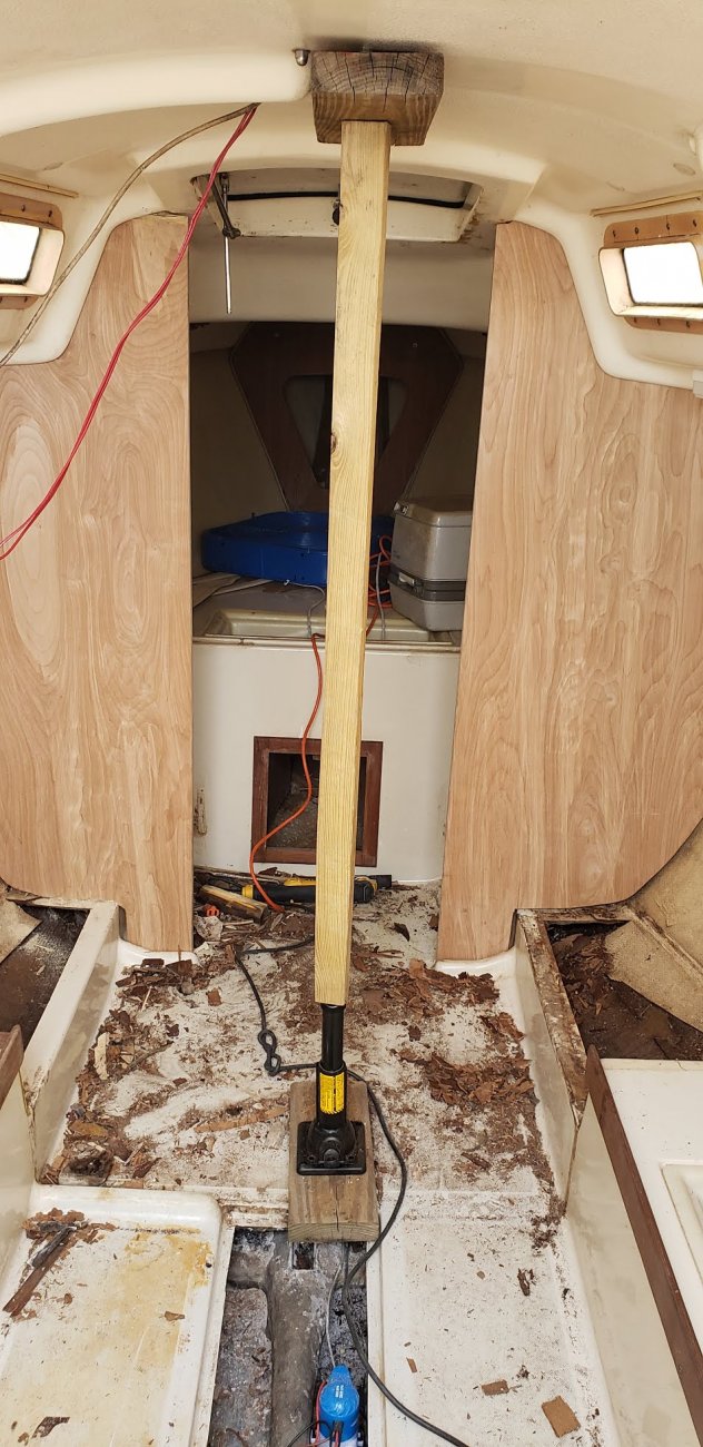

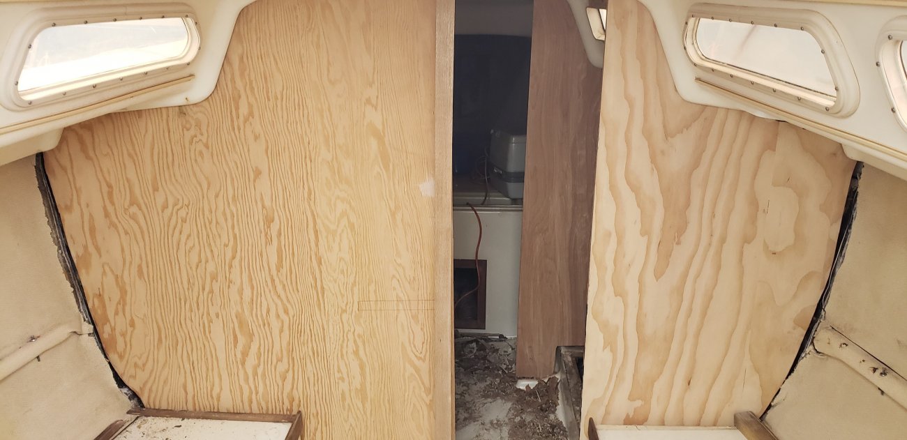

After a long weekend I have the new bulkheads installed but not glassed in. Just ran out of steam. It can be done in a weekend I believe this now.
Compression post was cut from rough White Oak to a true 2x4 size and reduced in size to fit the keel spot
Did use 3/4 Marine ply for the bulkheads, purchased from Siewers lumber in Richmond,VA
3 sheets total so far.
Lessons learned.
New Favorite tool Dewalt Oscillating saw, saved me so much trouble with the small corrections to my my templates.
Second new favorite tool electric planer, made fitting them in place so much easier and faster.
Bring your patience , move slow, think slower and it will all come together.

Nice work! I'm in the process of replacing the bulkhead myself. Just waiting for the weather to warm up right now. Do you have any recommended methods to help find the "high spot" that needs to be cut/grinded away when fitting the new plywood or is there enough visibility on the fore side of the bulkhead?
Jan 29, 2019
37
O'day 25 Virginia
Honestly I used the old bulkheads and ground down a little at a time did a test fit and repeated till it fit nice.
Sep 24, 2018
4,702
Catalina 30 MKIII Chicago
I was planning on using an angle grinder with a flap disc to grind when fitting. Do you think the oscillating saw would have any significant advantage?
Jan 29, 2019
37
O'day 25 Virginia
Maybe maybe not. If I had brought my angle grinder that would have been my plan as well. But I grabbed the planer instead. Also ended up using the oscillating saw with a sander attachment for the curves
To clarify I used the oscillating saw for the fine last minute adjustments once the bulkheads were semi installed, Since my old bulkheads were pretty much trashed i ended up guestimating the bottom edges so they needed some refinement for better fit
Sep 24, 2018
4,702
Thanks for the info. I traced the old bulkhead out and the plywood is awaiting cutting and staining. Do you have any other tips or advice for this job?
Jan 29, 2019
37
O'day 25 Virginia
Jacking up the top of the boat helped a ton in getting the new bulkheads in. I did mine roughly 1 inch, your results may vary. Be careful not to crack anything. There were lots of scary creaks and groans as we moved the bulkheads into place. scared the crap out of me a couple of times lol. Good Luck. Post pics please we all want to see
