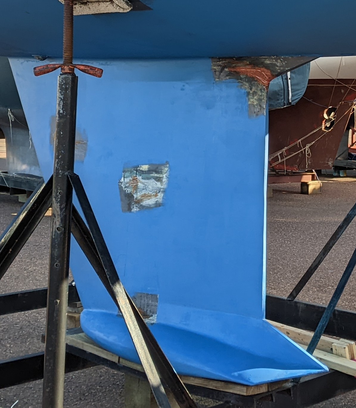

We own a 1996 Hunter 376 with a full draft (not-shoal) lead keel. We're based in Wisconsin on Lake Superior, so the boat gets hauled out each winter. The boat was new to us in 2021, so we're going into our third season.

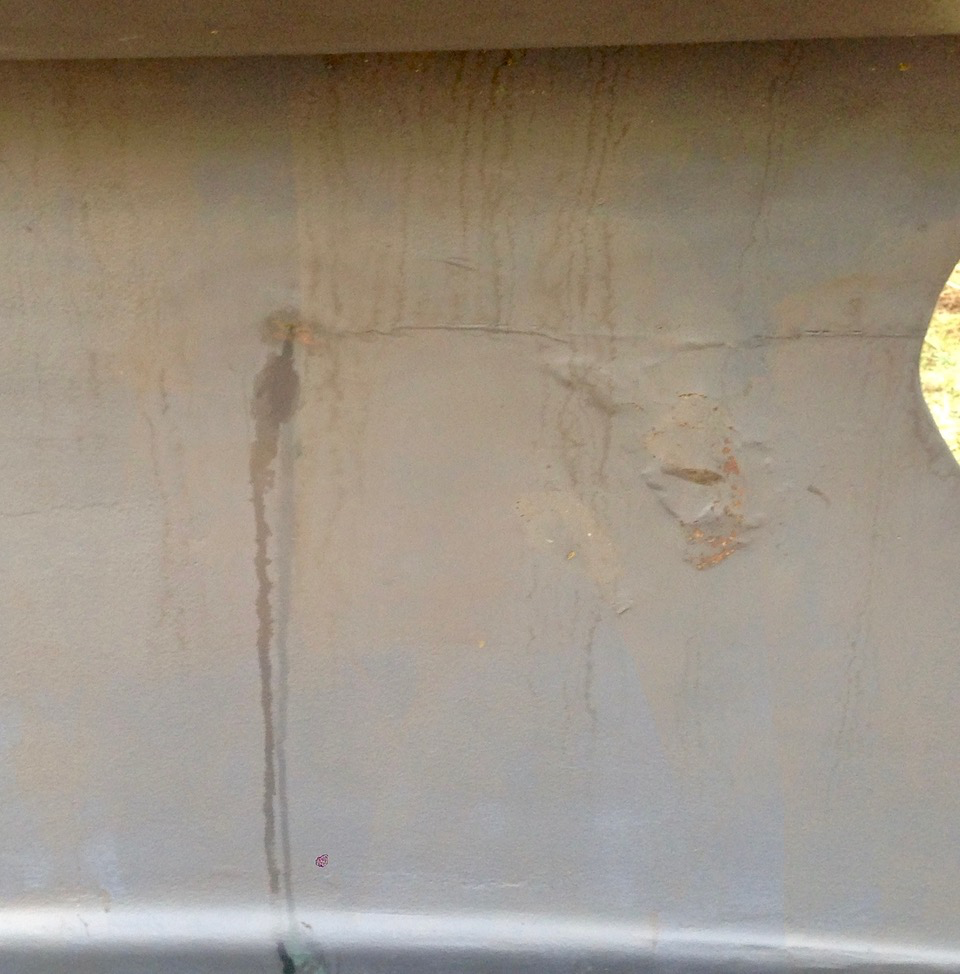

Last year I noticed a few hairline cracks at the hull-keel joint. No water was coming in through the keel bolts into the bilge, so I V'd out the crack and sealed with GFlex assuming that the cracks were probably from the keel having flexed some. I also noticed that we had a couple of bulges down toward the bottom of the keel (extending above flat by maybe 1/4" over an area about the size of a softball). I assumed that maybe some water leaked in between the fiberglass and the lead and bulged when the hard freeze hit.
Last season I took the drill and put a little hole at the bottom of the bulge, assuming that this would drain any accumulated water. However, I found that the coating on the keel was only about 1/8" of epoxy (maybe less) with no fiberglass or other filler type material. When drilling there was no gap between the coating and the lead, and no water came out. I filled in this gap with GFlex, we launched, and had a good season.
I wasn't present for haul out or winterizing last fall (an unfortunate incident involving stairs and broken bones two days before our scheduled haul-out date), so did not get to inspect the bottom of the boat pre-winter. We made it to up to the boat to uncover last weekend (it's been an eternal winter), as I was inspecting things I noticed another bulge in the keel (in a different place). Now, it's been a year, so I THINK it is a new bulge, although I'm not 100% certain--there is a chance that when I drilled l last season and didn't find water I just left this bulge and didn't touch it. That said, I'm wondering if there is action to be taken. The bulge(s) are low on the keel, so no where near keel bolts or where the keel attaches to the boat. I don't see any bulges on the bottom of the keel or on the wings. The GFlex that I used on at the keel joint looks solid (no cracking, everything in place) as does the GFlex I used to fill the "drain" hole.
My questions:
What exactly is the coating on the lead keel for the 1996 vintage hunters? Is it fiberglass or epoxy? Is it just a thick paint? Is it even possible for water to have made its way between the lead and that coating?
The bulge is down low, so I don't think there is any potential of impact to the hull/keel joint. But it certainly feels like there is water in there somewhere. If I knock/press the bulge is solid--this isn't a blister. I'm just not sure as to action to be taken and haven't found a lot of specific info about how these keels are constructed. I'm mostly wondering if I have an action step here before launching in a few weeks.

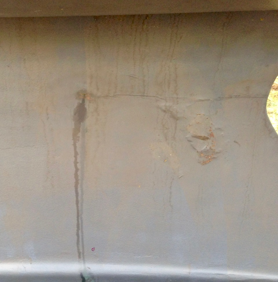

I was looking, I found a picture of the repair last year. The bulge this year is at a similar level but on the other side. Correction, I just did my mental math, the bulge is on the same side, but perhaps a bit lower, under the repair from last year. I can't tell based on this pic, but I don't think that this year's bulge was present last year.

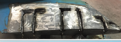

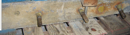

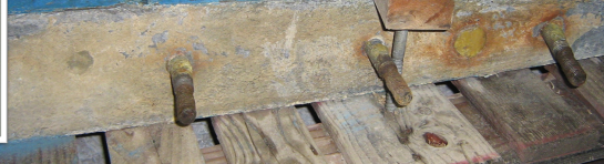

See attached for photos of keel bolts with vertical strips of part of the lead keel removed for bolt replacement, and how long the bolts often stick out of the keel to go through the keel sump

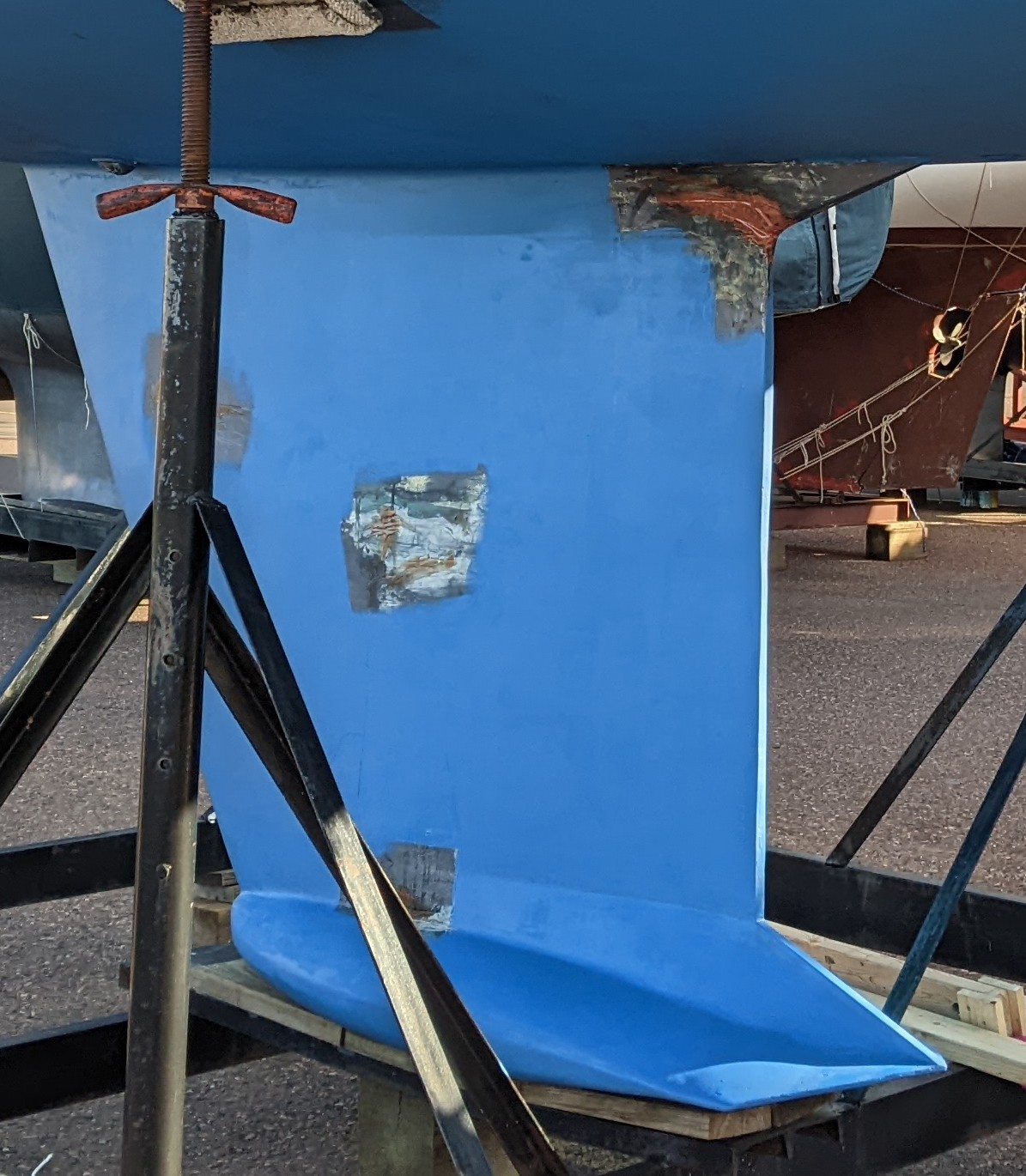

Also blue keel picture is a long shoal draft keel.;)

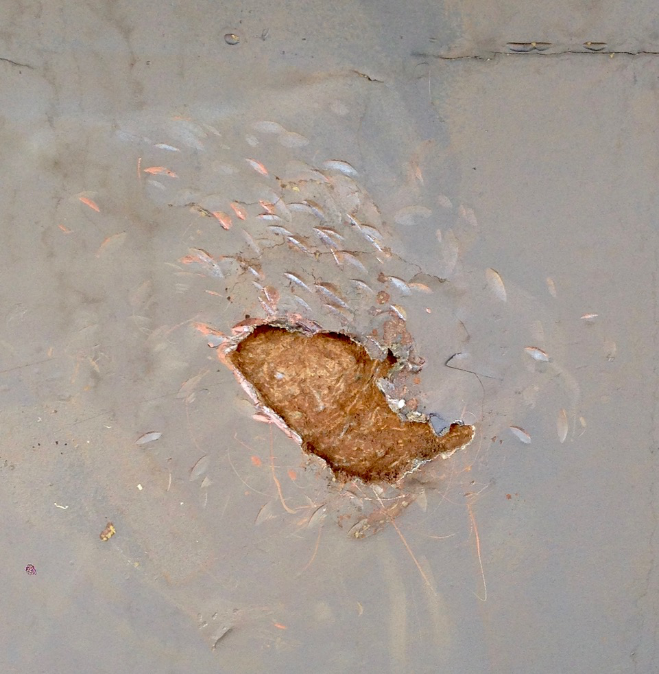

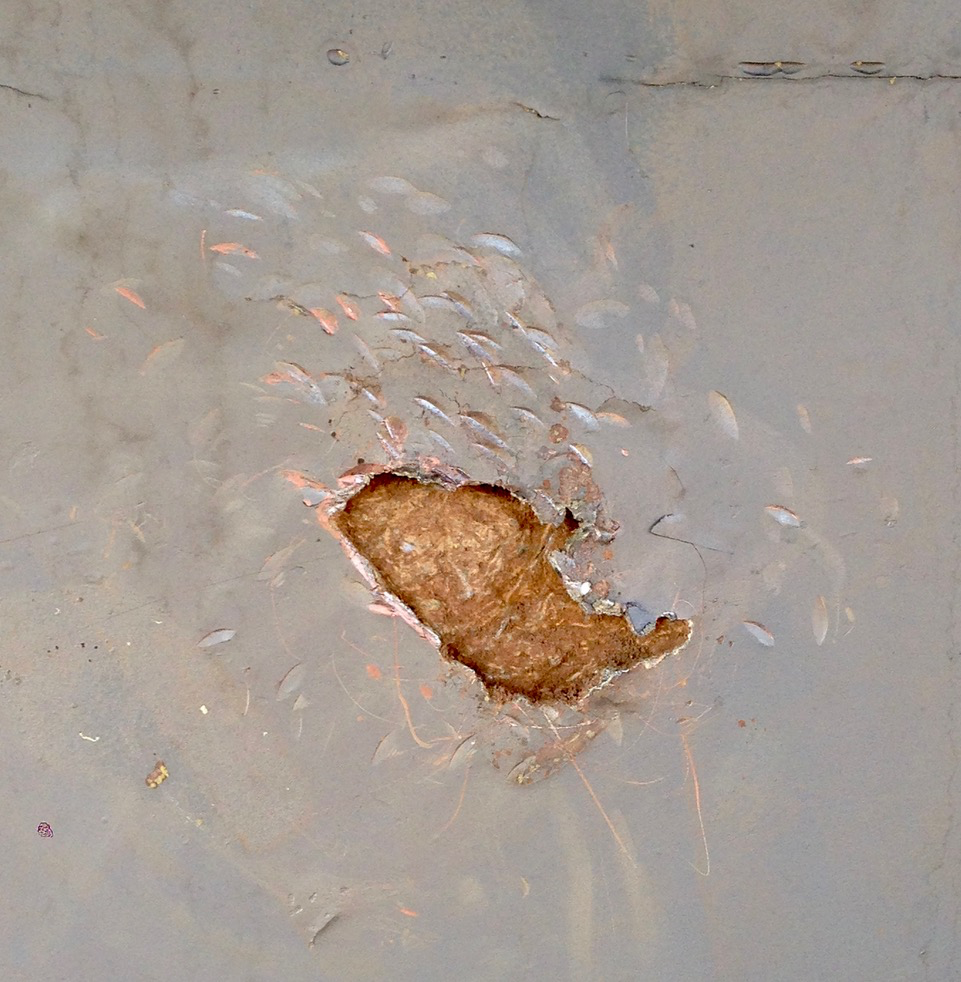

When cast lead keels come out of the sand mold, they are pretty ugly. Boat builders use a lot of fairing compound to smooth over the ugly bits, that's why there is no glass on the keel.
Odd things also happen in the foundry. This photo looks a little like the photo of your keel.
After some hammering and exploratory surgery this is what I found.
Some of the casting sand had fallen into the lead. Eventaully some water found its way in there and over many winters had caused the lead to bubble out.
The repair was straight forward. Clean it all out, wire brush it and immediately coat with neat epoxy. Then fill in with multiple layers of thickened epoxy and finally a coat or two of epoxy fairing compound. The repair was completed in 2016 and the only evidence of the repair is the better fairing job on the repair than the rest of the keel.
For the long crack between the keel sump and the keel, check the torque on the keel bolts and retorque them to specs. Over time the caulk compress and the forces on the keel cause this type of crack to form. Water can get behind the sealant, which is what happened in the first photo.

The great thing about a "long shoal draft" is it'll always find the bottom before the run of the mill "standard" shoal drafts. :)

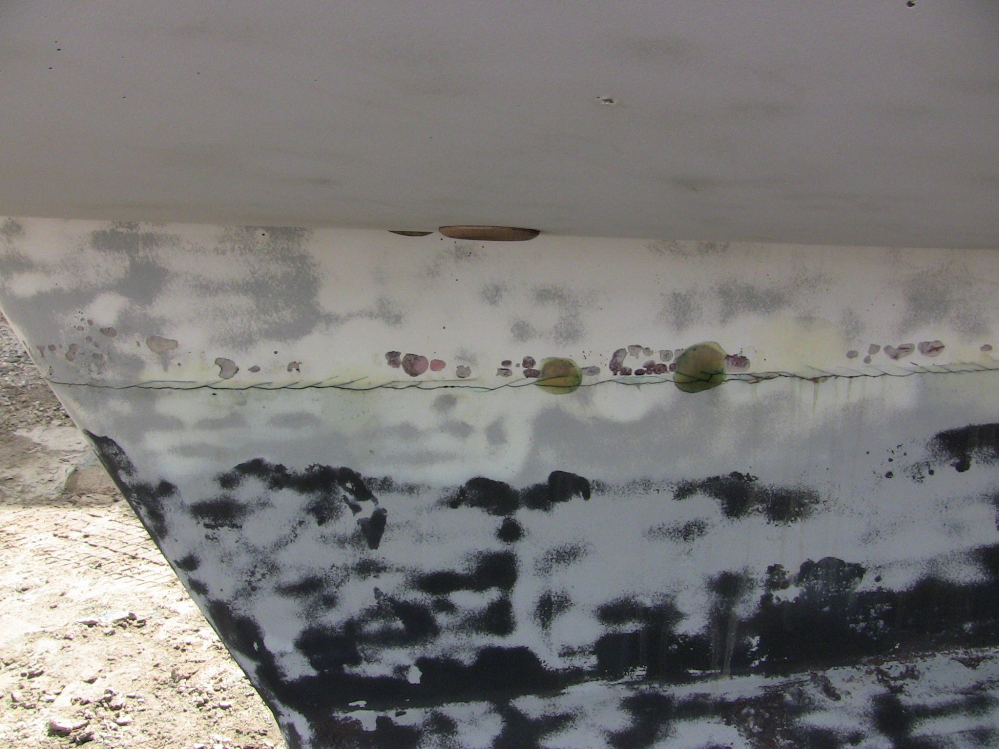

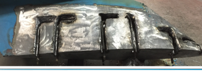

Like this?
Lead keel to boat Fiberglass
