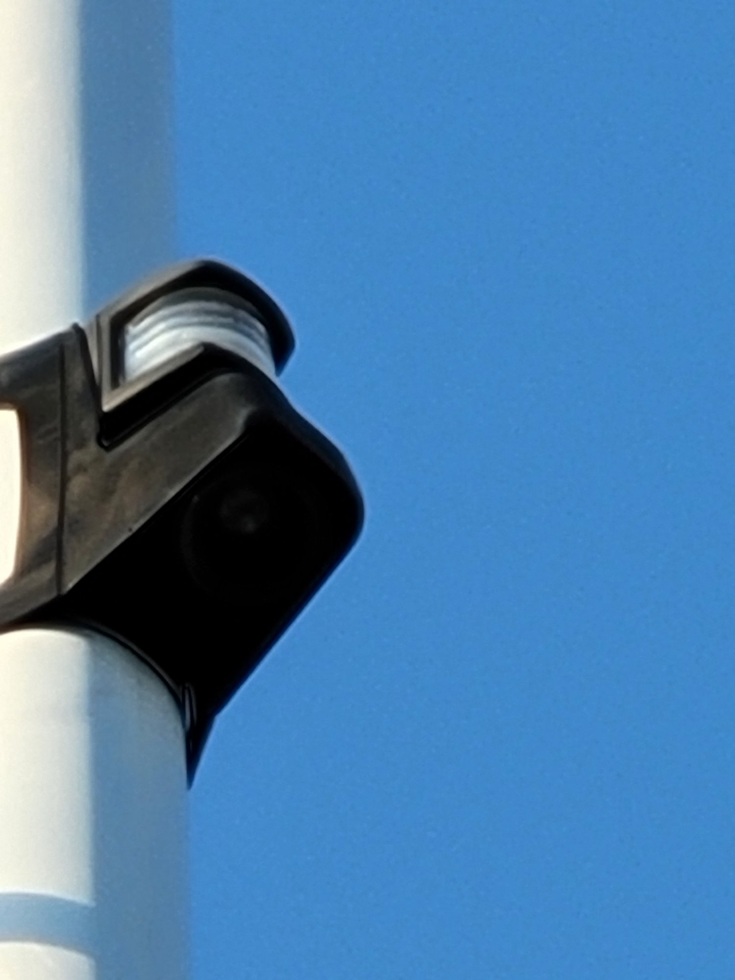

I have a 2001 310 with what I assume is the original deck / steaming light combination. My mast is up so I cant tell what the make of the light is and I don't have any documentation on it. Has anyone replaced the bulbs? What did you use, and where did you get them?

No, that is the deck light/steaming light. The anchor light is at the top of the mast and radiates 360 degrees. There is a drop in LED replacement. I have one and would provide the specs, but I cannot access my computer at the moment
