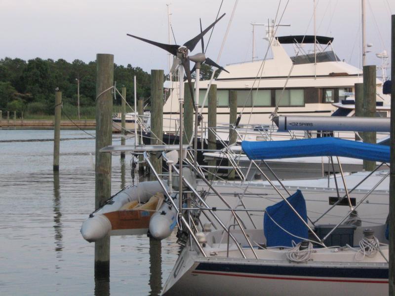

I am guessing one made from conduit would look a bit ghetto and not hold up long more from flexing than UV. I bought mine on EBay for 500 and modified it to fit, I would suggest you look onto that option. I had to look for a long time to find the right one but was worth it.

3" pipe will be nearly 3 1/2" O.D., which would make it look more like a roll cage than an arch I would think.
(Wayne, is that Tortuga in the background of that photo)?

Chris not sure which boat you are talking about, but the answer is no as none of them are named Tortuga. Phot was taken 2 years ago in Wilmington Marine center.
