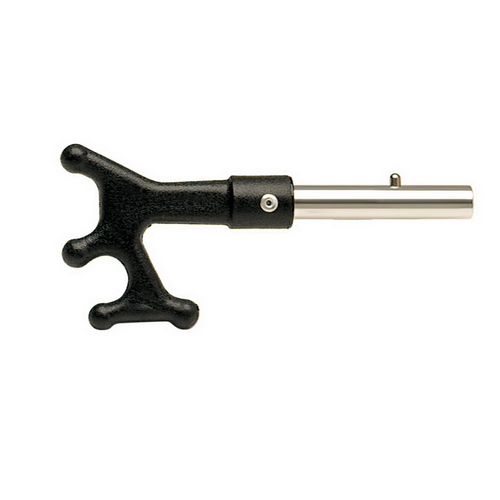

I add this to my kit bag 2 years ago when I started to land at docks in Canada where they use "Bull Rails".
Easy to store and very effective. Watch your fingers.
Very good tool for the application you mention. But I'd not want to throw this one into another boat, or my dingy, and for someone to catch it, might be very tough on hands...
