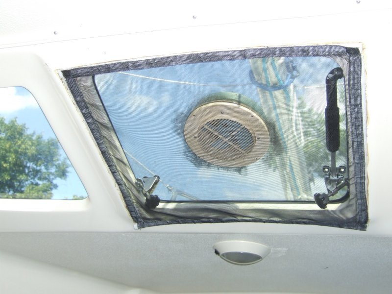

Velcro
Glue Velcro around the port (because the glue that comes on the Velcro doesn't stay). Sew Velcro to the screen material. Done

The screen and Velcro approach seems like the way to go on the front hatch.

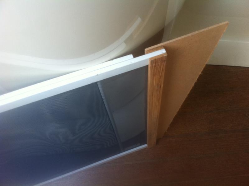

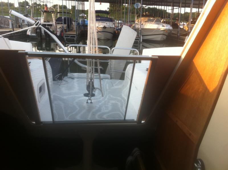

I wanted to share this idea - a PO made these, so I can't claim credit. You can see these are adjustable-width screens with some light plywood cut to the angle of the cabin door. There are 2 of them and they stack on top of each other to fill the opening - I put a rolled towel between the cabin roof and the top one as a simple seal. They are great, but probably need some more careful construction, maybe foam, to complete a seal (e.g. note small gaps at bottom corners) for really harsh/aggressive mosquito environments.

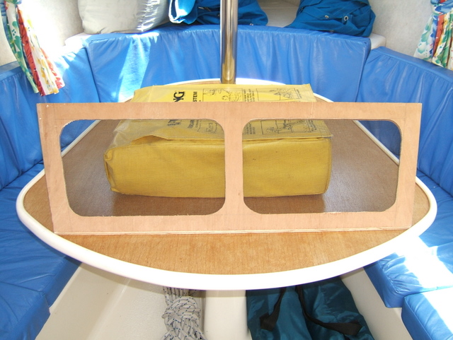

Hatch screen
Two pieces of 1/4 plywood, plastic screen material, silicone caulk as glue.
And we also have 2" masking tape for the gaps but it's only needed in the North Channel!
