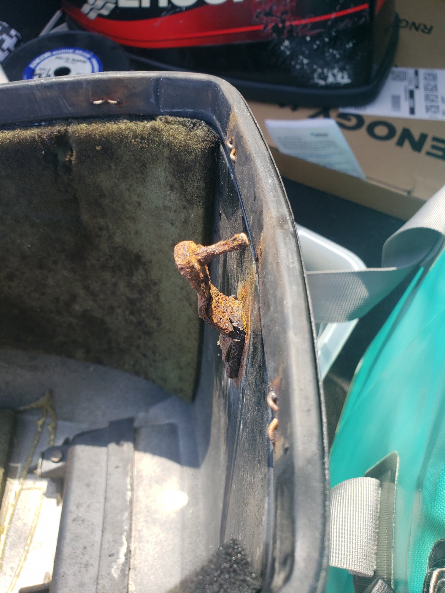

Mercury, in their infinite wisdom, made the top cover latching parts of plain steel. I imagine they were powder coated, but - Geez! Here's what I found:
What utter crap!
A new one is $26. I might just make my own from stainless steel.

What utter crap!
Yikes!
Well, at least the part is still available.
Good luck.
