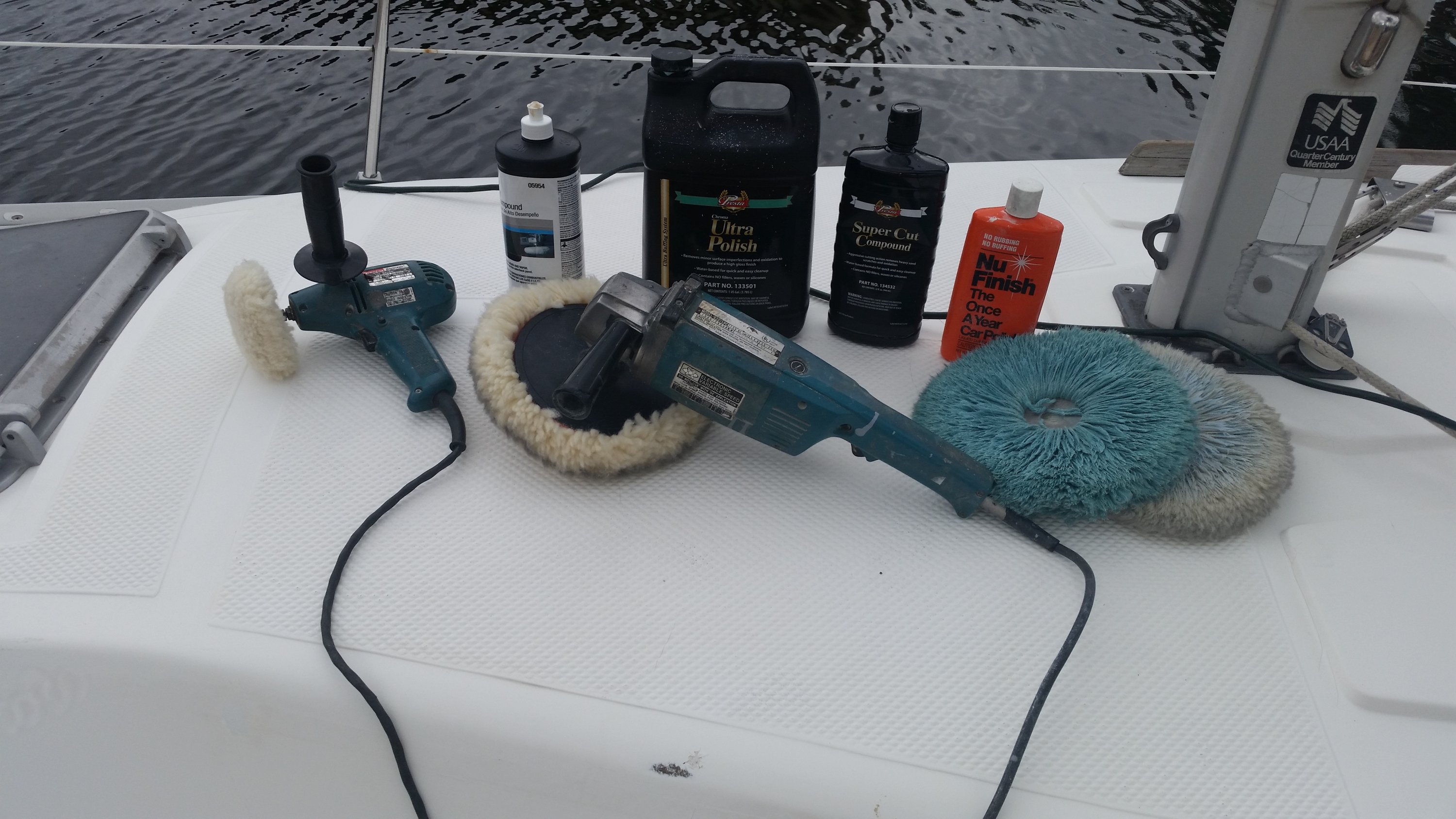

I found a small Makita GV5000 rotary sander, and switched it to a wool pad. Worked great on the tight spots. just takes longer than the big boy.
I just picked up another of the same one at a yard sale so next year I don't have to switch pads as often. Good pads cost almost more than a used tool.
Here is one on Ebay Makita GV5000 $38
