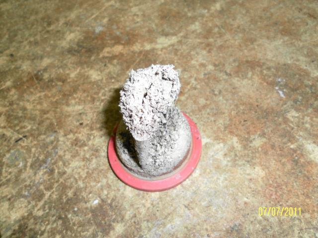

My first thought was mineral buildup in the head discharge line that's reduced the diameter enough to create enough backpressure to cause the symptoms you describe. You're in fresh water, but that doesn't entirely rule out mineral buildup...just makes it hard water, not sea water minerals. Not only can they build up in a hose, they can also build up on a joker valve (see photo...this joker valve was removed from a toilet on Kentucky Lake).
Whether that's your problem or not, if it's been more than a year since you replaced the joker valve--I'd bet you've never replaced it), it needs to be replaced anyway, 'cuz if it's as worn as I suspect it may be, it doesn't have to be mineral encrusted to cause the symptoms you describe. So remove the discharge fitting from the pump and replace the joker valve. Search the HM forum for "Joker Valve 101," author, me, to learn why, and why joker valves in manual toilets need to be replaced annually, rebuilt every 5-6 years.
