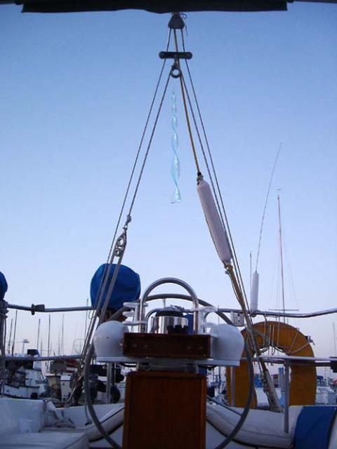

When I remove the pedastal to powder coat it, I am going to reinstall it forward 9" to a 12". I don't like the backstay hitting me in the head. I'm 5'3", I can't imagine how uncomfortable standing behind the wheel on my boat was for a 6' tall guy. Most of these guys say they don't stand behind the wheel though, probably because they have an autopilot that they use while sailing as a third hand. I like being behind the wheel. I think I would like the wheel forward, the winches back some.

Hermit, do you have a split backstay or a single? One thing to consider is to install a split backstay and raise the split high enough to avoid the head knocking. That's what I did.
I have a split backstay. I thought of moving the split up and putting a spreader to give a little more room. I see other boats with a single backstay going to one side. I would be fine with that. But I don't think one of those chain plates in the current configuration are designed to hold that load. my other option is to run two back stays all the way to the mast head.
I broke my backstay last year and have replaced the top part with a 1/4" high density polyethelyne winch rope. It has a cowhitch (or larks head) at the top and a double buntline hitch at the bottom. IT has worked OK but I find the split backstay tensioner has been creeping lower and lower. The knot is slipping or the rope is stretching so it's time to fix it for real.
I have been flirting with disaster for a while, time to replace all standing rigging except the forestay which I just did a few years ago.
