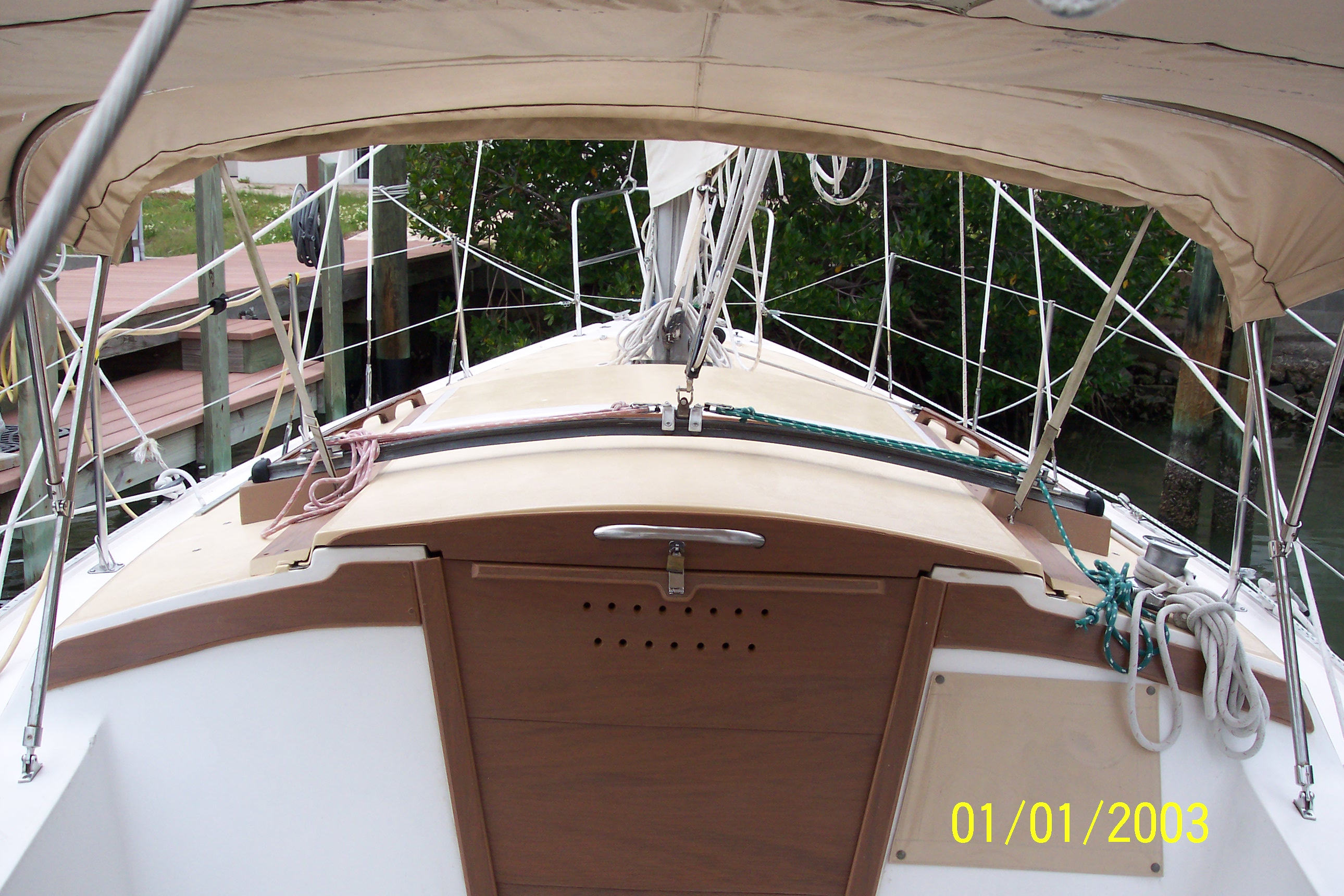

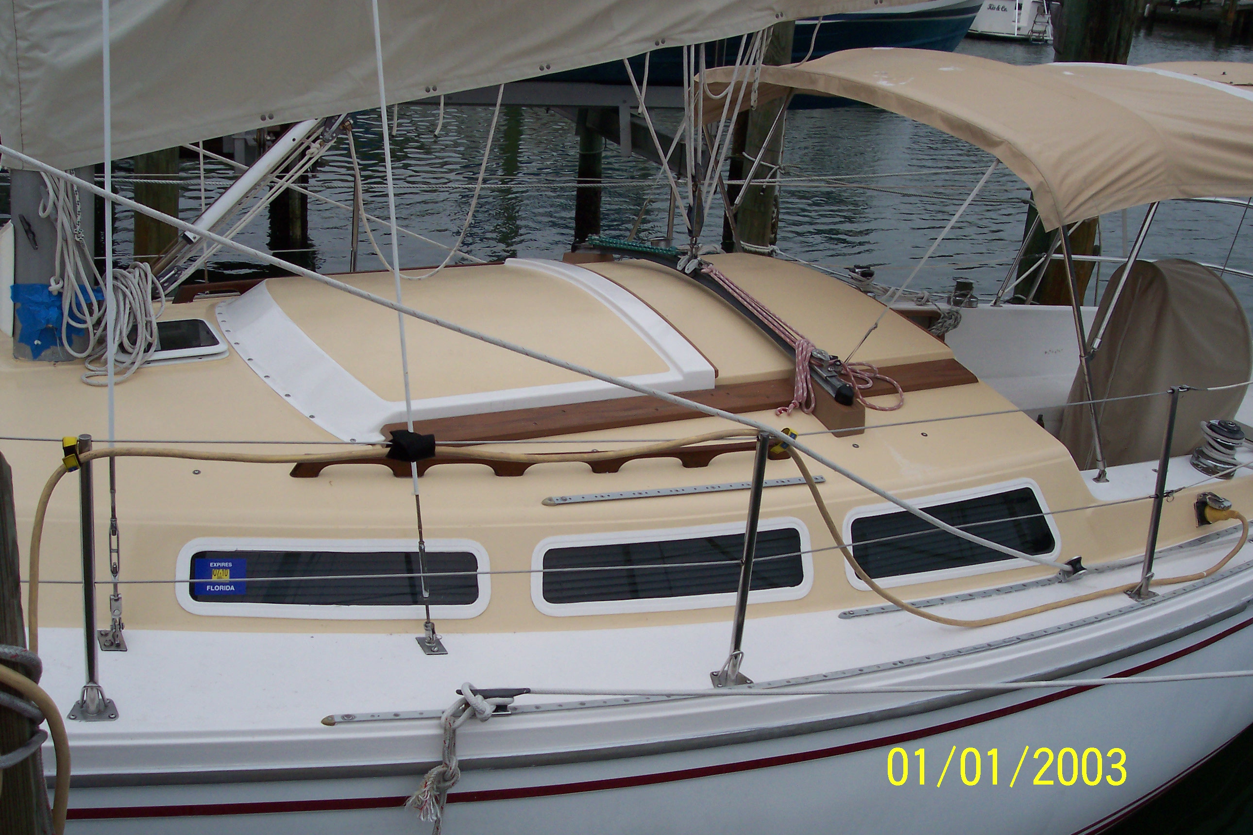

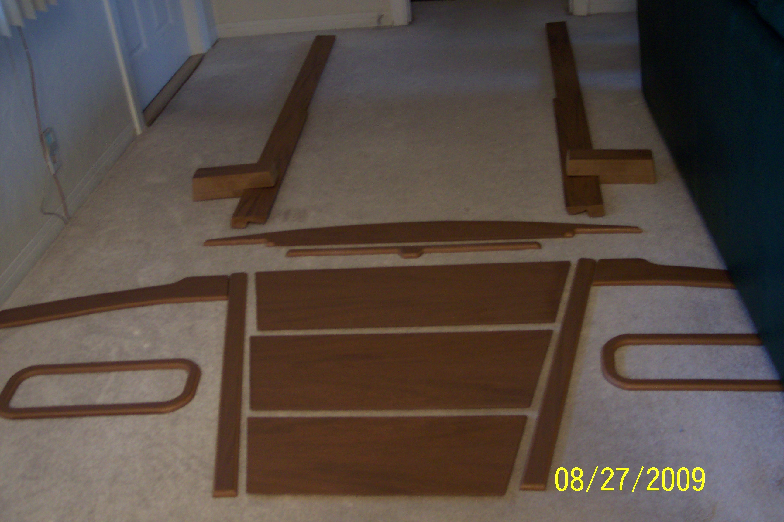

There are several PVC materials/brands you can use. CJ used Plas Teak & I used what was called Sensibuilt.
The company is called Fiberon now. I did my deck using their decking boards & fascia boards.
Between the two, I was able to make all deck wood sans the handrails. Here is their link & some pics so you can get an idea.
