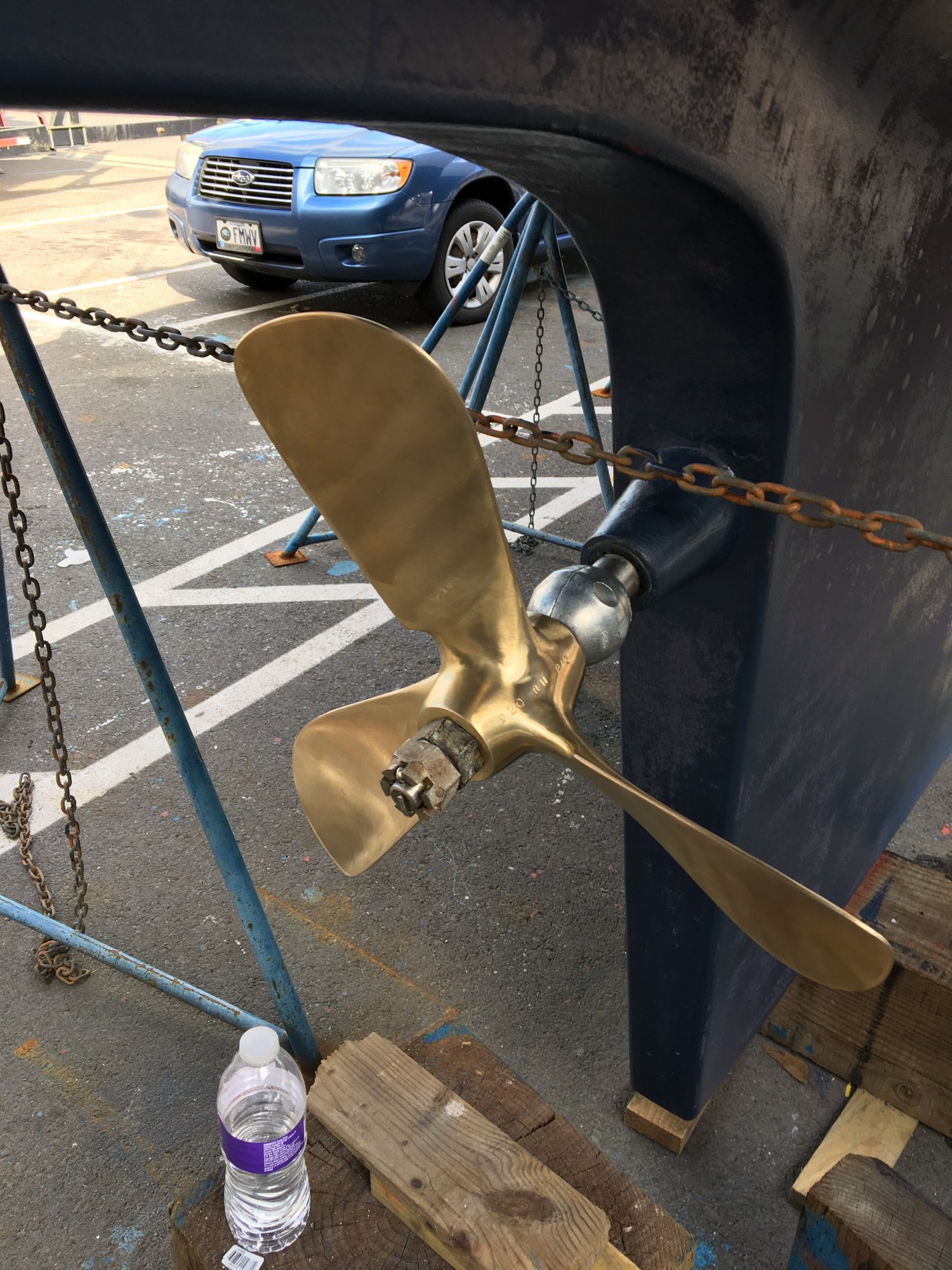

In March of 2018, this is what the prop looked like

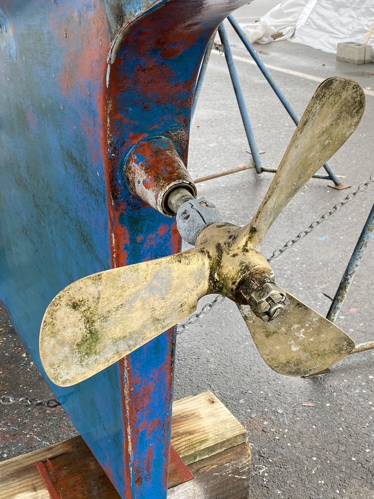

In February 2023 this is what it looked like when I hauled the boat.
During that 5 year immersion in brine/salt water, I had the hull cleaned by a diver about 3 times a year. I replaced the zincs on the prop shaft aprox every 7 months depending on the divers remarks about the zinc condition and the appearance of the prop. I kept a zinc available for the diver at each cleaning.
On close inspection the prop is looking great. Your experience may vary.
I'll be taking it home. Cleaning the green slime from the blades. Running it over a buffing wheel and reinstalling it on the new prop shaft.
