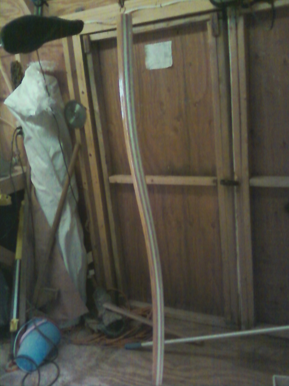

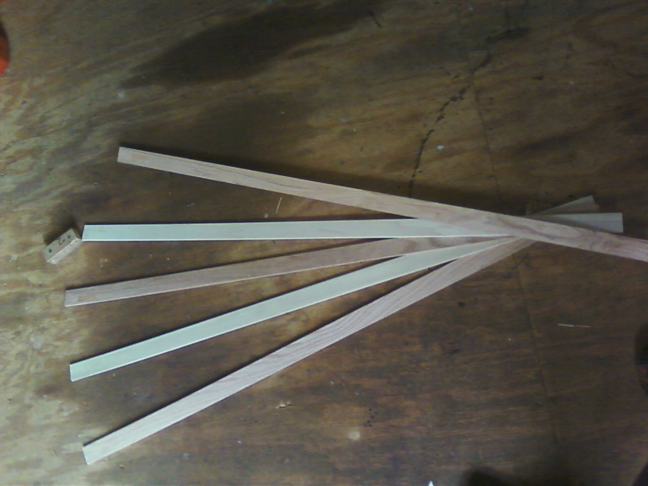

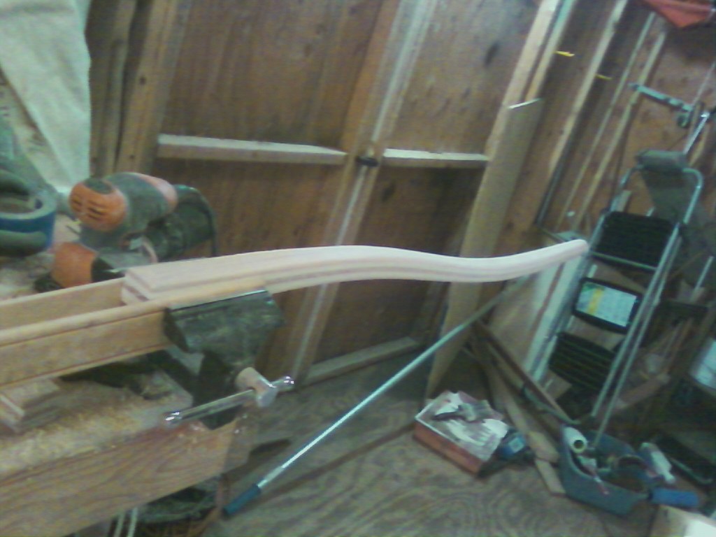

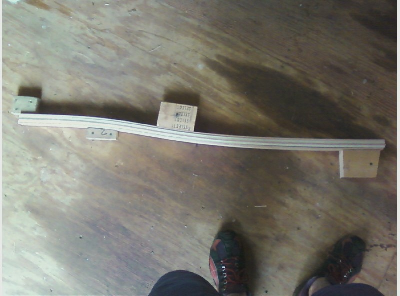

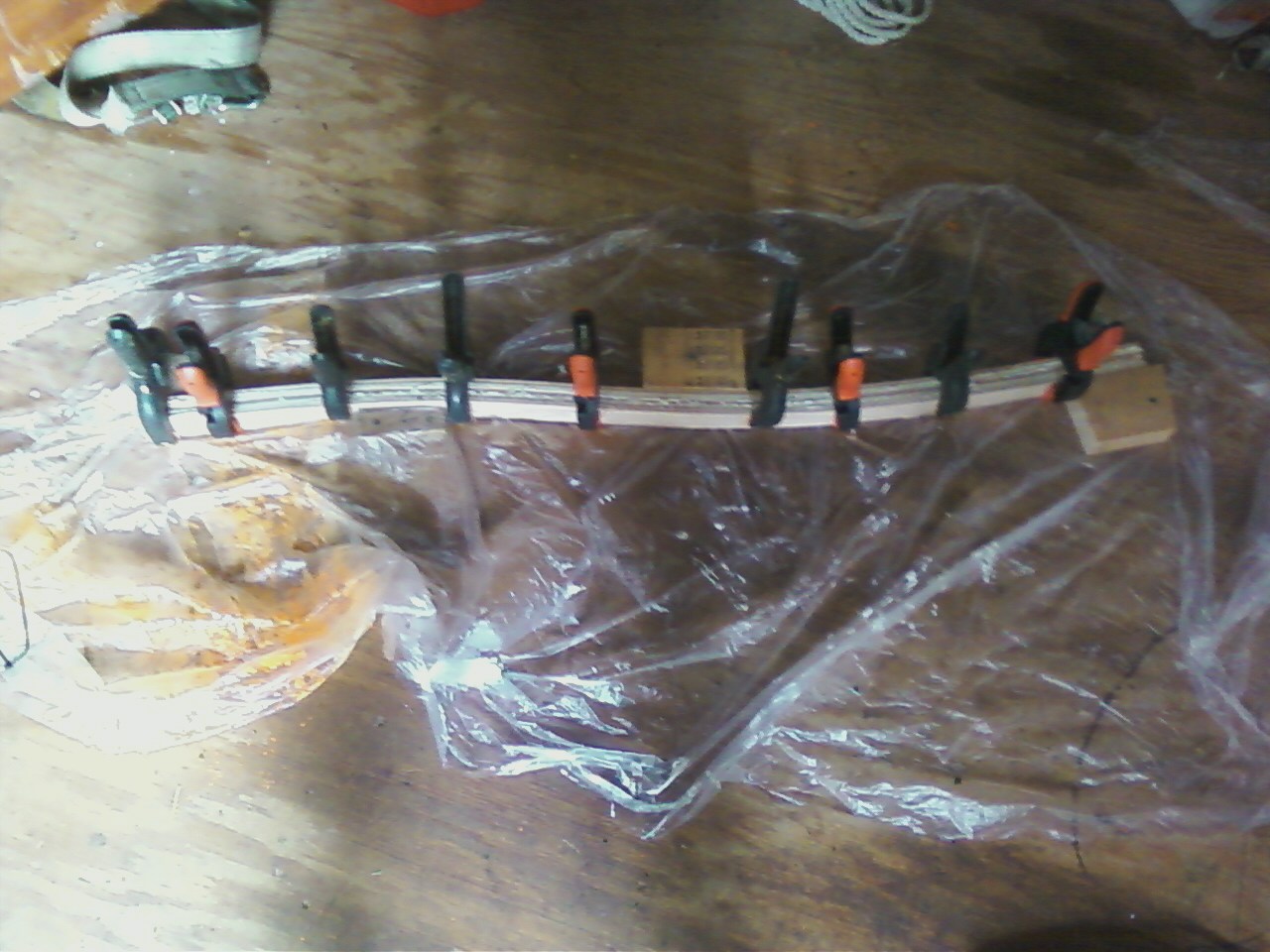

I have made a rudder before. Rudder Craft has quality products but the are pricey. If you want to make your own..go to Lowes over by the specialty wood and get a few strips of oak and pine.... or alternatively if you have a table saw you can rip a few 2x4s. If you have access to cedar, throw a few strips of cedar in to contrast the wood some. Make a jig. I screwed pieces of scrap wood to the floor of my shed for a jib but if you don't have a shed you can simply use a piece of plywood as your base.. Then glue, clamp, sand, varnish. It is fun and very satisfying. I've attached pics. Don't forget the plastic sheeting on the floor or your tiller will be glued to the floor... :)

To rgranger...... great looking new tiller. I drilled a tiller whose laminations had separated. As I epoxied the laminations back together I also added dowel sticks through the tiller from top to bottom to add to the holding power (and the esthetic appeal) of the tiller. I think I added 4 light colored dowels through the tiller. Satisfied with the new look.

I like the plastic wrap idea, I've used packing tape. However, you have to design your form around the need to wrap the object on all sides.
