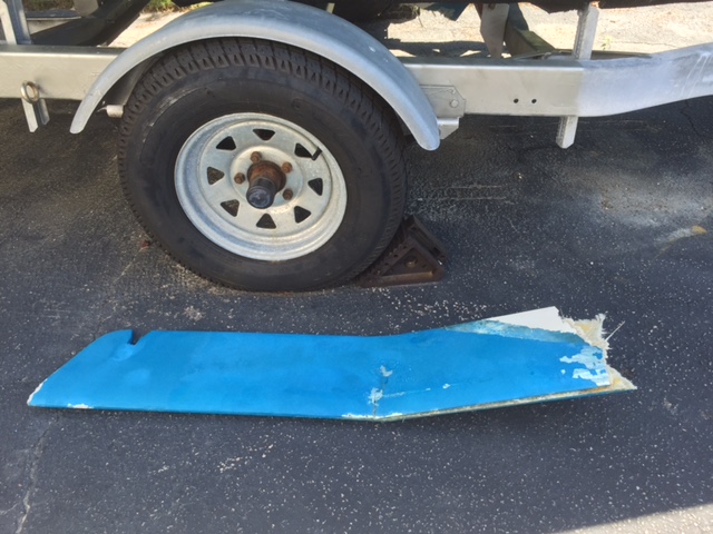

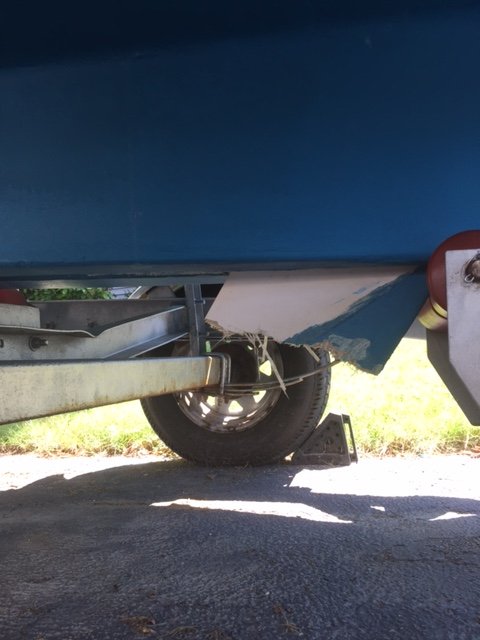

  • Loading onto the trailer in rough sea conditions the boat was bouncing in 1+ foot seas hitting the stern...

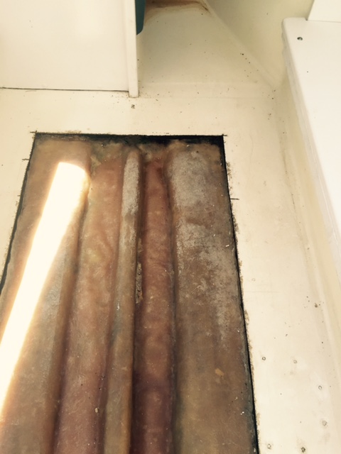

  • The previous owner had broken the line to lift and cleat the swing keel and glassed over the bilge to minimize leaks...

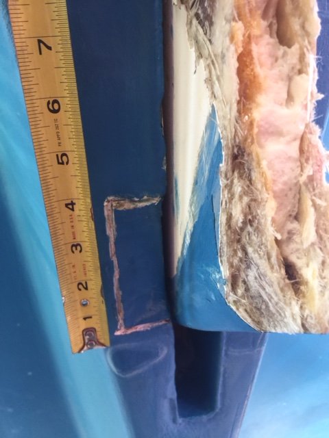

  • Is there any diagram anywhere to show me what is required to ACCESS and REMOVE the remaining portion of the swing keel still attached to the pivot?

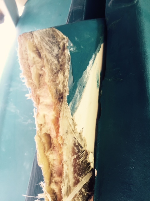

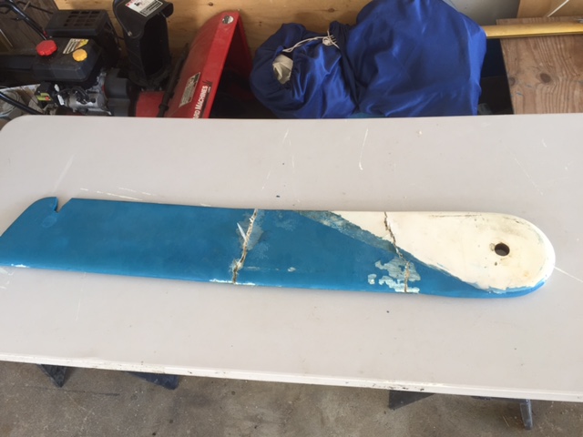

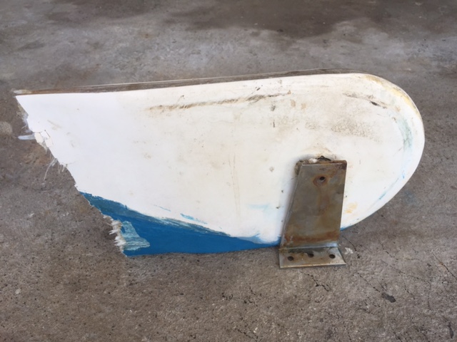

  • The keel snapped at approximately 3/4's of the length when I imagine it hit bottom as we were loading the boat.
  • I have the broken segment in fair condition...and believe it can be re-glassed and re-joined to the 1/4 segment still lodged in the keel...if it can be removed.
  • Yes, I realized huge labor costs and repair, but without the swing keel...the boat maybe of no use to me or any future owner...
  • I'm willing to cut away any portion of the hull or keel to attempt the repair...but need a diagram and any advice you can offer...

That looks like a swing centerboard, luckily much lighter than a keel. It is probably held by two plates bolted up from the bottom near the forward end of the centerboard trunk. Those plates hold the pin up.
Jack the boat up and look under the trunk. There will probably be a plate on either side of the forward end. Each plate will probably have two screws. Looks like the pin may be in tact, as you broke the centerboard below the pin.
You can glass a new centerboard. You might even be able to buy one from a used-parts yard or a rudder manufacturer..
I don't think I would try to repair that one, but if you wanted to, I would try to mend the two halves. Maybe through-bolt a plate on either side that covers the break and about 50% of the remaining top and bottom pieces. I wouldn't feel great about it though.

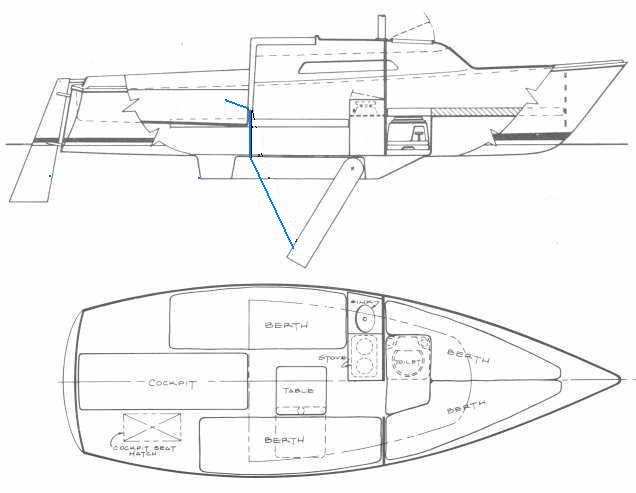

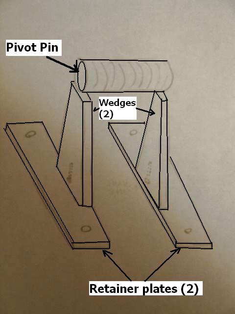

I think the 1975 models used what was to become the "standard" for later O'DAY K/CB designs as far as pivot pin mounting. See drawing below. Older models of the 20 had a different setup using a plastic pin inserted through one side of the keel.
I'd either buy a new CB ($$$ unfortunately) or build a new one based on the original, using epoxy and fiberglass covered marine plywood. Structural foam coring (Airex, Dyvinacel, etc) could be used instead of plywood and would be less prone to rot. foam will require a little more ballast weight to allow the CB to sink as it is lowered, but should still weigh about same as original CB.

"swing centerboard"! I stand corrected! Thanks to all who have offered suggestions and advice! The diagrams are particularly helpful! Sunbird22358 you have provided a lot of information and have me on the road to restoration now! I feel confident I can get/make repairs and not have to scrap this boat! I will take and post pics of the repairs as I complete the steps... I LOVE this FORUM!

Is that broken on two places? It will of course be possible to make it one piece again, but I'd be worried about it ever having the same strength and the required resistance to loading. D&R sells a new one for $550 + packing+ship? That's the deal of the century.

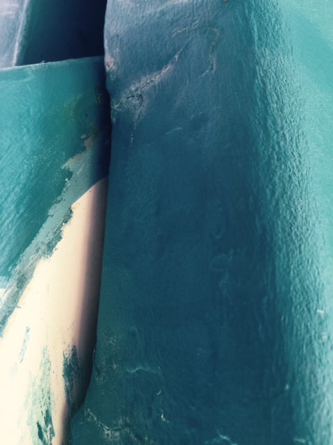

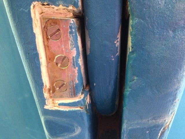

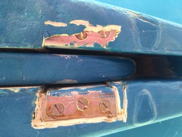

Thanks JackDaw! Yes, 2 places... Today, trying to see if I can chisel out old paint/epoxy layer that I assume is covering the "retainer plates" and screws in the keel which holds the pivot in place. If I can access the plates and screws, I am wondering if the "wedges" are epoxied into place? Again, tricky business trying to remove these. If successful removing, then I will attempt to rejoin the 2 pieces of the broken "center board" after removing several layers of fiberglass. I plan to attempt to rejoin the pieces with "stainless steel" rods, bolts and screws...then re-glass the pieces. To give lateral strength, I was going to use several old battens I have see if I can route a channel into the glass and epoxy those in? AGAIN, thanks for ALL the advice and TIPS in this forum! I will be posting pics with updates of the repair process.
Nov 8, 2010
11,386
No just the plates normally tricky to get out. The wedges are lightly tolerance-fit into place and are designed to come out. Made of delrin, they are pretty much impervious to environmental effects and will fall out under the weight of the remainder of the centerboard.

I read that people replacing the wedges often glue them in with some 3M 4000 or 4200. If this is true, you may need to push a thin putty knife blade between the wedge and the centerboard trunk sides to cut them out.
I think there are plenty of posts on removing and replacing the pivot and wedges if you do a search. I'm sure I've seen pictures of the process, probably from old Joe Alvez's photo album. Look for posts from Trinkka to get to his profile and photos.

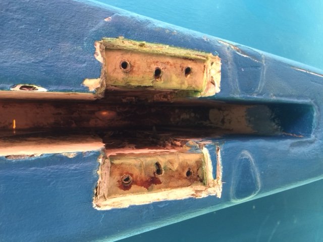

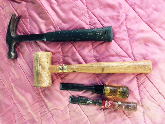

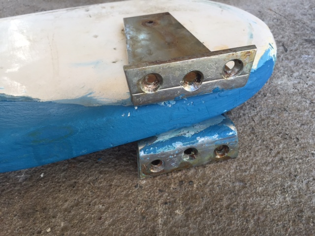

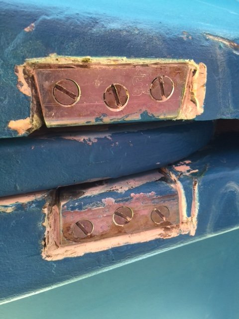

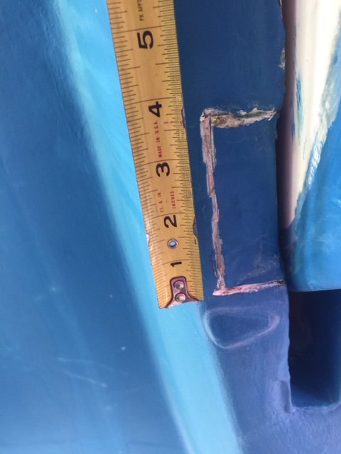

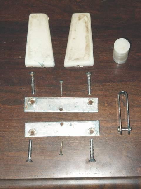

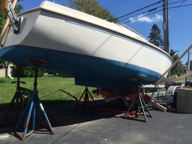

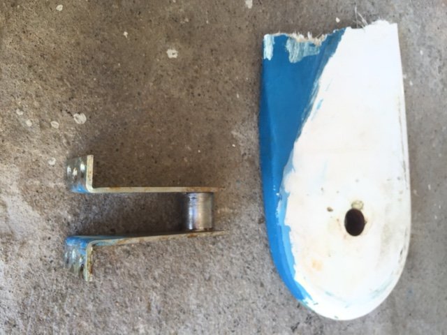

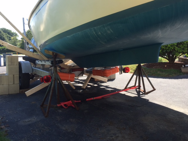

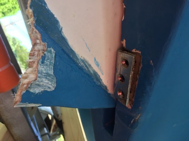

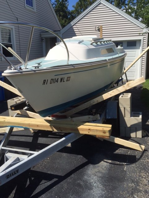

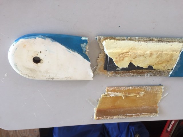

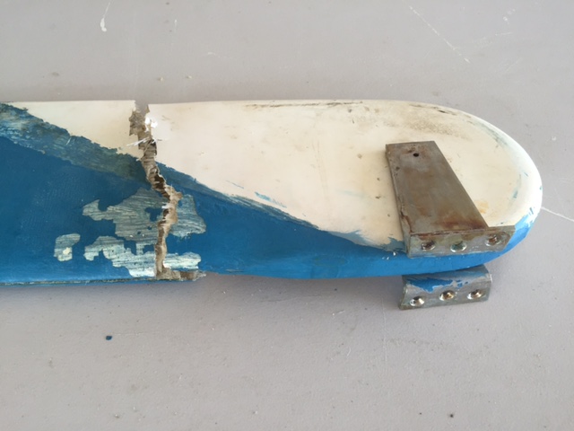

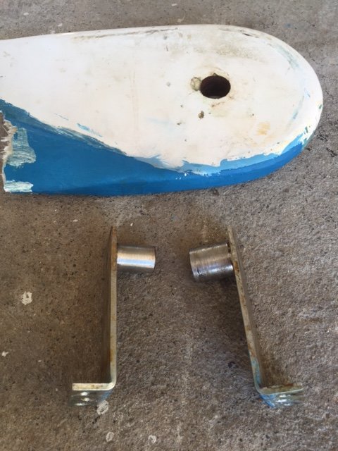

Without your diagram and pictures this never would have been possible! I used jack stands to lift the boat on the trailer and place the BOW on (2) 4 x 4 beams supported by 4 cinderblocks. With jackstands under the stern, I was able to slide the boat BACKWARDS on the trailer to get full access to the keel and centerboard.
I then raised the stern about 5 feet to get maximum exposure to easily access the retainer plates holding the centerboard in place. Using a small chisel and hammer, I removed a layer of epoxy or possibly "MarineTex" which had covered the plates. Once the plates were exposed, I was able to UNSCREW the 3 stainless wood screws holding them in place.
I was surprised to find all one piece stainless retainer plates (plus wedge and pivot) holding the centerboard in place. ***See pictures - Now on to seeing if repair of the centerboard is possible...
AHA! Now I know what all the manuals are talking about when they mentioned "a Stainless-steel CB hanger assembly"!! That setup pre-dates the SS plates/wedges/pin version. I'd like to thank you for YOUR pictures as well, as now I better understand what didn't make sense before! I'll save those pics for future reference, THANKS!
