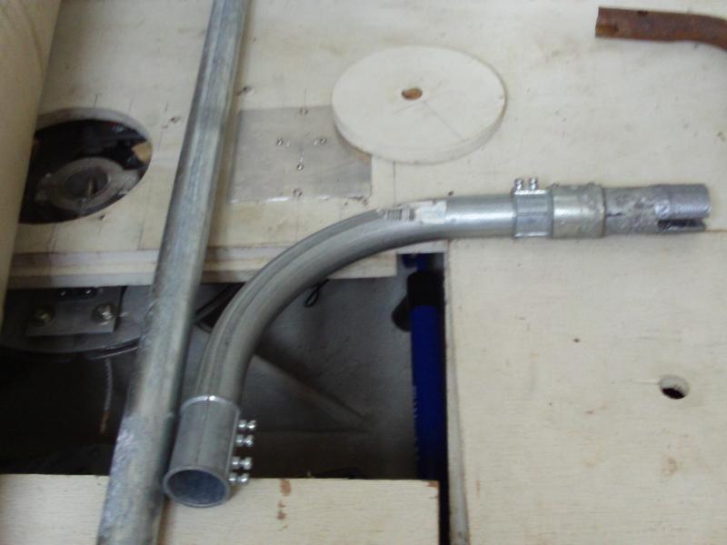

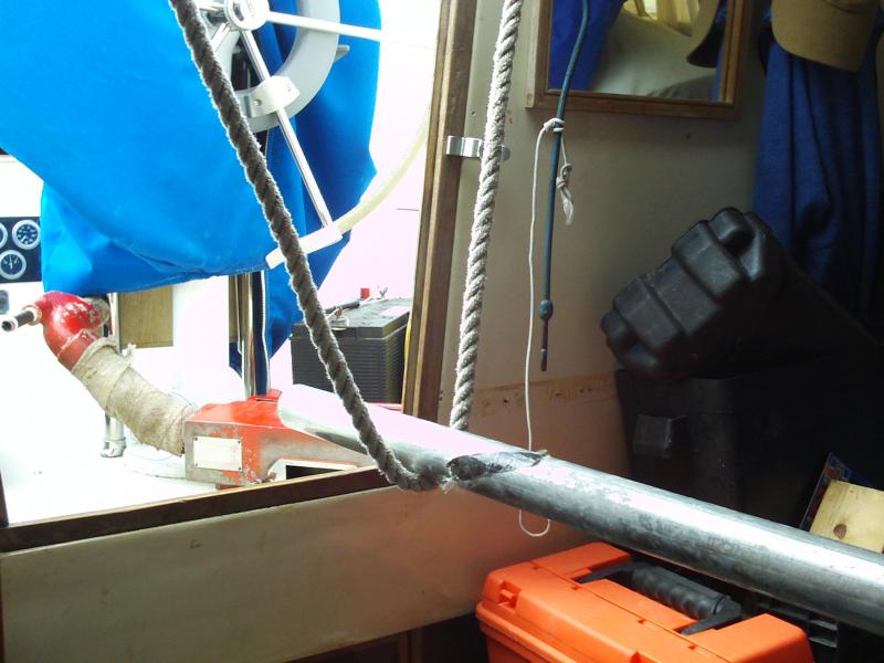

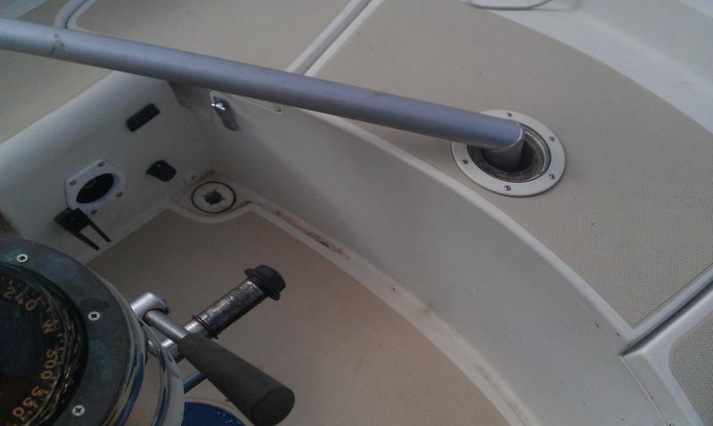

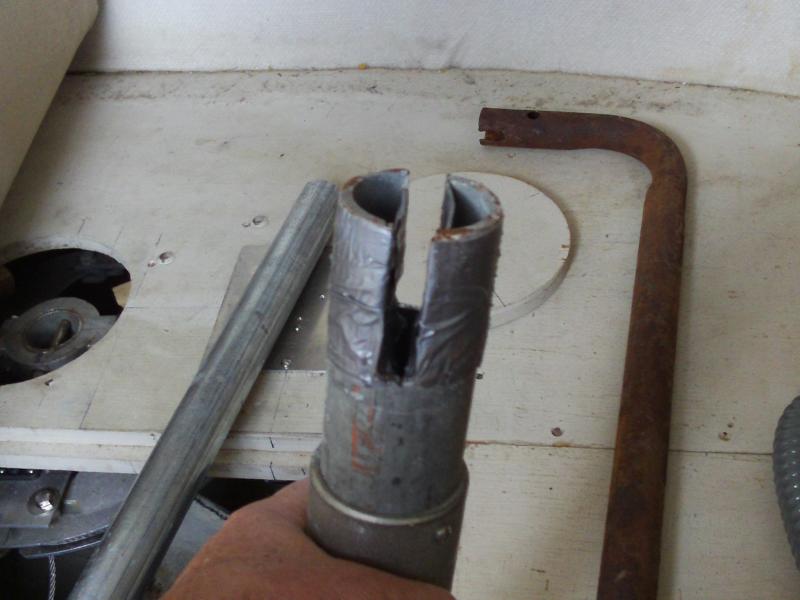

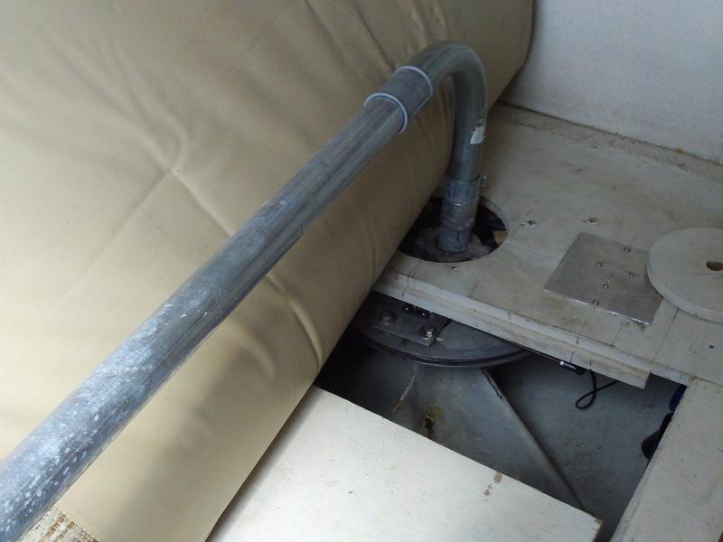

I have a center cockpit model and the steering quadrant is under the aft bed so the emergency tiller that I found in the boat looked like an exhaust tail pipe off a car but you would need two people.....one to steer and one at the helm to give directions (I could just imagine how that would go with my wife :cussing: ) so I being in the electrical business got me some conduit and couplings and modified it to fit and came up with system that one person could operate, I never tried it but it'll go on my list this season just to make sure

Think about someone below (wife) and you want to turn to port she has to push the rudder to starboard......so do you do the thinking for her or let her do the thinking....NOT, I'll take my chances on my one man system and when I test it if there's a problem we'll figure out a solution

Great pictures for the center cockpit configuration. This is the only way to go if you single sail.
