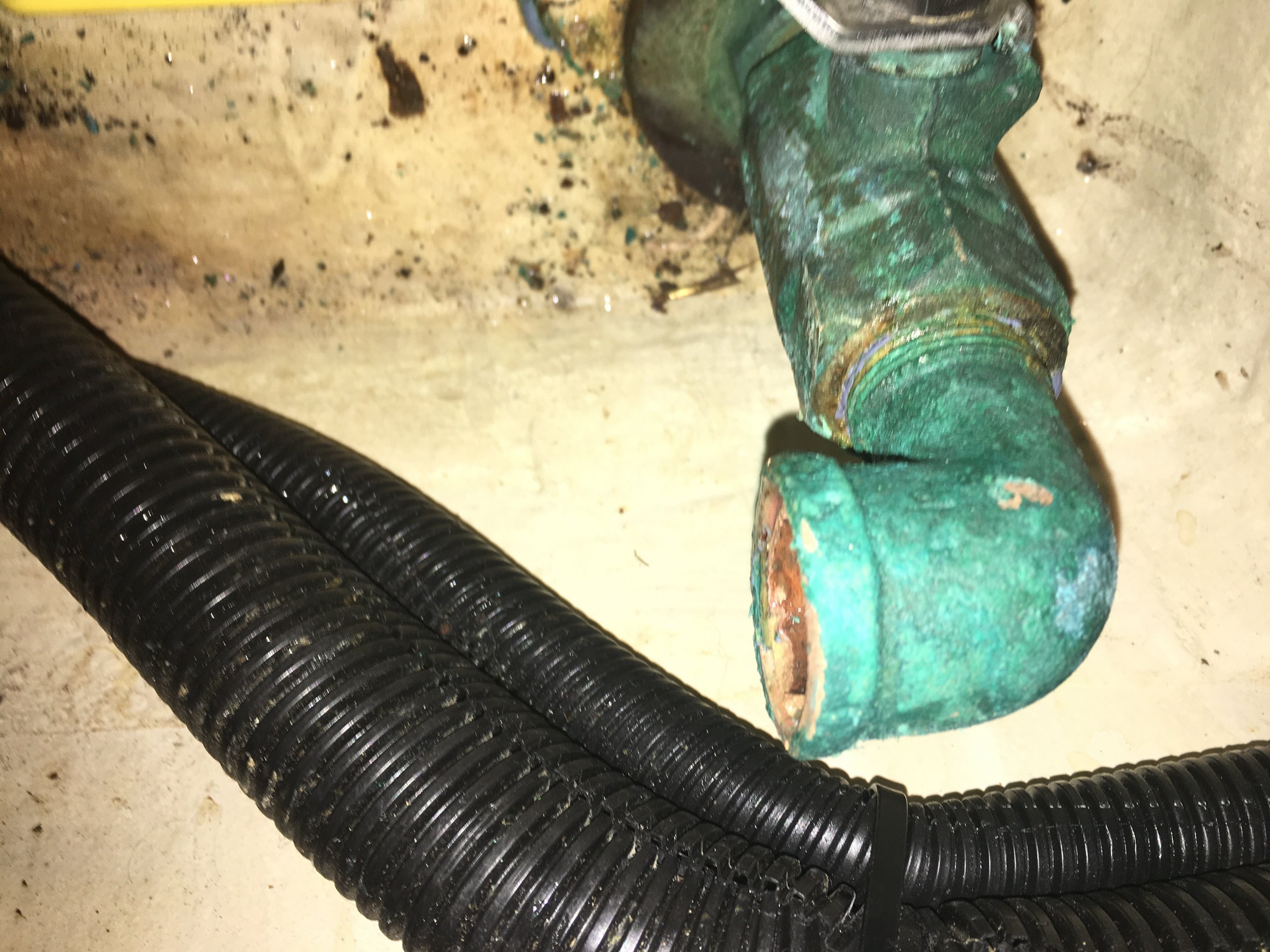

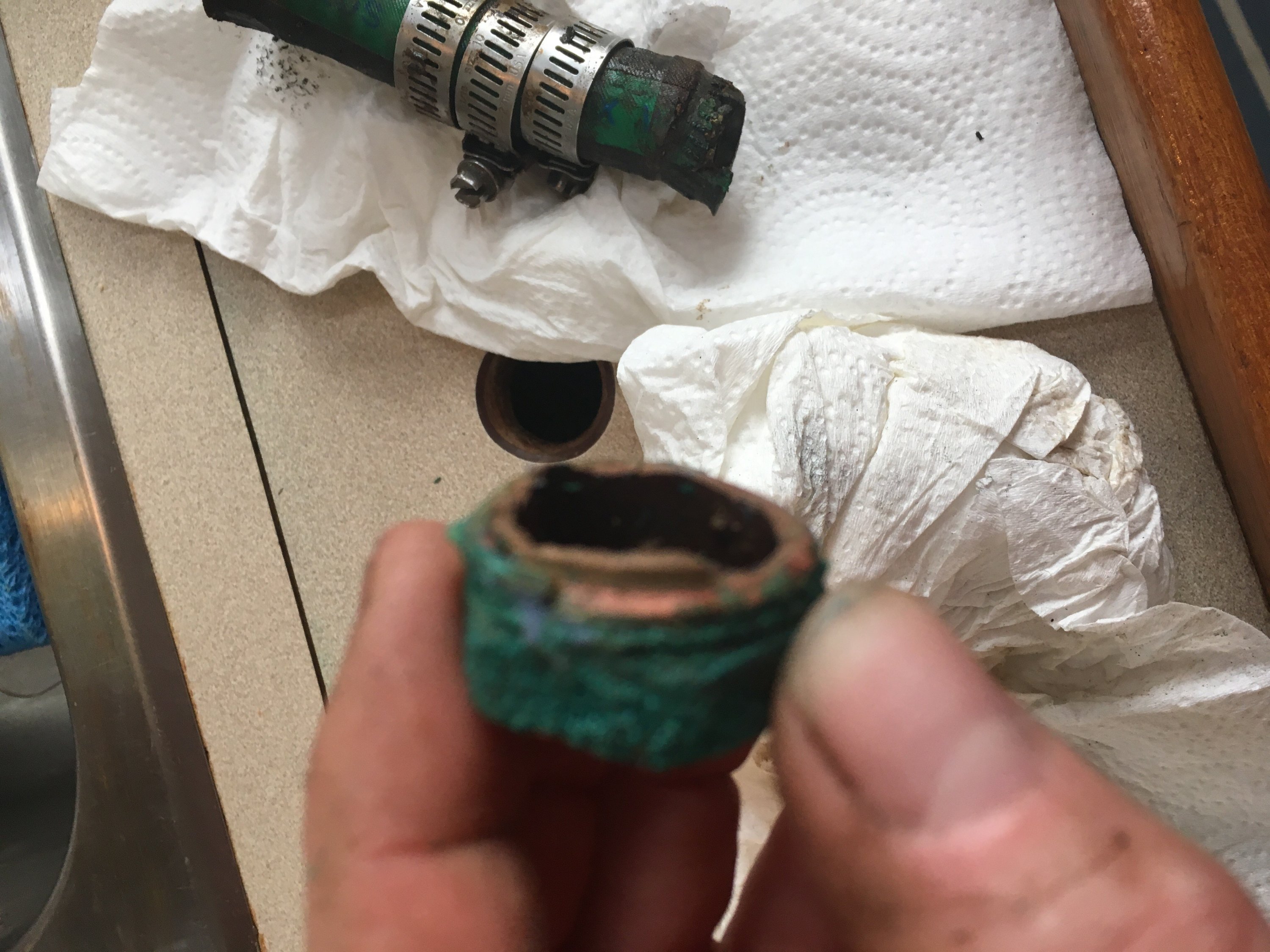

I went down to the boat to diagnose an overheating problem. I started at the seawater intake. I started to take off the hose to check for a blockage and the fitting broke. It was heavily corroded. See the attached pictures. My question is can this be repaired in the water by replacing the top part of the fitting above the valve, or does the boat need to be hauled to replace the seacock?

Yes just replace the elbow fitting. Make sure metals and threads match.
Unless the corrosion has infiltrated the valve as well, in which case it will need replacing. Out of the water of course. Possibly the thru hull too.
If you torque the bad fitting, and snap off the valve, you're in a world of hurt. Or water. Have a plug standing by. Or better, have a professional inspect it.
BY THE WAY: Is that really a seacock? Looks like a gate valve. If it's a gate valve, it does not meet ABYC standards, and is dangerous as a below-waterline fitting. Haul the boat and replace the whole thing with approved equipment.
Edit: what was attached to that fitting. The hose?
The more I look at your pics, the fishier it seems.
Talk to the yard.

Thanks, Skipper. It is a seacock. The upper part you see in my hand was connected to the seacock, the lower portion was connected to the hose. When I took the hose off the pipe the hose was on snapped off. When I tried to take off the fitting (hoping I could just replace the pipe) the whole thing just crumbled off. I am grateful this happened because the connection was prone to fail any time.
Because of the potential for disaster I am going to have a professional do the work. But would like to avoid a tow and haul.
