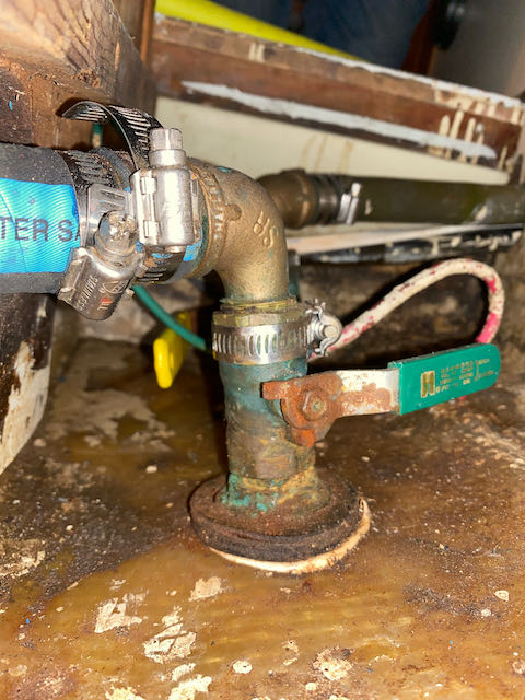

So I was told all the thru hulls of this boat were replaced early last year.

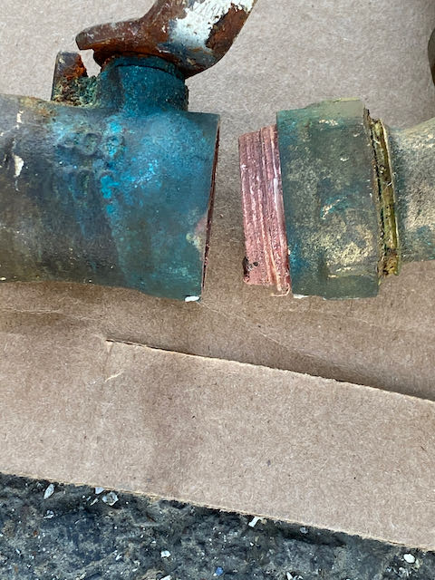

That is quite likely. If you look towards the right hand rear of the valve (in your photo) it appears to be shiny brass. This also indicates that the cause of the visible corrosion is from a leak from above.
Why the ball chose to chose to freeze in place is anyone's guess.
23,132

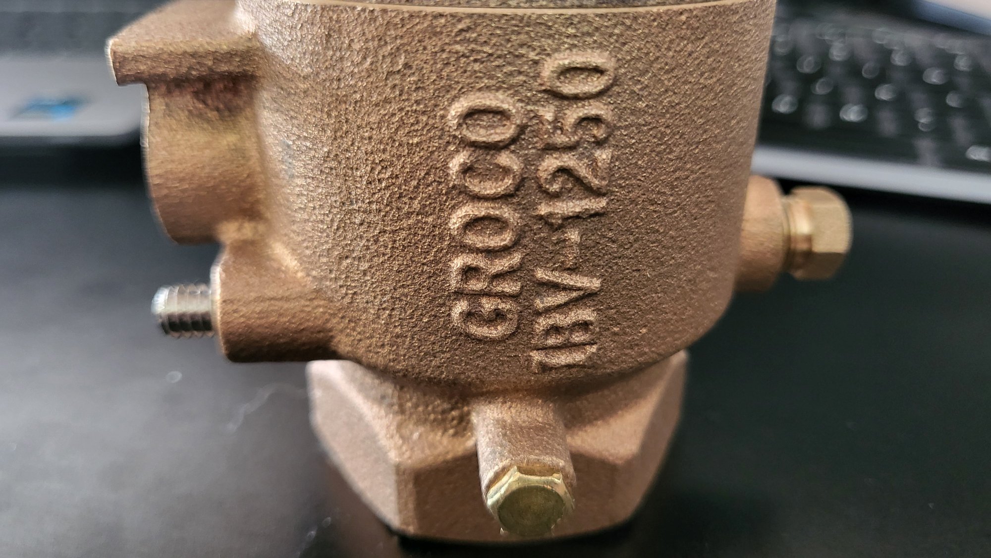

First that "exploded view" is not for the valve you have there.
Here is the literature and view for the IBV valve.
Your blue/green patina is from leaking hose not just general moist conditions in your bilge.
While you might be able to remove and reinstall the valve, you will be getting a rush of water that freaks out most boat owners. Sure you can stuff a rag in the hole, like they did on submarines or in war time boats, but do you really want to go through that trouble. What if that white sealant used on the valve is 5200, and when you try to turn the valve you also turn the thru hull breaking the seal between the thru hull and the fiberglass hull, worse what if the valve breaks off in your hand? Now your faced with an emergency in the water.
For a professional marine mechanic who has face these situations perhaps you can do it in the water. It is a real challenging issue for a DIY boat owner. If I was faced with the situation and not able to have the boat pulled from the water, I would careen the boat on a near by beach at high tide. Do the repair and look to float free and happy on the next high tide. Now days we have these magical lifts that will pull the boat in the evening. Let the boat hang in the slings. The boat owner jumps aboard does the repair. The caulk sets over night, and the boat is splashed first thing next morning.

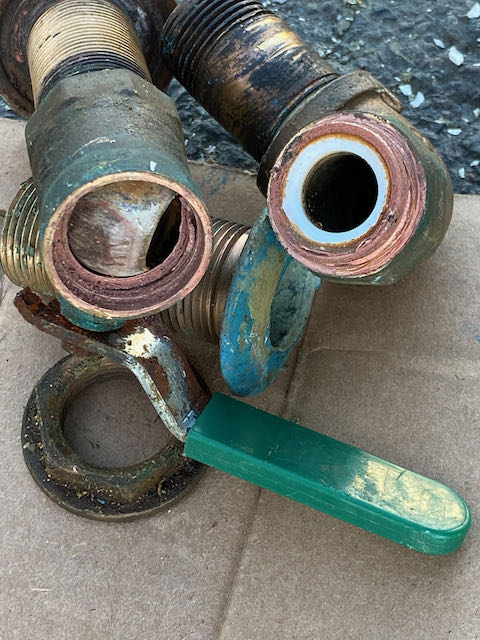

Here is what it looks like when an inline valve comes apart in your hand as you try to remove it from the thru hull.
Note this valve was working. I just became uncomfortable with the unknown age and the rust on the handle.

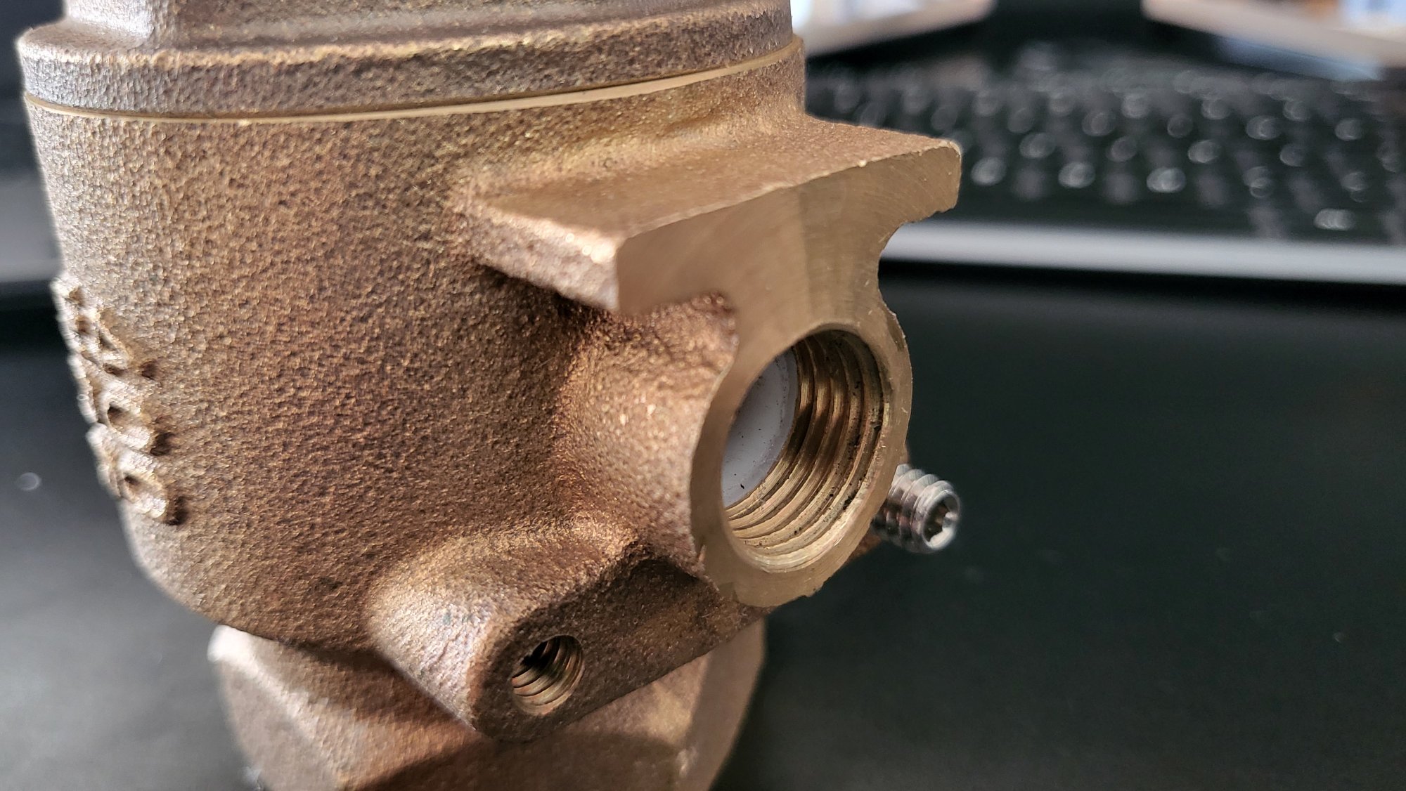

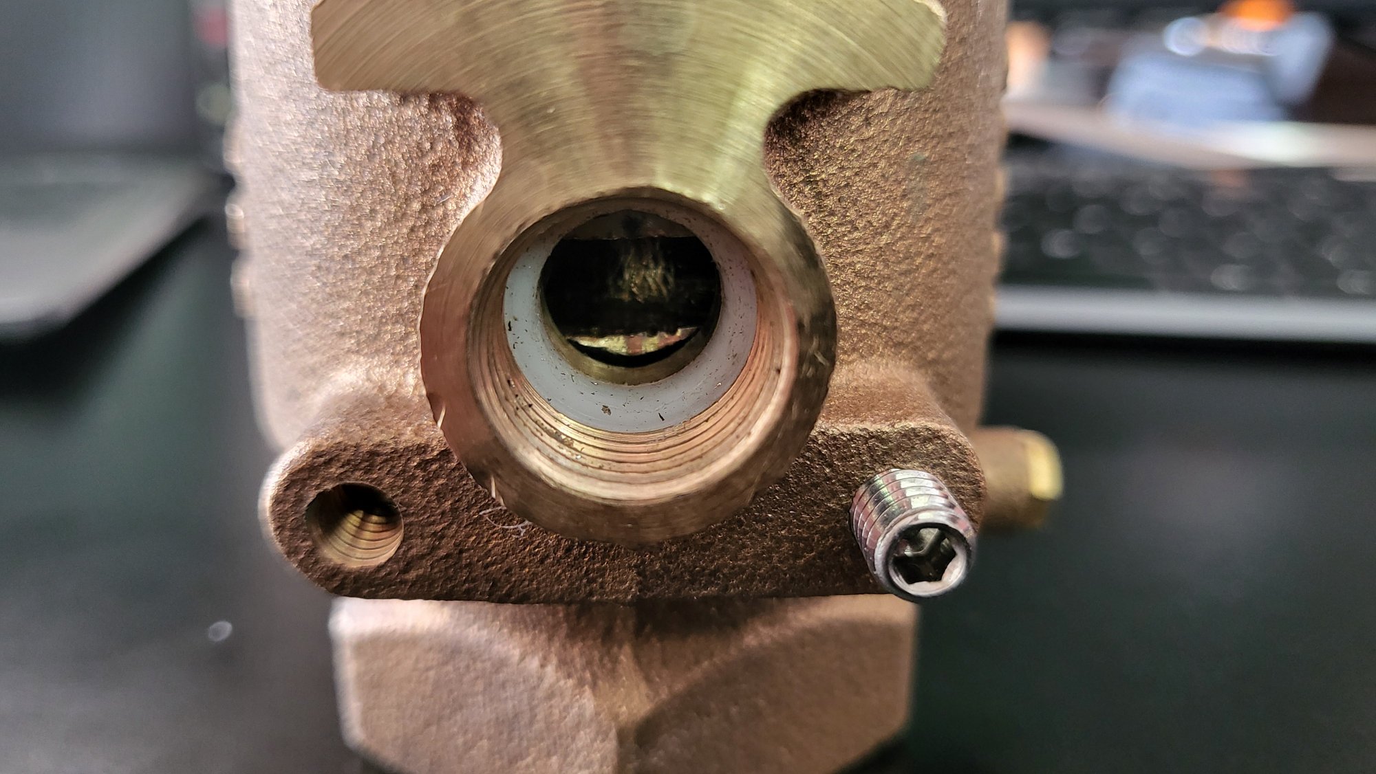

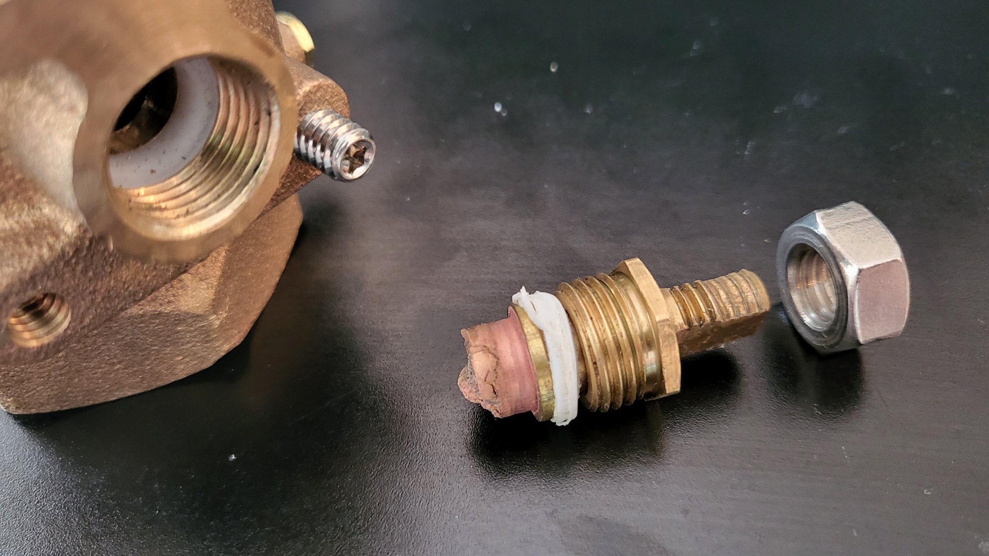

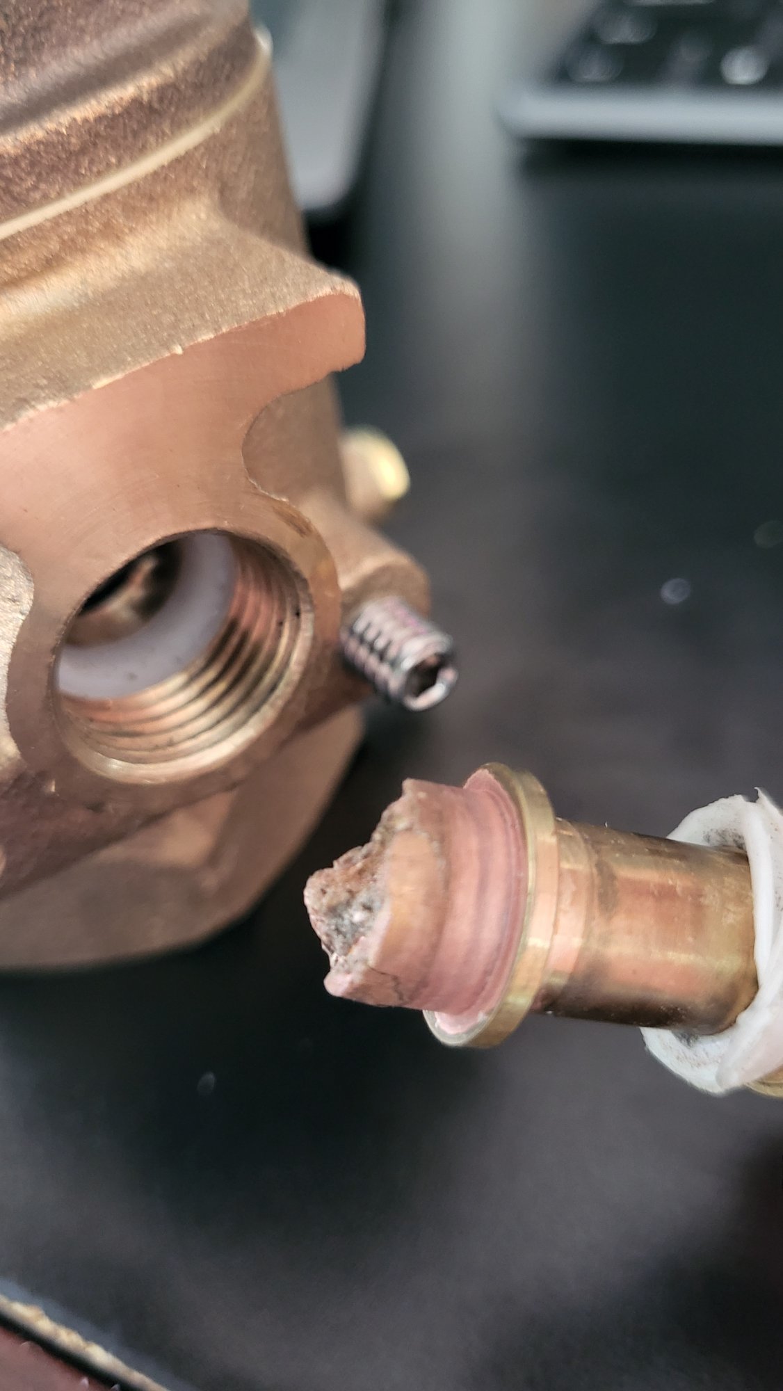

I had a similar problem with the same valve, in my case with an almost new valve, the driver failed and the handle would rotate without operating the valve. It looks like somebody made a mistake at Groco or a supplier and they used brass instead of bronze for some of them and obviously brass quickly corrodes in salt water.
Groco provided me a new valve and advised it is not serviceable but..... it is!
Hauling my boat would have costed a lot of money and inconvenience so I just ordered the same valve, and replaced the driver by doing the following
1)Unscrew the nut that holds the handle
2)Remove the second nut that holds the driver
3)Screw back the first nut to use it as a pry point
4) Pry out the driver while occasionally unscrewing it (the Teflon seal is the only thing holding it)
Then reinstall!
It has two Teflon seals and only the external one gets slightly damaged, but in my experience it worked when I reinstalled it, no leaks. Worst case you can find a matching o-ring or use some sealing tape around the seal. (Even without the second seal it would barely leak)
