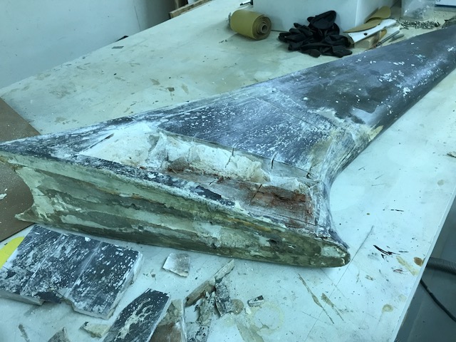

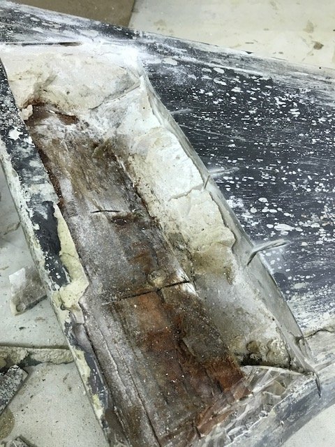

I have not seen a post with a picture of what is inside the skeg so I pulled mine off and cut it open. I just bought a 1980 Cherubini that had every thru-hull gooped up with silicone. It had bent shaft and no packing left in it, loose skeg and bad mast step. There is a large block of wet wood in the skeg that the lag bolts are supposed to bite into. It is set in place with some type of mortar like resin covered with a thin layer of fiberglass. I am thinking I will install a large slab of aluminum then drill it and tap threads and use some stainless bolts and toss the lag bolts for a solid long lasting fix.....
Aug 22, 2019
1
Hunter 30 Richmond Hill Ga
Aiy-yi-yi-yi-yi! You're lucky the whole shootin' match didn't fall off!
Come to think of it, what IS holding it up? --beats me!
You say there is no metal bar stock along the after edge of the skeg? That definitely sounds like a dodgy PO repair. Hunter would have done it right if for no other reason than that my dad was there. They were sued over a H30's rudder breaking off and 'causing' 3 deaths, a case that was dismissed as pilot error; but their fix (if by 1977 it had not already begun on the production floor) would have been to include the metal bar stock in the skeg. In fact, by design, the whole skeg is really just a fiberglass, foam-filled fairing around the stainless-steel structure of the mounting flange, stiffening bar, and heel blade.
Cheapest fix:
Repair the 'glass structure as-is and risk the same thing happening again. Good luck with that.
Better fix:
The whole rudder and skeg assembly needs to be removed (lifting the boat or digging a hole in the dirt to let the rudder shaft be lowered). The skeg won't come off easily-- it's bolted on inside the 'glass. I did this very same job on a Raider at CY-- they're done the same way. You'll need to have a stainless-steel framework made and set into the existing skeg. I can get you some drawings to facilitate this (these are easier to come by than the pretty sail plans, people; because resolution doesn't count. I have them right now in my parlor). The strengthened skeg needs to be refit to the rudder and new 'glass done to the bottom (which is the easy part). There is a trick to reassembly (bolting on the skeg); but it can be done on an otherwise finished boat.
Needless to say this is a good time to consider new steering cables, refurbing the quadrant (actually a disc), and everything else, because you'll have it all apart. Again, I did this on the R33 and it was less hassle than it promised to be at first.
Consider also pinning the rudder pintle, below the skeg's blade, to keep it from bouncing up... which is much more like what I would have expected to happen in such a case. In fact I wonder if that is not precisely what happened, and somehow the rudder came down, its pintle missed the hole, and the skeg worked loose and broke due to misalignment. The 'glass would let go before the rudder shaft yielded to it. Did you ever experience grinding or tightness in the steering?
If you're anywhere near me I'll be happy to come have a look at it.
I am still completely in a daze how it took this kind of hit (or corrosion) without the rudder becoming mangled or lost completely. Sheesh.

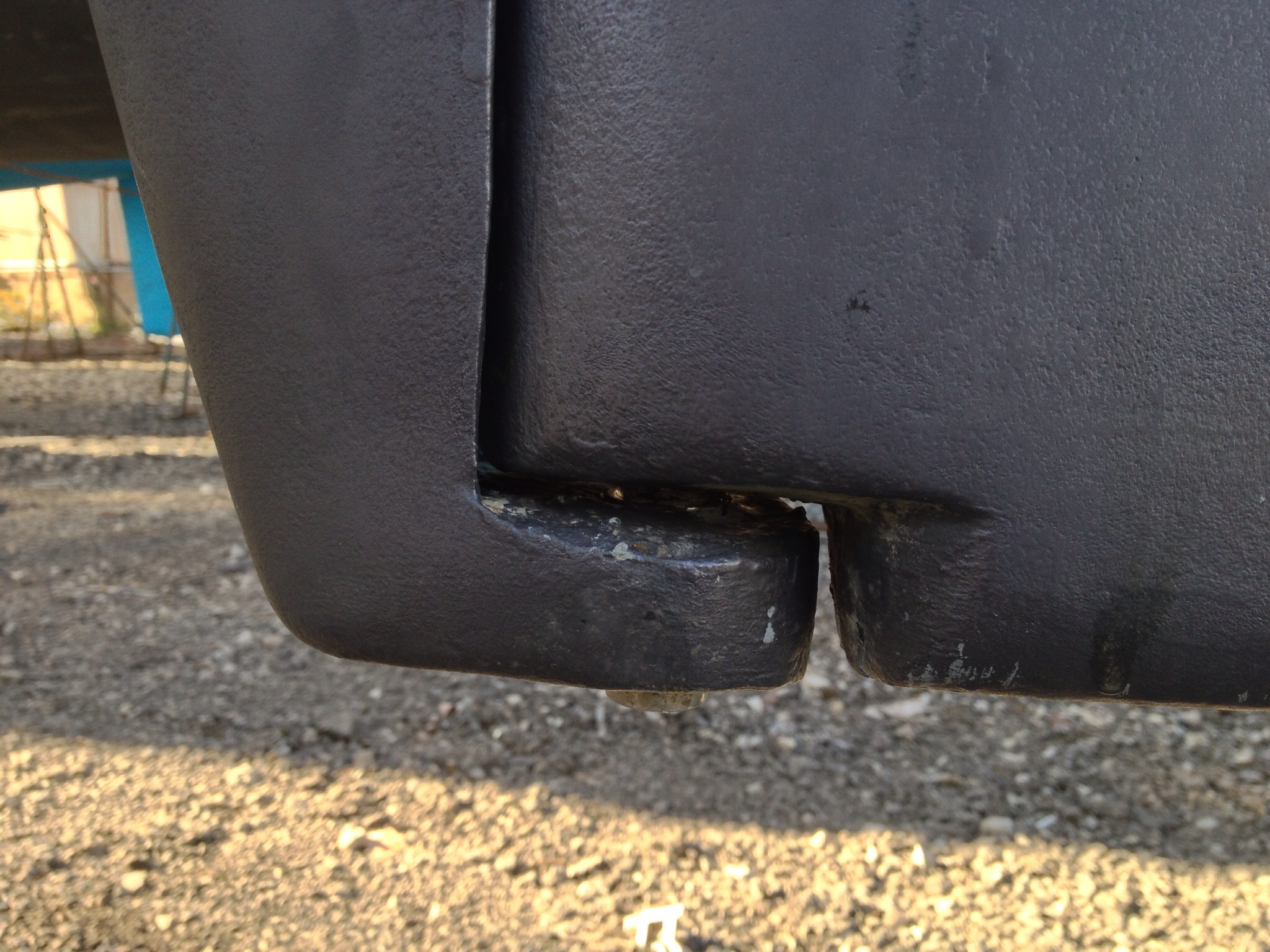

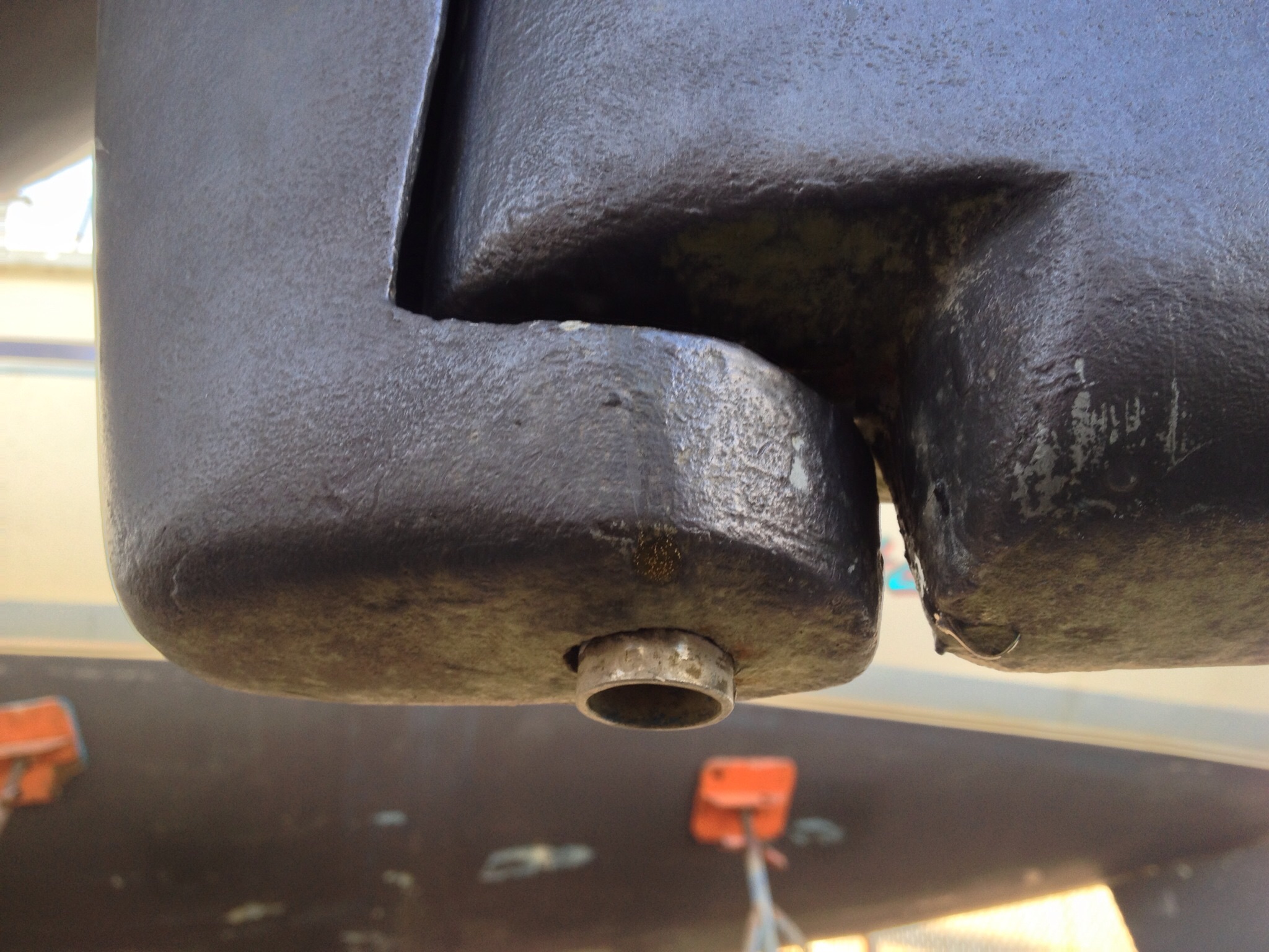

Thanks for all of the great inights in this thread! On my 1976 Hunter 30, I recently had a hard grounding on a breaker headed out to sea in heavy surf. My rudder shaft is bent and will be replaced. I’m missing a chunk of my skeg, it sheared off in the middle of the thru hole for the metal shoe and the shoe is long gone. See pic for the ‘before’ state. I’m interested in following your ‘better fix’ solution and creating a metal framework. Could you help me with the design details needed for this repair? Thanks so much for your help!
Jeff

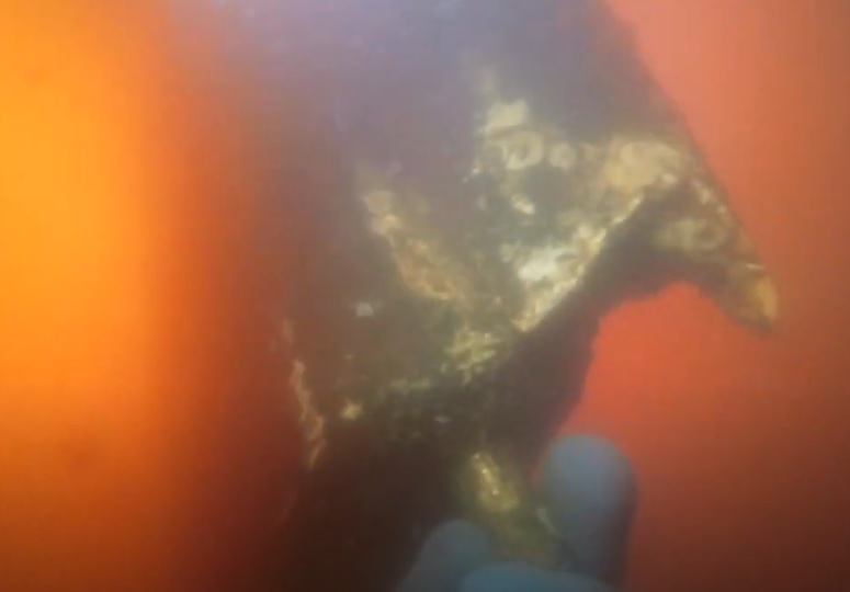

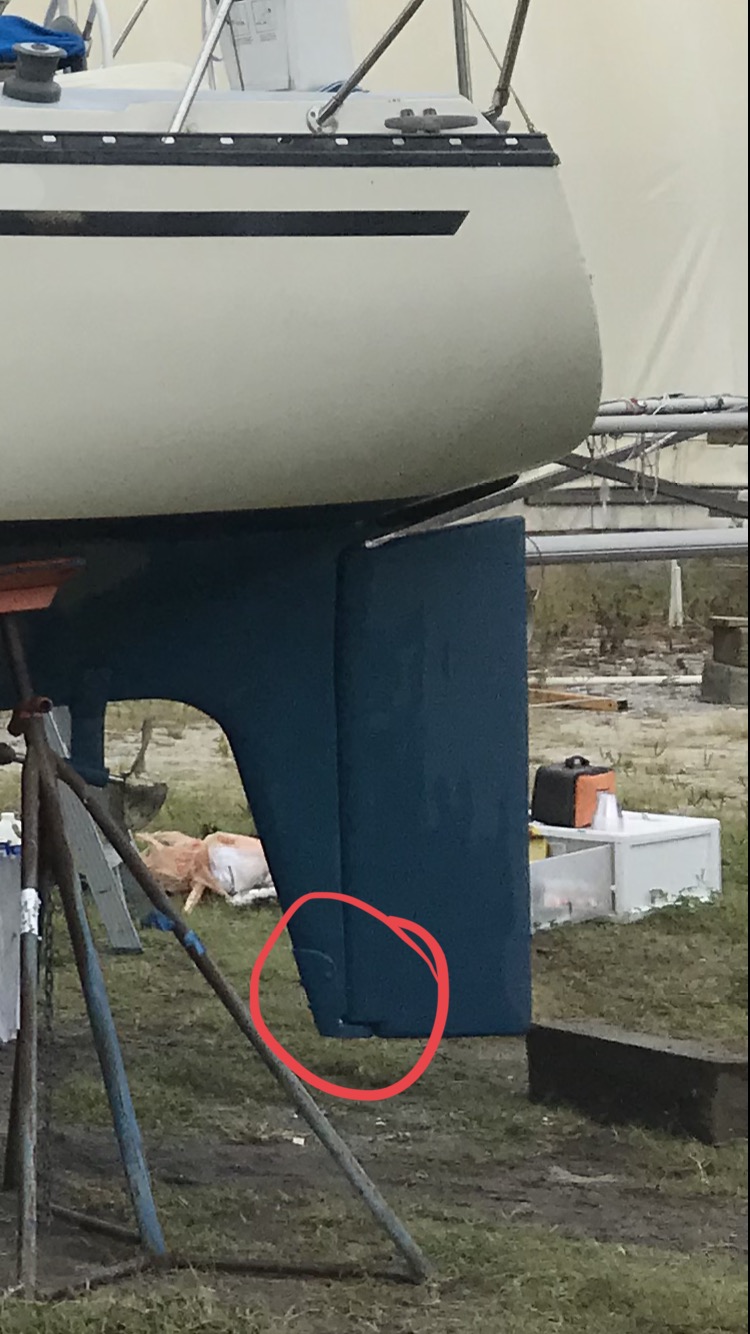

I had a diver look at the bottom of my boat for a cleaning the other day and he said there is a portion of the rudder missing. He did take a video while down there and I did a screen capture. It appears to be the bottom of the skeg in front of the rudder (as has been mentioned in this post by others). The boat is a '78 Hunter 30 that is in Jacksonville, FL. I just purchased it and plan to motor is approximately 200 NM down the ICW to my home. Based on this photo I am providing, does the group thing that is an okay thing to do or does this need to be hauled out ASAP?
My original plan was to haul out in the fall when there is less rain in FL and do a full bottom job on it. The last time this boat was hauled out of the water was in fall of 2017 by 2 previous owners ago. I know that because there is video of the boat on the hard at that time and the last PO never hauled it out and he has owned the boat for 2 years. I have done short motors in the boat and felt no problems with steering or handling. I am just wondering if I can hold of on taking care of this until I do my planned haul out?

Thanks kappykaplan. Going to start looking at what the haul out costs might be.
On the 'Hunter Owners Group" on Facebook, I did see a guy who made his own repair to the skeg using sheet metal, 5200, stainless bolts, all coated with anti-foul as well. Looked like a pretty good job and close to the original functional design as well.
