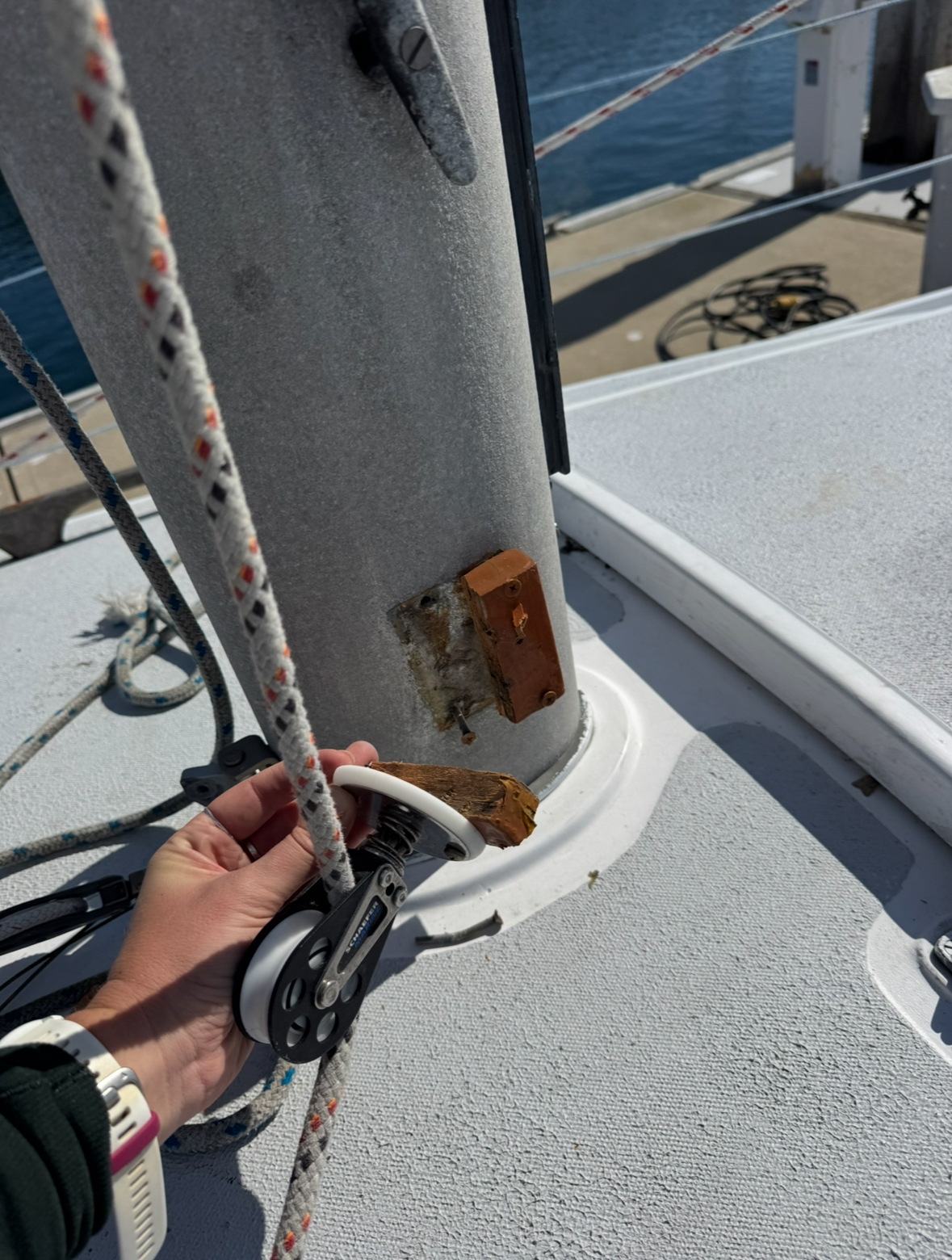

Previous owner of my boat seems to have attached two wooden blocks to lead the halyard from the mast to the deck with a turning block. The only problem is that the wooden block was only screwed into the mast and now it’s corroded and popped off. I’m looking for alternatives that don’t include replacing the block and thinking about instead attaching something to the deck at the base of the mast. I wish I had an already installed base plate or something like that any alternatives you guys can think of would be appreciated. Cal 2-27, so it’s not a super tiny boat, and this solution will be under a decent amount of strain.

First, the failure mode. The top left screw (can't see type) pulled out of the mast, followed by the wood splitting because the block is attached to the wood and not the mast. Then the block split completely, pulling the screws out of the wood. So Trex is not going to work (weaker than the wood). Also, since one of the screws pulled out of the mast, they need to remove the rest of them and drill/tap new holes.
Many possible solutions. Better materials. More fasteners. Thinner so less leverage (bolt pulled out, not sheered, hole not deformed). Corrosion. I would machine a sheet of ~ 1/2-inch G10 or aluminum to match the curve, then attached with 4 new machine screws, plus the fitting screws would thread through the sheet and the mast. The curve is small and could probably be accurately duplicated with careful use of the edge of a disk sander. Make a template and transfer. Finally, a good anti-seize and sealant.

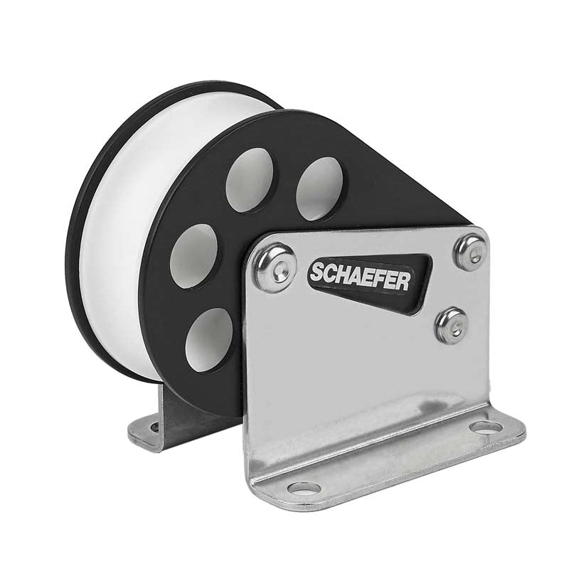

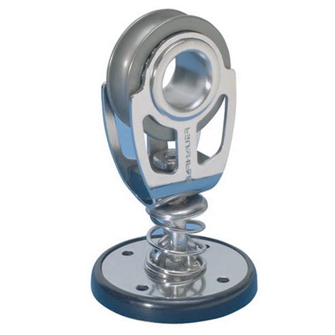

For a deck mount, you can use a stand up block or a deck turning block. A stand up block accommodates a variety of angles. The turning block must be carefully aligned. They would need backing plates.
The block in your picture is actually a stand up block intended for deck mounting.
PaulK
Dec 1, 2009
1,447
Sabre 402 Southport, CT
Good point. A cheek block mounted on the mast would still be the simpler (and dryer) solution.
